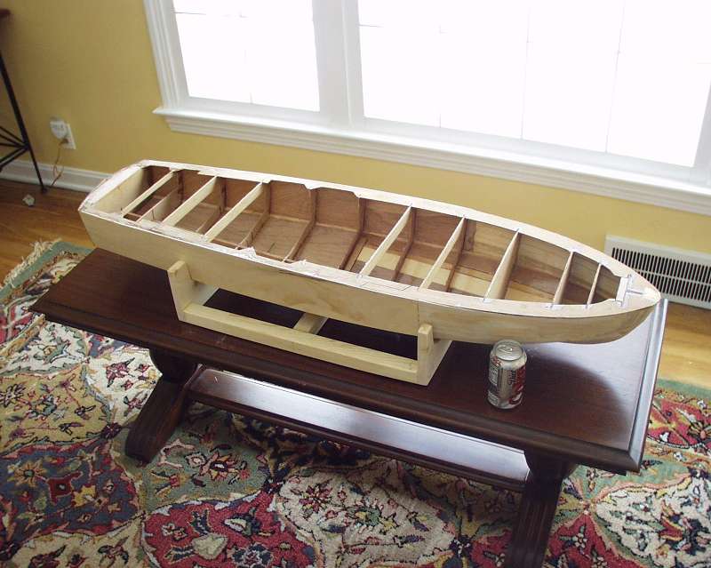

Got this kit from the wife of a fellow in my flying club who had become too ill to do anything. He had apparently taken all the pieces out of the original diecut ply, but had not marked anything. There is one page plan but no instructions. Have framed up the formers, but it's slow going. Were there any instructions that came with these models? I have one 700BB motor and figured another would make a good powerplant. Also, where's a good place to get drive train, props etc.? Any other thoughts as to what kind of setup I need. I have sailboats and airplanes but this is my first pwered boat. Thanks, Bill S.

Dumas has power and drive line kits for the Dauntless which may be the simplest way of going about it. From seeing some of their drive line kits, I'm not sure you couldn't do 'better' with just a little judicious shopping around. You might also give 'Dumas' an email about plans. No idea if they would duplicate them for you, but it's worth a try.
