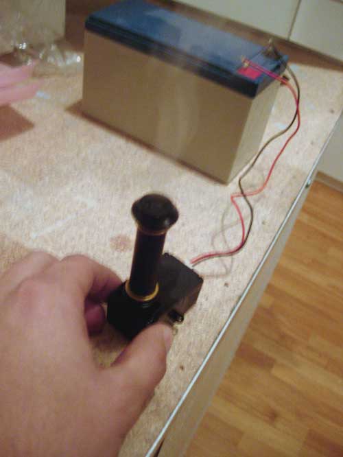

Old 11-11-2004 | 11:35 PM
Joined: Oct 2004
Posts: 52
From: 36 thousand feet
Default RE: Smoke screen generator
I have a few smoke generators. Unfortunately I do not know the brand name. They are new. Uses 8-12 volt DC. It is quite a small unit.. Probably 3" X 2" If you fill it with fluid it will probably last 10 min. I was going to put a switch on it and use it as I flip my switch on my transmitter. You can also extend the tank or add a bigger tank to it. It also has a buit in fan. Ill post some pics when I get a chance. There are no markings on it.
ID:	192320   Click image for larger version

Old 12-01-2004 | 08:09 AM
Joined: Nov 2004
Posts: 247
Received 25 Likes on 20 Posts
From: Temecula, CA
Don't waste your time or $ on those little oil burning smoke makers… you only get a wisp, and you won't even see it if the boat is moving.
The best I've seen is theatrical foggers… a glycol fluid is heated and blown with a fan. You can get some decent smoke, but nothing like the fog bank laid down by a PT's smoke generator. See my "fogger" in action:
Problems- it sucks amps, so if you're not carrying a heavy gel cell, fuhggitaboutit. Also, my home made unit has no safety- run out of fog juice, and it WILL burn. Don't ask.
Also, see an image of a PT smoke screen at:
[link=http://www.geocities.com/ptboatads/]Pats PT Ads[/link]
Pick "Elco", and scroll down to "Elco Smoke"
And see my PT-41 at:
[link=http://www.geocities.com/patspt41/]Pats PT-41[/link]
patmat

Old 01-03-2005 | 11:29 AM
Joined: Nov 2004
Posts: 247
From: Temecula, CA
I was inspired by the article at:
http://wmunderway.8m.com/cont/smoke/smoke.htm
I can't offer design specifics, but a few hints:
1. 12 or 6v works, either way you'll suck amps... but you do need to experiment with the length and gage of the nichrome heater wire... you want it glowing dull red in free air. Smaller gage needs less length to achieve this... but also has less hot surface area for smoke generation.
2. When the juice runs out in your reservoir, heat will build up quickly... enough to set a plastic tank on fire! (don't ask)
I want to design a thermal shutdown, but haven't yet. Best to use metal with insulation around, to save your boat.
3. Small computer fans are available for 5, 6, & 12v, check out www.jameco.com
Good luck!
Pat M
