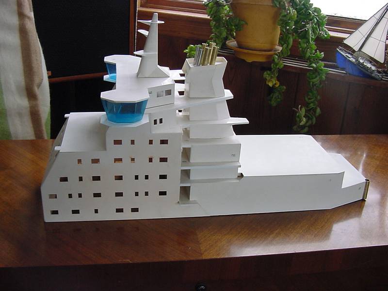

I purchased a graupner kontio ice breaker and got a great deal but the good deal was because the instructions are in german. I'm progressing with the build and have installed the drive system with rare variable pitch props but would like to have more knowledge before I start the super structure. Does any one have a idea where to get the english instructions.

Nice looking boat.

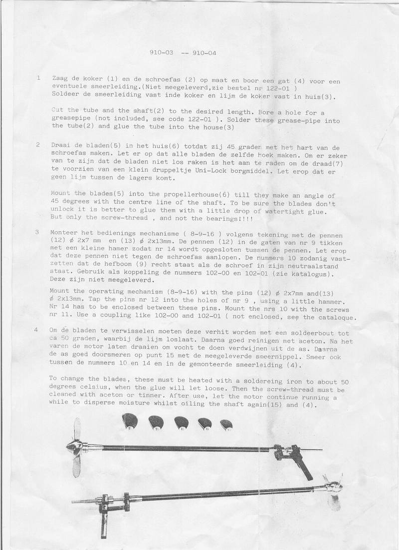

Nice props JMTW. Are they spring loaded in the bulb for forward thrust?
I am assuming that the servo does not act on the shaft unless you want to reverse thrust.
And that if you return the servo to forward thrust, the blades have to follow the shaft back somehow.
Wait if the shaft moves in and out of the propeller hub, why does the propeller not fall off..
Hmmm I'll have to think on that some more.

Umi, The shaft must have a linear gear on and the prop shafts have some sort of a bevel gear on them, when the shaft is at the center or neutral position there is no pitch to the blades, when the servo is moved forward it moves the shaft and the blades move to the positive 45 degrees and in turn when reversed the props go to the negative 45 degree, the blades are treaded and must be screwed into the hub. hope that make sence.
