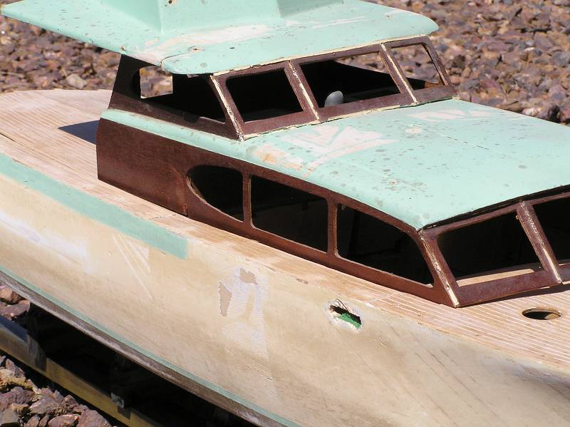

So. Hello, I am new here ; cause I got a boat for Christmas (lucky me). As you can see by my handle, I play trains mostly, live steam. Gauge 1, to be exact. I build and kit bash these models. But I do have a love for boats, so here I am.
Christmas brought me the Lackawanna since I just fell in love with it's lines. I really have not found it too hard to build except I find myself a little heavy handed; as I am more used to working in metal. I am at the point where I have just about completed the hull and will be starting on the superstructure. Here is my dilema: I would really like to steam power this tug and wondering if this would be a wise idea. The hull is vacumn formed plastic and so is a lot of the upper structure. I am already considering sheathing this area in brass and tossing the plastic away. If I figure out a way to funnel all my hot gases out the stacks (which will be brass!), I am hoping that it will hold up.
My question to you guys is am I being a bit foolish and will end up with a fused pile of boat at my first firing? Or should I just keep things electric and build a more substantial boat for steam?
Bob

It's horses for courses Bob, any degree of heat and plastic just don't get on, far better to look out for a kit specifically designed for steam power.

I think I'd have to agree with John. Plastic and steam aren't exactly the best of friends and I think there would have to be quite a bit of modification to your boat. Not impossible by any means, but certainly not simple or easy. The plastic superstructure wouldn't be my main consern, but removing the heat from the hull area would be a trick. Also, since I'm not familiar with the 'Lackawanna' kit, size mainly, is there room for a steam engine in it? [Not that familiar with steam engines either - lol.] Steam powered boats don't have to be huge, but they can't be too small due to the size of a steam engine. Have fun with it no matter what you end up doing!

Thanks for the prompt responses. As I was drifting off to sleep last night, an idea occured to me. (Can ya tell I am an obsessed modeler).
What if I fiberglass the interior of the hull? I mean cloth and everything. I already know that resin is compatable with the hull since one of the kit requirements was to do the seam between the hull halves. I was thinking this with a generous amount of lagging around the boiler and a channeling of hot gasses up the stack I may have a chance.
Replacing the sheathing on the upper decks is a no brainer for me. All the pieces are flat and will require just cutting and fitting.

Fibreglassing? Beats me, but it would certainly be 'better' than just plain plastic. The conducted heat from the firebox and the radiated heat from the boiler would be the 'biggies' I'd think. The only steam engine I've any experience with at all is a very simple one, firebox sits on a small block of wood, then the boiler on top of that. Tried making a plastic base (bad idea!) which didn't exactly work out. Didn't melt, but retaining pins got very loose, started to smell a bit. I'm not totally stupid so removed the plastic, put it back on the wooden block. The engine sits out in the open so didn't worry about the 'contained' heat in the hull.
Constructing a 'boiler room' may be an option. Contains the heat away from the hull, give it a vent through the stack (also an air intake). Depending on the engine, I'd also think about a bilge pump. I've found that there's a lot of steam/water blow-by from my oscilating engine (more common knowledge that I 'learned' the hard way).
There are some real 'steam boat' nuts around so finding them would be much smarted than listening to me! Build the thing, make notes, write it all up, make a fortune in the R/C modeling world! ...
