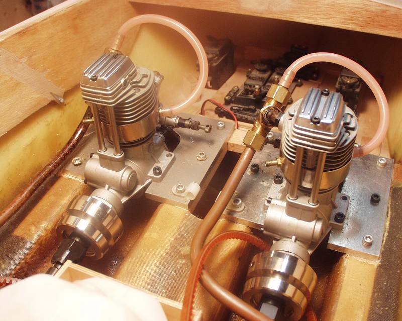

Old 02-09-2006 | 04:10 PM
Joined: Jan 2004
Posts: 90
From: Shaker Heights, OH
Default RE: 4 stroke
Here are twin marine water cooled OS .61 4 strokes in my Donzi. 2 of them running full tilt sound delicious The boat has a wet exhaust out of the transom. The gurgling exhaust out the back sound's surprisingly realistic.

Old 02-09-2006 | 11:03 PM
Joined: Feb 2004
Posts: 523
From: NY
marty that's a very great looking boat. have you run it already?
Old 02-10-2006 | 08:06 AM
Joined: Jan 2004
Posts: 90
It is not quite done yet. I have bench tested the engines. I am still connecting servos and working out the kinks. Still need to complete some details on the deck. Need to add some scale figures, ropes etc. Just a bunch of little things to dress it up.
