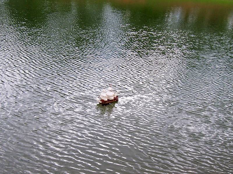

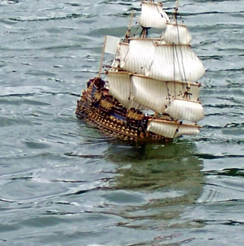

This Soleil Royal square rigger that I did is 20 inches in length. Self-tending sails and rudder.

Looks awsome but the waterline looks awfully high[X(]. You must be pretty nervous sailing her.
Have any more pics or details?

In up to 35mph winds, it had never dipped the deck in the water. The leaning shot was at 35mph or so. Actually, the ship is completely fiberglassed and sealed...in theory, you could hold it under water and it not sink.

The "yards" (cross spars that hold the sails) of the masts turn (left/right/port/starboard) as the wind changes. The braces (sheets) are on a half loop that adjusts with the sails. The yards will turn to about the position in sailing known as a "close reach". The rudder is a weighted free turning rudder with lead in it . When the wind hits the ship as example from the side, the weighted rudder drops to the side of the lean compensating for the ships "weather helm", that is the tendency to turn into the eye, or direction of the wind. With the ship balanced right and the right amount of rudder and lead, the ship will sail straight in even heavy winds.
Trying not to get complicated here...hope that answers your question...

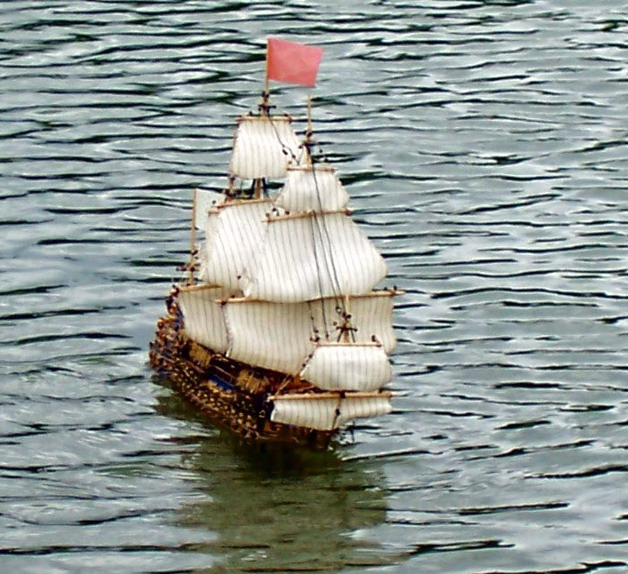

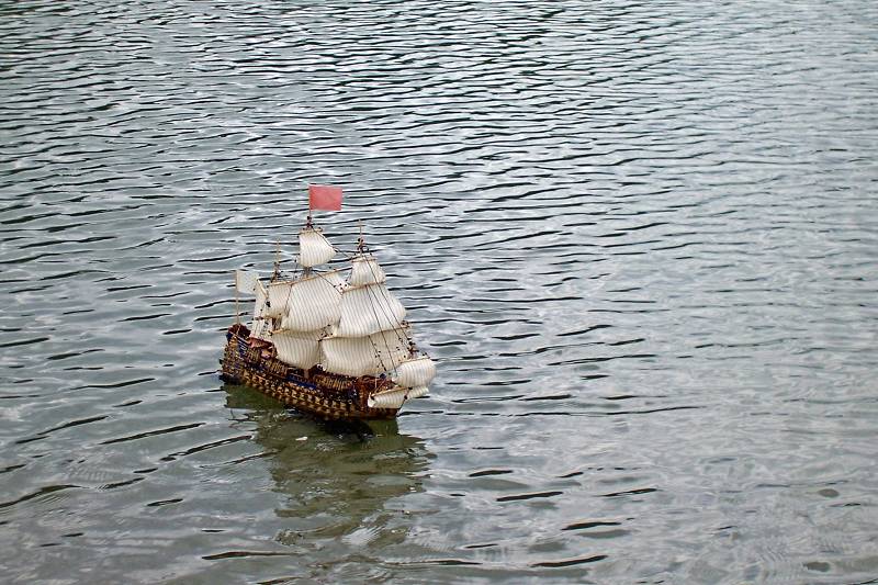

Heres a few more shots...

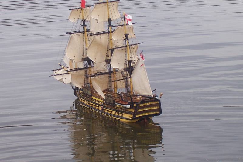

Heres another example of a weighted keel ship, the HMS Victory that I did. A key point in this one is that you can see the oversize rudder in the water that is also essetial for these ships.

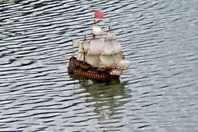

I found one shot that shows the keel in the water if you look close.
