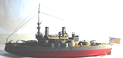

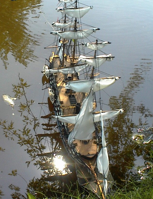

here are two more examples of static kits converted to RC
USS Oregon Glencoe kit scale 1/225
Le Napoleon Imai kit scale 1/150 French steam battleship 1850
Rolf

Old 08-05-2006 | 01:10 PM
Joined: Dec 2002
Posts: 1,712
From: Wausau, WI
Default RE: USS Enterprise
That square rigger is gorgeous.
