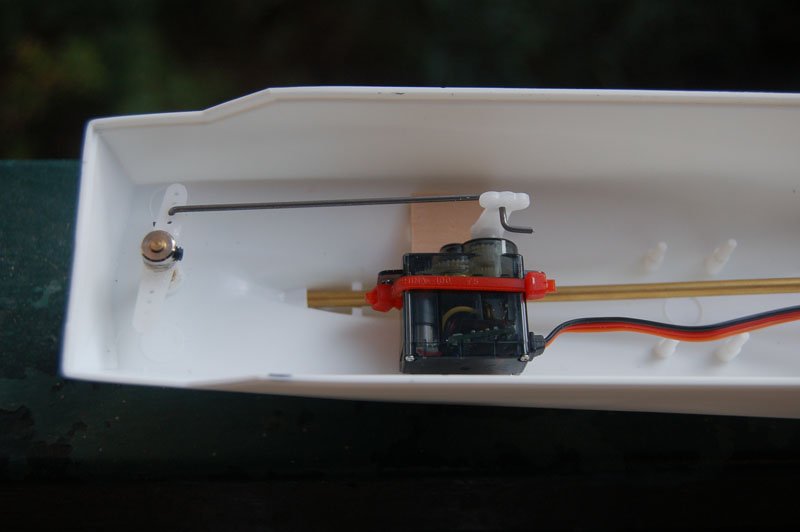

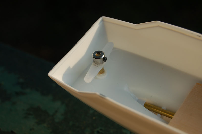

I read about a conversion of an Imex ship on another forum and loved the idea of a pool ship so I have started building one of my own. I love container ships so I chose the Toyama from Imex. The hull is one piece with the outer prop skegs that need to be glued in place. This ship is a triple screw hull but I am only going to power the center prop. I am using a prop from the Tamyia Bismark kit I hope it works. I have assmebled and painted the parts that can be built now and I have more there to build as well. The servo for the steering and the linkage is done and tested all is good there. I am not sure if I am going to canabalize a servo yet or get a small motor for a helichopter tail to power this ship. Servo needs no ESC but only one speed, the ESC gives me many speeds but more stuff and weight. I guess I will just have to play that part by ear. Well here are some pics of my progress so far. Let me know what you think about the little ship.
Massey

Looks great so far. Looks like you have a really clean setup especially in the stern with your servo and rudder assembly.
I have done a few conversions myself and have had great success using the kit props drilled out to accept a brass prop shaft. I secure the prop with epoxy and have had no fuss. I am fascinated by RC conversions of ships that were originally intended for display (dare I say for collecting dust on a shelf?).
