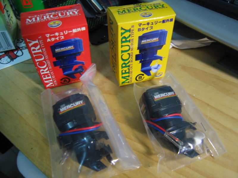

Ok, I also put this in the electric speed forum but it could also fit here as it basiclly a conversion of a model...Just bought this, When I was younger(Im 20 now) my dad and I would build small free-running boats for these motors, so when I found this I had to have it if it went cheap enough, and at a tad under 40 bucks on ebay I got it, The shop we got the motors from in the past ran out and never got more in. They work quite well and even though they are not anything super fast the pair of the on a 25 inch boat running off of one esc and one 6 cell pack should provide plenty of power for running on plane...I have included some pictures from the auction, may take a week or 2 to arrive...let me know what you all think...

I got it on ebay, its a company called mitsuwa, I can get an actual demension when I get them, but four would look about right on a nitro vee sized hull, maybe a little smaller hull, it wouldnt be killer fast though, unless you put upgraded motors in the units like I may do

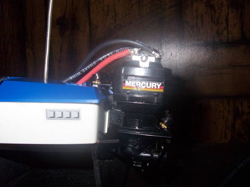

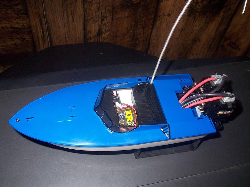

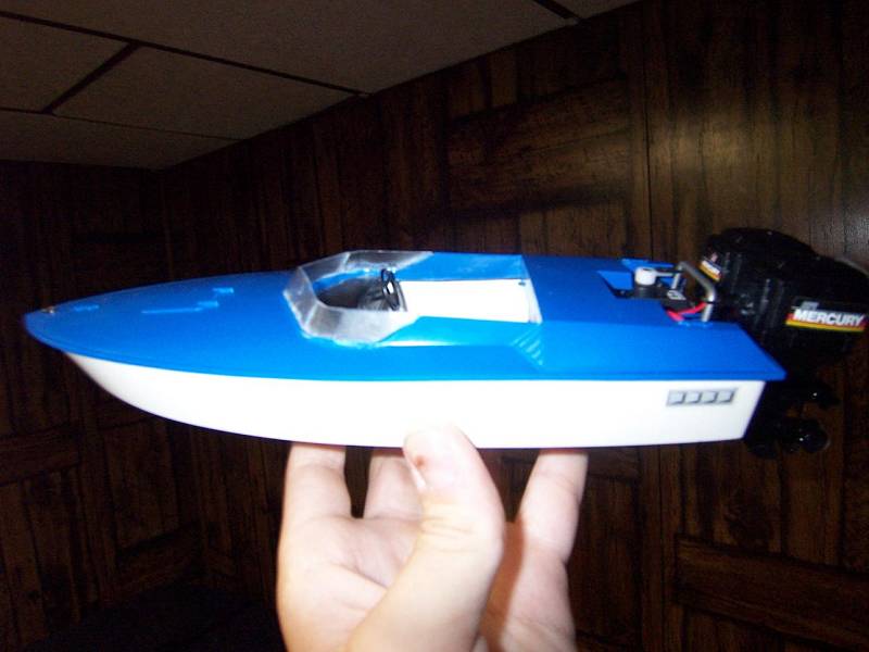

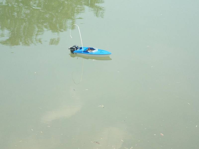

Finally, finally it is done...and run once, and now I need to replace the motors, I fried these small electrics, so they are getting replaced with 180 sized great planes motors, they will fit the outboards and will only slightly protrude from the top of the covers...fast, for its size OH YEAH!!!...needs trim tabs to keep the bow from hoping and it looks sweet, I lost the windshield so I made one that came out great...lemme know what you think of this thing now thats is all done...
-two channel futaba w/ micro servo
-Novak xrs ESC
-great planes 11.1volt 910mah li-po pack
I really like it, heres pictures...oh and the running shot was at about as low of throttle as you can go, I was driving and photographing...

Well, as the relative newcomer to this thread but no stranger to these boats, I think it's GREAT!
Great pics too as the pictures speak for themselves. I like how you have the servo right there in the stern with a very direct hookup. I was thinking of bellcranks and linkages leading to a mini servo mounted (and hidden) somewhere in the middle of the hull. Looks like you made it a whole lot easier.

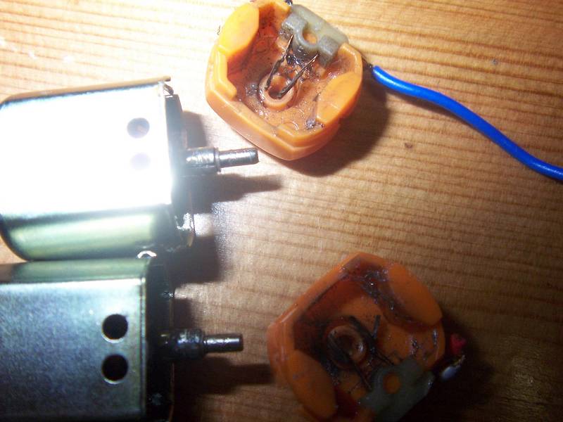

What was the problem that resulted in the motors being fried?

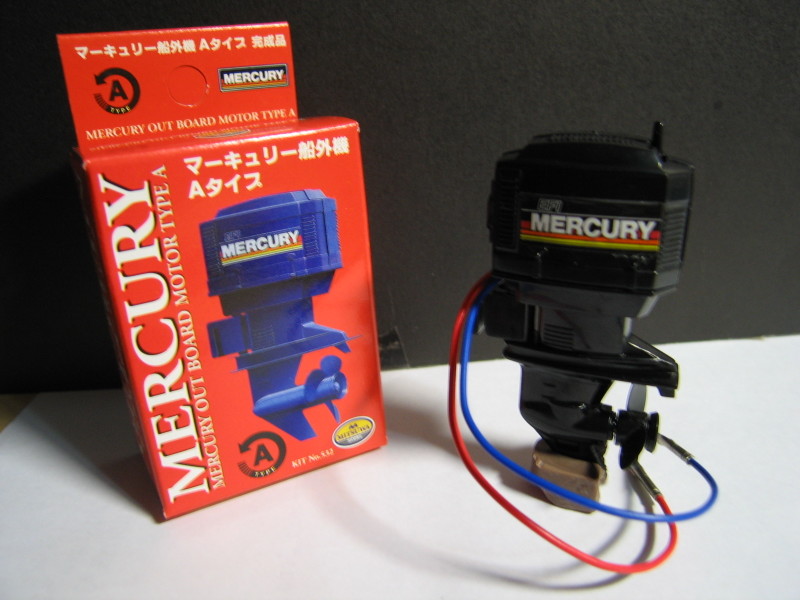

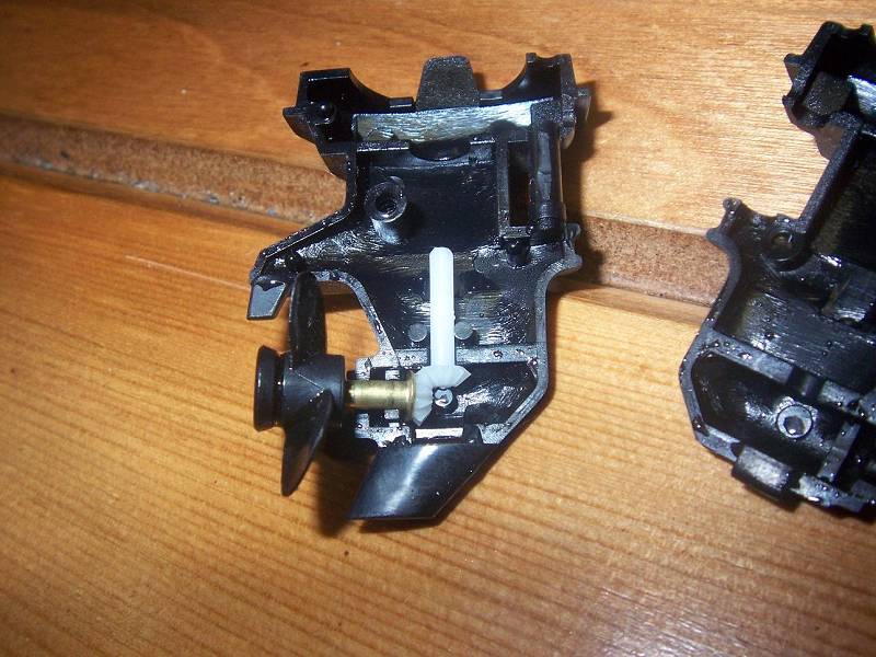

The motors are made to take about 3 volts each if you wire it and power it by the diagrams for the free running model...so the 5.5 from the li-po wired in series was more plus the amps would have been way higher...I thought about hiding the steering servo but I wanted it to be simple...I am replacing the motors with some 180's, Ill post a pic of the ones below...they use them in small electric planes and I have used them before...they work real well and handle alot more power, they will protrude through the motor cases slightly but I think It will still look ok...and they were cheap...I have upgraded to better steering links also and also greased the gears in the lower units to prevent burning those up...hopefully some more people will comment...anyone else have a plastic model conversion they are running? I'd like to see them

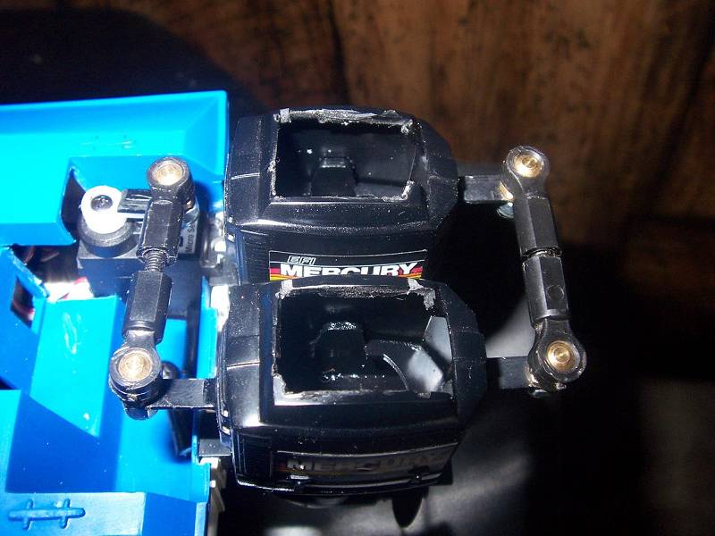

Heres the next installment of this build/frankenstien little boat...I believe I have made a monster, the 180's are in, some 14 gauge orion snakewire. and now they are wired in parallel, it has way way more power, just a test in the tub tonight(already dark) I'll run it tomorrow evening and report, it may need a higher capacity pack to increase run times and also balance the boat a bit better...maybe a something like a 1320mah or something...Im gonna go easy on the throttle as not to fry these motors...maybe a 1320mah 2cell instead...

What an effort. You really shoe-horned those motors into the outboard motor housings. Certainly is a Frankenstein monster, especially with those massive wires coming out the top. [sm=tongue_smile.gif]
Can't wait to see some action pics and learn about your performance results.

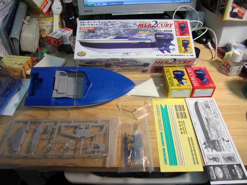

On a similar note, I just unwrapped a package that came in; a Mitsuwa Family Cruiser albeit with one Mercury outboard. Nice boat and has probably the same lower hull as yours but a taller superstructure. Would like to keep the motor stock and try for an RC conversion similar to yours in the near future. Perhaps some kind of voltage regulator can keep the power from a larger battery pack in the right range for long term operation...
For anyone else interested in these boats, which I initially thought were out of production, I've found a U.S. distributor with a fairly comprehensive lineup: http://www.bluefincorp.com/products....d=108&m_id=108
Aside from that, they are found on ebay quite frequently it seems.
