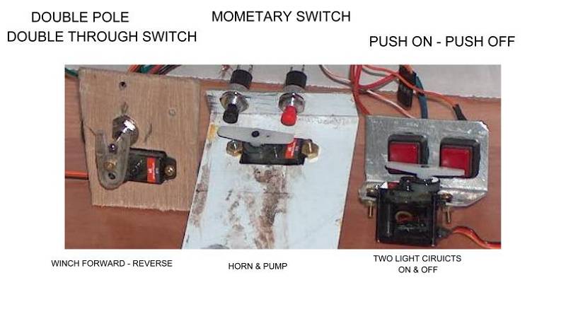

I use mini servos , with a mini servo and two push on, push off switches I can control two light circuits. With one servo and two momentary switches I can control a horn and water cannon. One mini servo and a double through double pole self centering toggle switch I can control a winch in & out.

I've had good luck using servos to push microswitches for low-amperage uses like lights, etc. I've also used them as a simple on/off forward/reverse speed contol for smaller motors. If you get the ones with the long metal arms, they can be easier on servos, since the metal actually 'gives' a bit if the servo arm pushes a little bit past the 'on' point.
