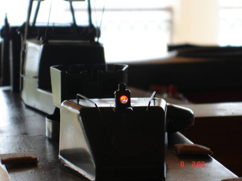

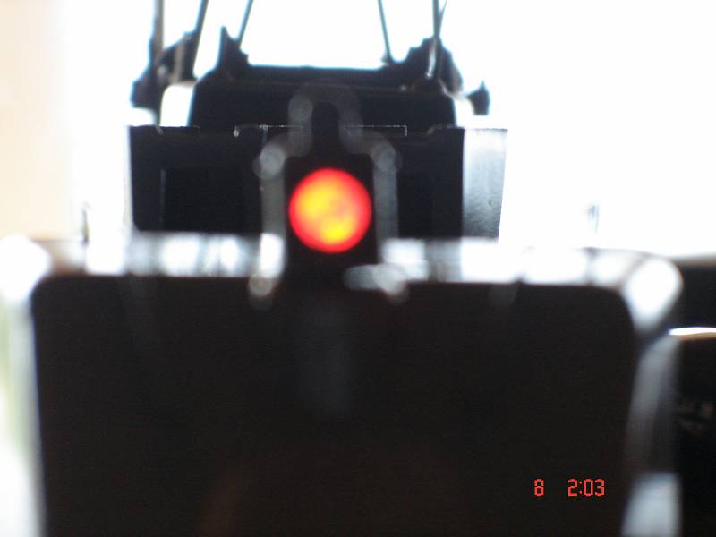

Ok I have installed the lights on the boat. But there is problem, the lights are turning different colours, like the white light on the back has turned a redish colour. And I know it is the right light because when I first put it on it was white. Here are some pictures of the white light that has turned a redish colour:

OK. What kind of lights did you use? How are they wired? What voltage battery are you using fot them?
Filament bulbs run at either lower than their rated voltage or from a supply that can't supply enough current will glow dimly i.e. a bit red. They also need a healthy battery supply - quite often, the lights will take more than the motor.

The lights that I am using are LED lights, and are running of four batterys each one with a voltage of 1.2V

I assume the batteries are in series, which should give a nominal 4.8 volts. What resistors are you using?

None, Should I use resistors? and if yes what are they and how do you set them up?

yep, resistors are vital to LEDs, doesnt matter as to which leg of the LED they are on, just as long as they are there.

LEDs are diodes that emit light when they have current passed through them. In the reverse direction, they can withstand about 4 volts, above that and they die. In the forward direction, the "normal" ones drop typically 1.9 volts, but newer types often drop more. Brightness is a function of current, the more current, the brighter, up until the point where the current id exceeded. Then they die. The purpose of the rsistor is to limit the current to a safe value. Typically, for a current of 15mA off a 6volt batery with a 1.9 volt diode, you would use the formula R=(Vb-Vd)/I, where R is the resistance wanted, Vb is the battery voltage, Vd is the diode voltage and I is the current. In this case, 270 ohm.
Some LEDs are sold as being for a higher voltage, and have a resistor built in, and will work OK up to that voltage.
It could be that the bit on the inside that was a diode has melted and become another component, and is just glowing red now.
Some LED devices (like the mini torches on key fobs) rely on the battery used being a type that only delivers a limited current.

Just wire one in series with each LED. Resistors are nor polarity sensitive, so it doesn't matter which way round they are connected. It also doesn't matter whether they are connected in the positive side or the negative side. Easiest way is just to find a lighting wire at an accesible place, cut it and solder the resistor to the cut ends, insulating the bare wires.
