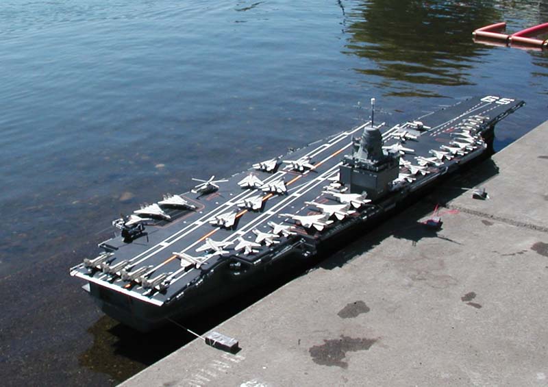

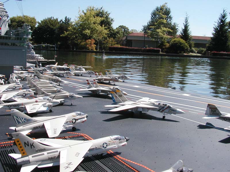

If you look around you can find 1/96 scale aircraft...
[8D]
Andrew found a few....

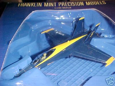

Some examples of 1/100 found on ebay:
