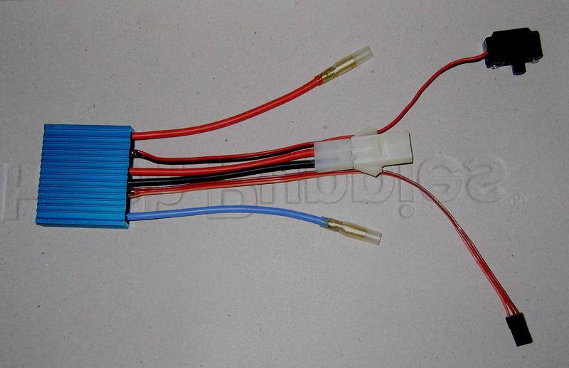

I have bought a speed controller branded a Himark HI015. It is good for 50 amps forward or 20 reverse. Its working voltage is 5-10 cells (6-12 volts). It looks remarkably like the Proboat item photographed in the PT boat on this site that has 3 of them.

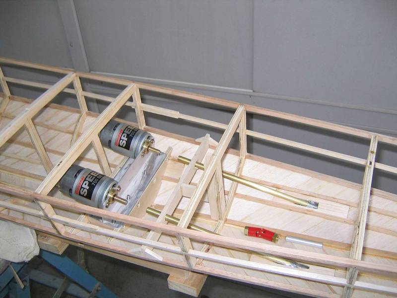

I am building a Fairmile D 1/24 scale. I intend to use 2 Graupner 700BB motors in parallel with the single speed controller.

Can I disable the BEC part of this controller and use it with separate power for the engines and separate power for the RC. Although I have Futaba RC sets that are PCM FM, they do not have the newer BEC capability.
I have copied the basic instruction sheet and a photo of the ESC.

Maybe I'm confused about what you need to do, but you don't need BEC on the Rx to use the ESC's BEC.
The logic circuits in both ESC and Rx need about 5v (4.8 - 6.0v battery pack will do).
Some Rx's have "BEC"... merely means it has an internal voltage regulator that allows you to plug in a lead directly from your main pack (7.2v? 8.4v? etc); the regulator makes 5v and sends that to the Rx brain, and on to the servos as well.
But most ESC's do the same thing... as as long as they're regulating 5v out of the main pack, and as long as the ESC already has a lead going to the Rx with signal and ground, why not just send some of that 5 volts up the red wire back into the Rx?
So... for BEC or non-BEC Rx's, just connect that BEC-enabled ESC to the Rx, and away you go.
Now, should you prefer to use a separate pack for your Rx (either a 4.8-6v Rx pack, or any higher V pack into a BEC-Rx), it's common to disconnect the 5v lead out of the ESC. You can just snip the red wire (crude), or use a sharp little tool to unhook the 5v lead out of the plastic shell, and tape it back... so that you can use BEC later should you change your mind. That's all there is to it.

Patmat is right. To unhook the red wire, look at the plug. There will be three slots. Gently depress the locking tab that is retaining the red wire pin, and ease the pin out. Tape it back in a tidy manner, and it can be re-inserted later it needed.

I am to understand then that the red wire can be a two way route. I know how to carefully remove the red wire connector from this plug.
My reasoning to use a separate power supply for the Rx is that I would maintain control of the boat despite the reduction of the voltage of the main batteries for the engines, and that the power to the radio would not be cut off. The weight of the Rx battery pack will not be noticed in this model.
The final question is whether this one ESC is OK for the two Graupner 700BB motors in parallel.

I've often wondered about that line of reasoning for a separate Rx pack:
1. If you're using, say, 7.2v packs or higher, a "low" battery will still have plenty of juice to supply 5v and a few milliamps to the Rx;
2. And if the main pack is down that low, what good is radio control? You won't have anything to command!
I always just use the BEC; it's a good thing.
Two 700's on one of those ESCs? Good luck. Most ESCs are not capable of delivering the advertised current. Buy one more now for a total of two, vs. toasting one and buying a total of three!

The ESC in question looks identical to mine, and in Australia too. I should probably buy another and watercool both.
I have previously used 2 x 6v x 7.2 Amp hour gel cells in series successfully with my other patrol boat that has 2 x Mabuchi 550s, so I was going to start with them, but also try some 5ah NiMH D cells as an alternative. It will be 12v with as many Amp hours that I can get to fit into the hull for the right weight.

A BEC is typically not designed to supply more than one amp to the radio system.
If there are a lot of servos,... (More than two) and features that run off of the reciever power, the
BEC can be overwhelmed, and cause the entire system to get the jitters.

My motors are 2 x 12v 700BB. The proposed props are Graupner 40mm 2 blade standard pitch (RH & LH)
I just bought another ESC of the same type so that I have one for each motor, connected through a 'Y' harness but with the red wire removed from the connector to eliminate the BEC.
The plan is to water cool both the motors (aluminium coil) and ESC's.
I am not sure how many servos will be used on this boat at this stage but it may be as many as 6.
