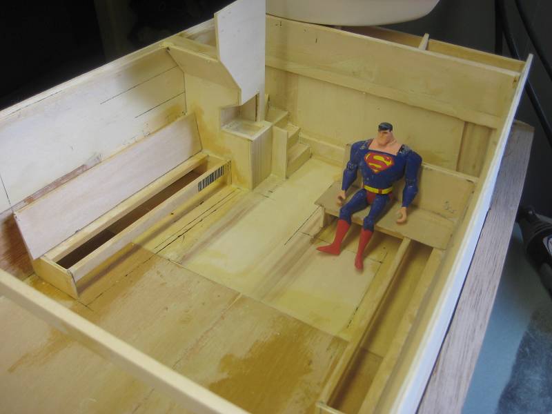

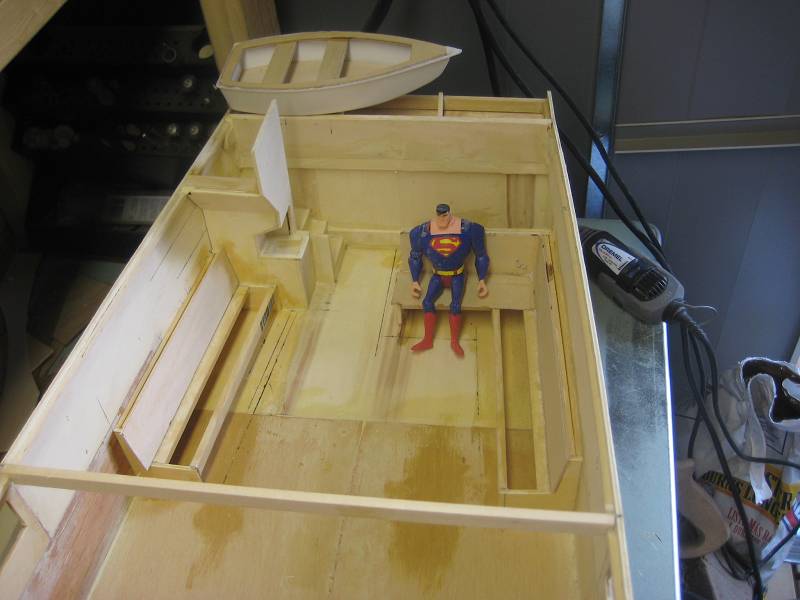

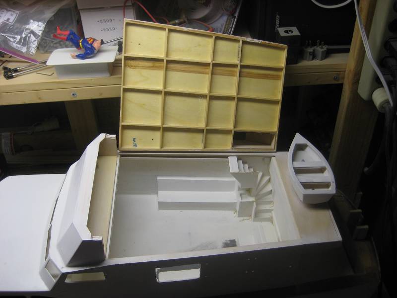

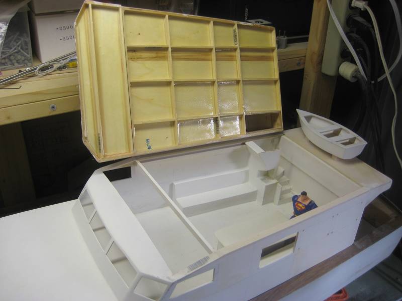

Got the lounge seat structure in and the wet bar almost done............

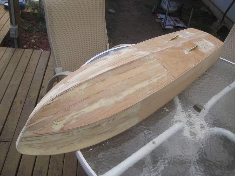

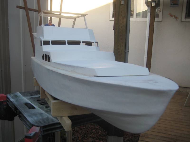

update...bondo, sand, prime, bondo, sand, prime, bondo, sand, prime, repeat........
Finally close to finishing the hull.....got the skiff mounted and the framing for the flying bridge started.....there is hope!

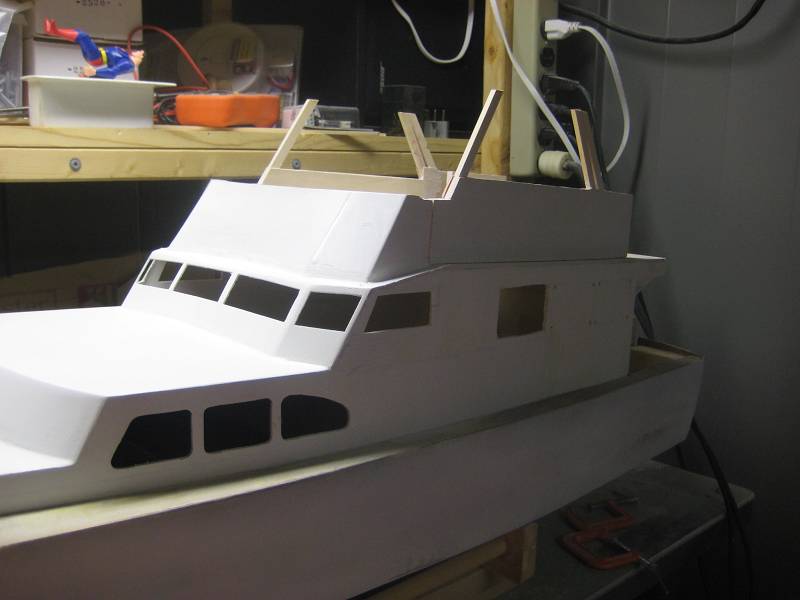

I have been apprehensive about the flying bridge but it is coming together niceley.....just my opinion

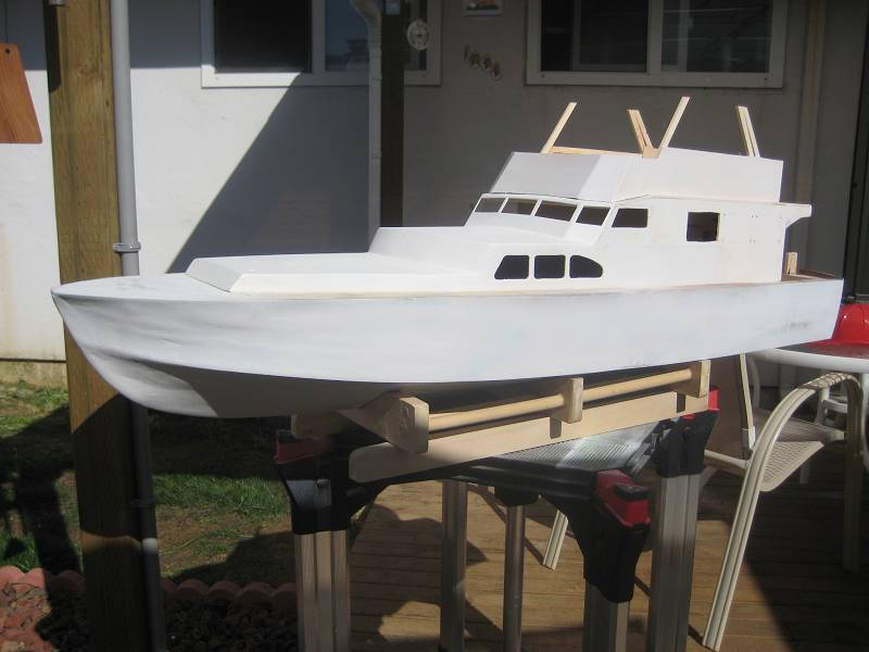

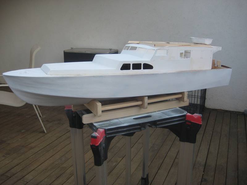

Thinking about black bottom, sky blue hull, white cabin structure with sky blue trim......not sure
The flying bridge is coming together....it looks better in real life than these pics, looks to tall here but actually looks good. I actually have laid out seating and a hot tub for the flying bridge. There will be a small crane for lifting the skiff.
I am itching to get this in the water! Please give input.

Hey Rich,
That is certainly a nice looking motor yacht. I am looking for any and all input. The sooner I know I am going the wrong direction the sooner I can correct it.
I was originally going to do an all white superstructure but thought I would go to two colors becasue of the joint I had to add for the flying bridge at the front. If you enlarge the first pic you will notice that the joint at the flying bridge to cabin roof is very noticible in all white. I am sue I can improve this thith bondo, etc but am concenred about the final transition if all white.
Thanks to everyone for your support in this undertaking....Larry

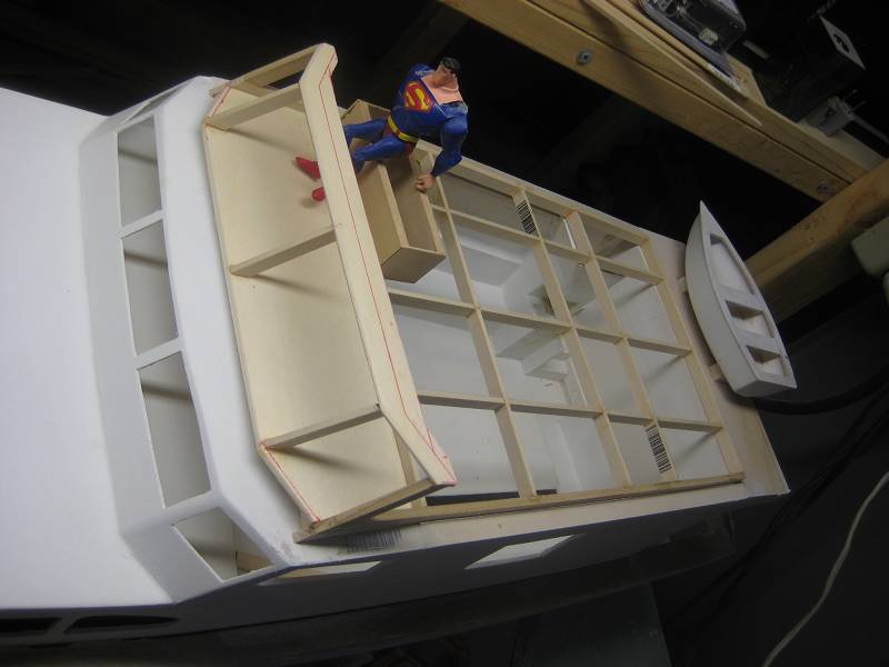

Old 03-25-2008 | 09:00 PM
  #43
Joined: Feb 2007
Posts: 147
From: Gilroy, CA
Default RE: Dauntless Modernized

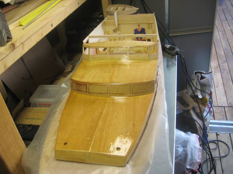

Rich,
Yes, the flying bridge will remain removable.
I had originally intended just to have a removable floor but the tapered geometry of the deck and the skiff made it difficult. But, you have inspired me to think about this again.....
The side seams are fine, the flying bridge actually seats down inside the roofline....just like the main cabin and the main deck. I can do a vertical separation of the flying bridge at the front of where the front seats will be (red line and recessed floor transition). That way I can have a smooth transition at the most visible/noticable areas and just have a short vertical joint that I should be able to disguise much easier than the arched front.
Thoughts?

Larry,
BRILLIANT!
Definitely do that. After bondo and smoothing, the end result will be seamless.(like bridgeshelter to cabin) Once the yacht is painted, the vertical joint will be barely noticable and will not really matter...
-Rich.

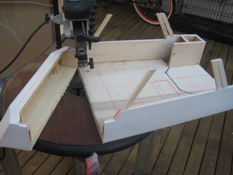

Surgery
