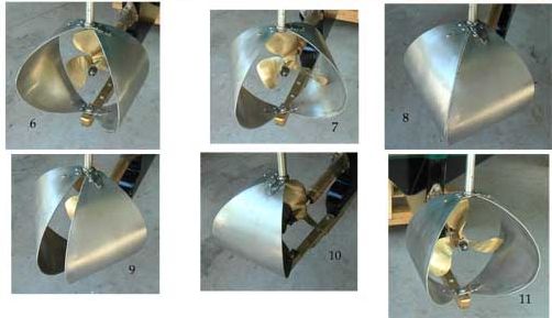

Think about a KITCHEN rudder set up with this you can slow the boat (drag) or go in reverse without altering the running of the motor they are simle to make and the servo you would have been using on the throttle will operate the cups, a simple mecanical V tail mixer that are very cheap make it easy to build.

A couple of pictures I found
Peter
