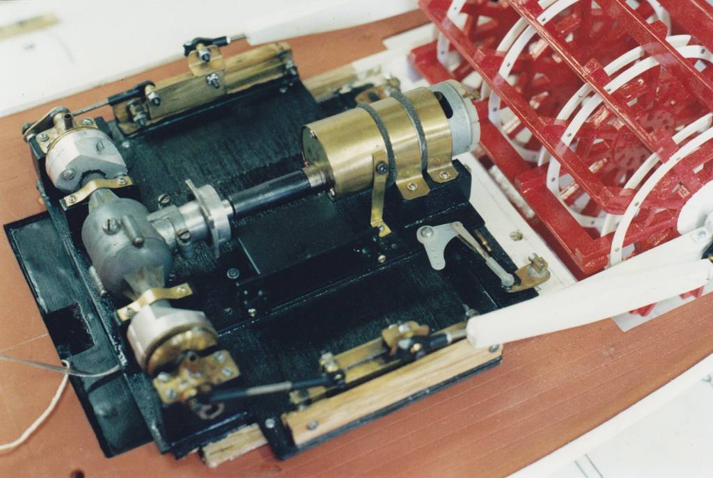

I finally got some pics of my friend's paddle tug for your info. He has used automobile power seat motors to run th etugs. All bearings for the shafts have ball bearings in them. Each paddle controls independantly through two ESC's . The paddles have feathering blades. The vessel runs very well.
oldiron

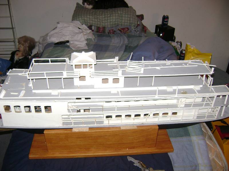

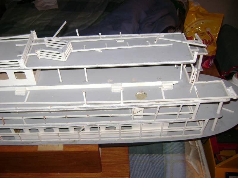

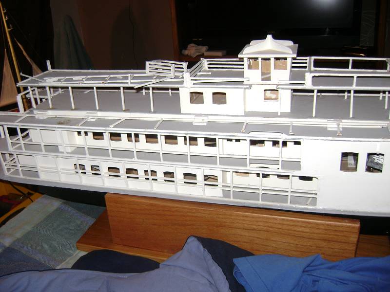

i just picked this up it will need a lot of work !!! its a dumas
thanx for looking

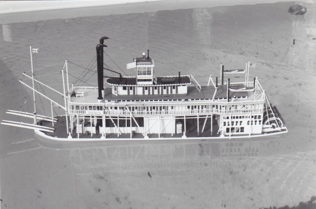

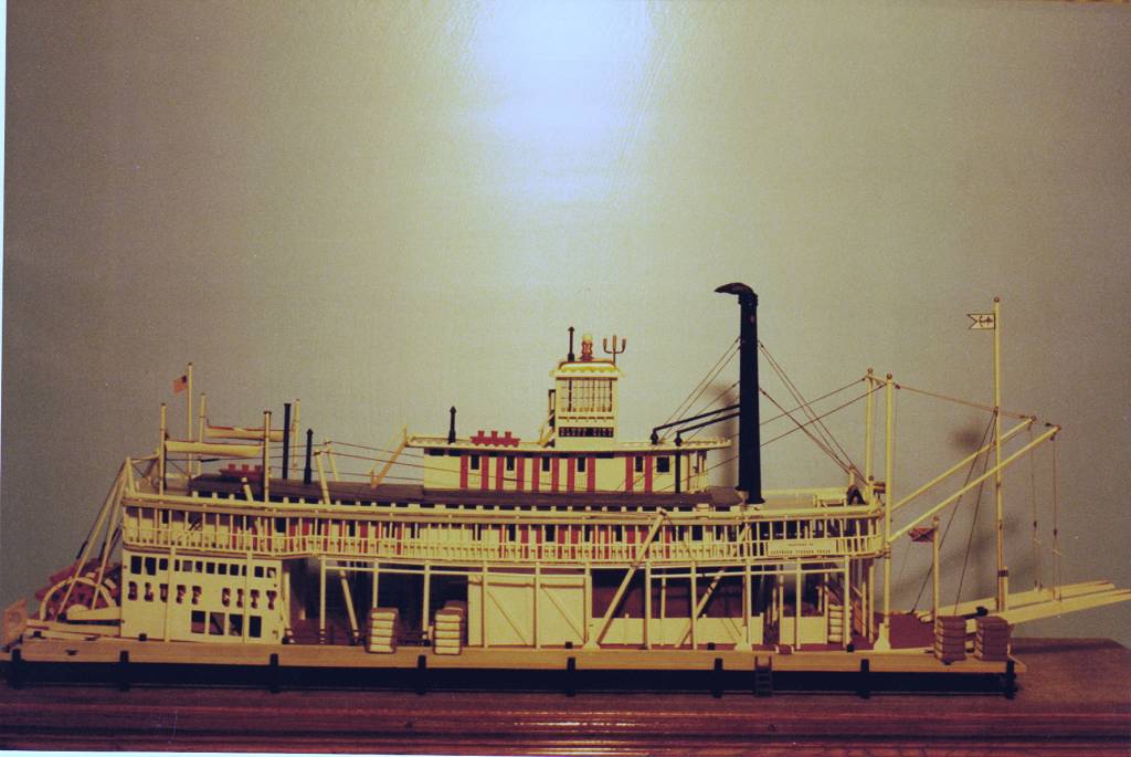

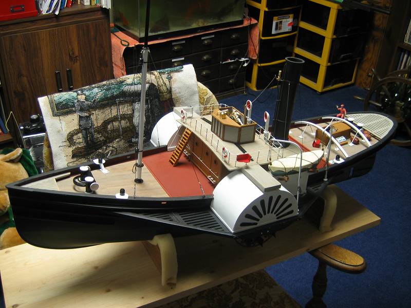

I"scratch built" a model of the Anchor Steamboat Line "Bluff City" not too long ago from photographs and drawings. I powered it with an electric screwdriver motor to turn the paddlewheel. It took me a year in the building but it ran fine for an RC boat of that vintage. It sure made me have a great deal of respect for steamboat pilots. It ain't easy to manuever like it looks. I sent my construction photos to Steamboat Masters in Kentucky, and Jack Custer said it was a good representive of the packet boats of that time. Here are some pictures of it.
Roy Fredrichsen
