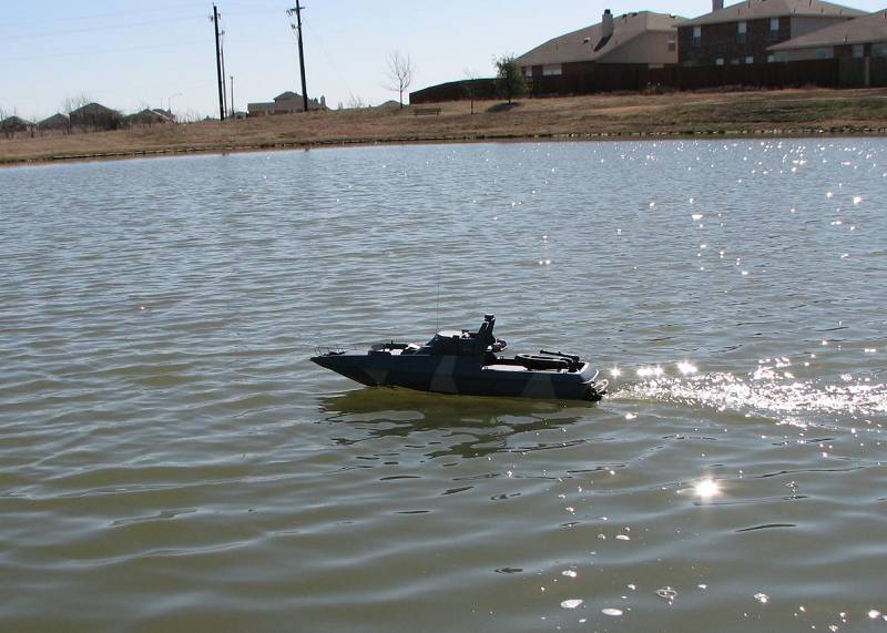

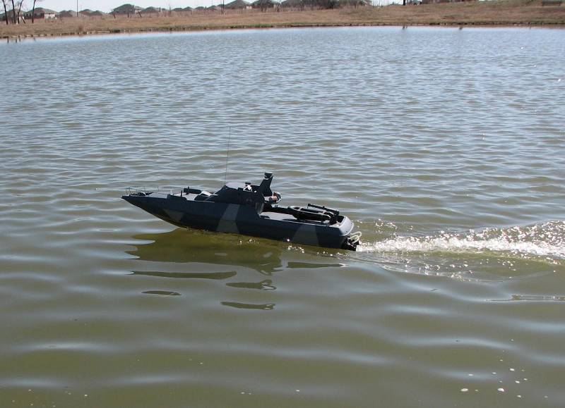

So now, its Sunday - time for Initial Sea Trials. [8D] I figured I better keep it easy on the power, and perhaps pull the boat out after 4-5 minutes, to check check the sea-keeping (is it dry, or is it taking on lots o' water). At low power, I suspect the model is entraining some air thru the waterjet inlets - you can tell the motors are running well, but there's not a whole lot of velocity. At medium power, you can see the waterjet flowthru at the transom improve, and the boat starts moving out well. At this point, I noticed a waterjet died. [] So I brought the boat in and inspected it.
Everything looked okay, so I swapped out the fuses in both motor, to the next size larger (25 amp). I was using 20 amp fuses, which is what I use on my other boat.
Old 02-22-2009 | 01:14 PM
  #31
Ron S's Avatar
Posts: 2,243
Received 207 Likes on 127 Posts
From: Fort Worth, TX
Default RE: Billing Boats THOR Partial Kit Build Thread
Boat goes back in the water, and I had a decent run. [8D] I also put about 1 ounce of lead strip on the aft deck, way aft, in attempt to keep the waterjets away from the waterline. You could see the waterjets operated a bit better at low speed, with less entrainment. I was actually kinda ready for this, since I did a "bathtub test" a few days ago. [8D]
The steering was behaving nicely. I don't think I'm gonna play around with throttle mixing - atleast yet. I ran the boat to full power in short amounts, and would bring the throttle down some, to let the motors or speed control cool a bit. I got a couple pics of the boat while at slow and medium speeds.

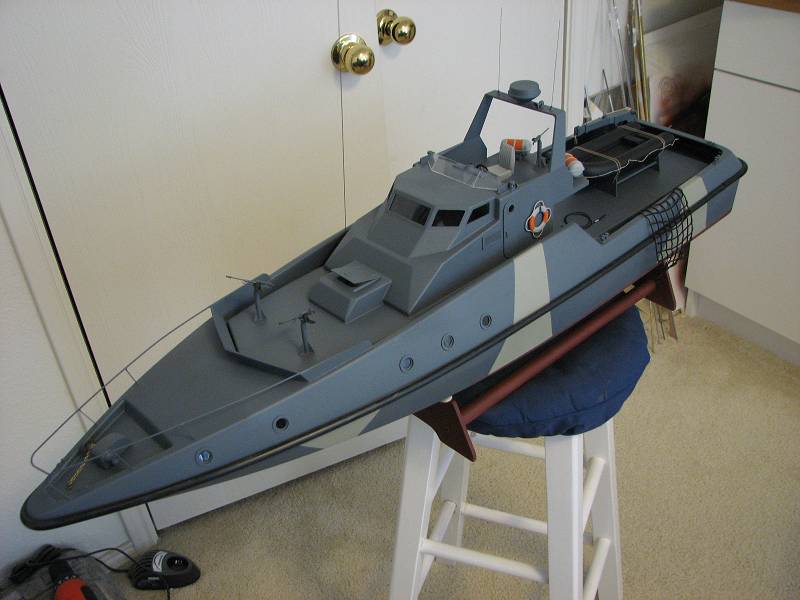

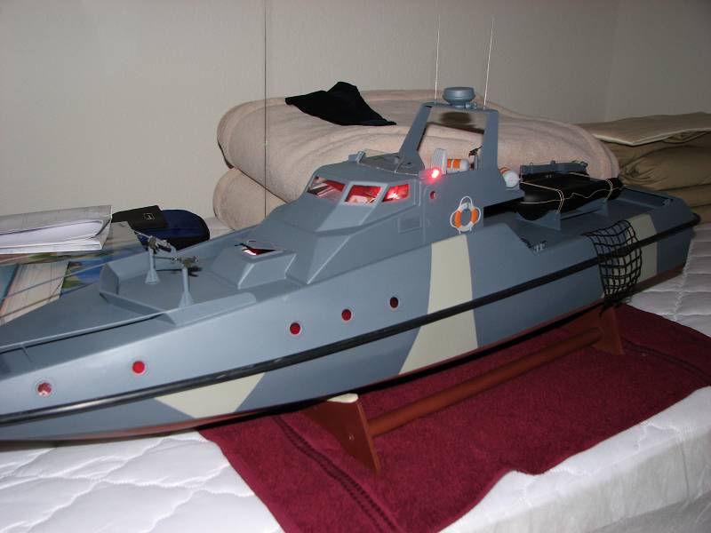

I've added a few more goodies to the boat now, like the windscreen, the guns, anchor, etc. I also added another light on the inside. I need to get a pic of the boat at dusk to see what it looks like, in the water. I also got some neoprene fuel tubing, which I've slitted along it's length, and attached it as a rub strip around the boat's perimeter. I've realized I can move the battery pack for the lights to the boat transom (actually velcroed to the lower side of the aft deck) to replace the lead I was using, to keep the tail end down a bit.
I'd like to add a few more bits to the model to make it more busy though. I also need to work on the figures. I wish I could find some figures to install that are a bit larger than the 1/35 guys I currently have. Hmm...
