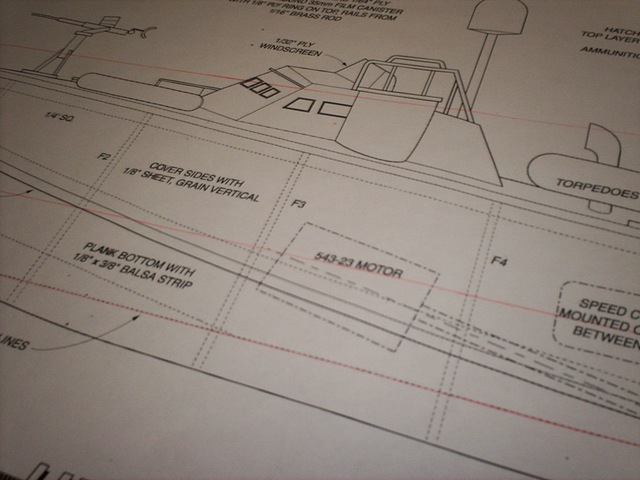

On the Higgins, decided to go with Peter Miller's free plan from August '04 issue of Model Boats magazine after seeing couple builds by others based on this plan...
Tried to find a copy of August '04 Model Boats magazine without any luck but found the article online and obtained .pdf copy of the free plan that was included with that issue...
Shown is what I printed from my computer and took the .pdf file to Kinko's to have them print me a copy on their plotter in full scale, cut out all the ribs templates. (Made 2nd copy of all templates to keep in my files)

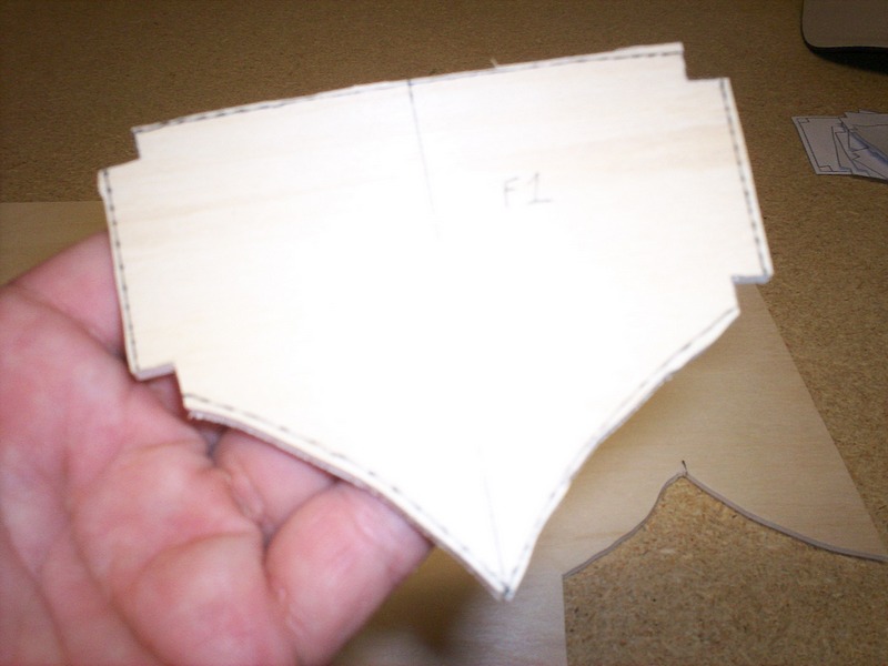

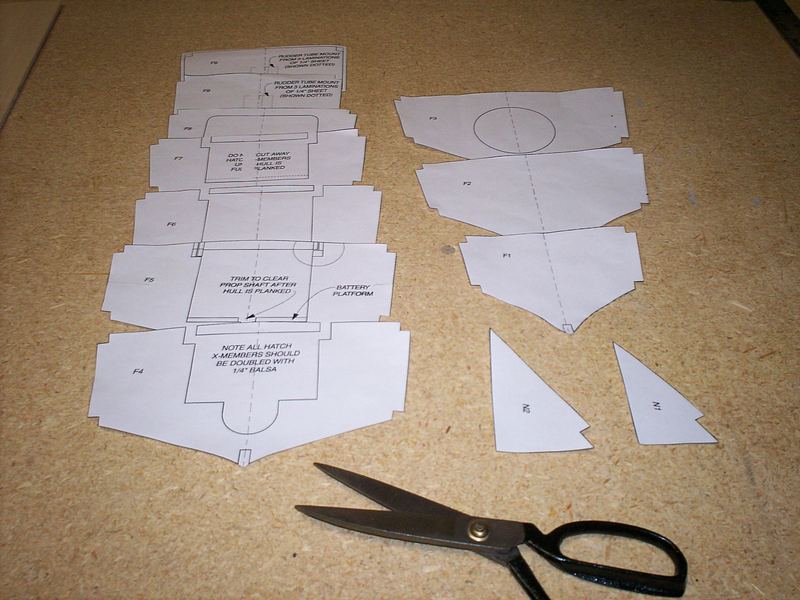

On the Higgin's plan - It shows that the author used 1/8 balsa for the bulkheads which I prefer to make the bulkheads out of 1/8 ply instead. There's many methods of making bulkheads straight from the plan such as using carbon copy (messy), 3M77 glue spray (also messy), etc...
Here's how I did with mine (Only showing how I made bulkhead #1)
1) Cut out all paper bulkhead templates with scissor...
2) Laid on 1/8 ply and marked dash lines all around the template... (Note: Its easier to do dash lines rather than trying to make solid line all around without moving the template in middle of tracing.)
3) Connected all dash lines... (Note: Dont forget to mark centerline and bulkhead numbers on it to make it much easier for yourself)

1) Using scroll saw - Stay 1/16" outside of the line all around then cut the stringer slots right on the line. (Easy to be precise with the stringer slots since its only 1/4" sq)
2) Showing the overall view of the rough work with Bulkhead #1...

Sanding the rough-cut bulkhead to the line....
1 down - 9 more to go...
*Note: Left the keel notch uncut since havent decided yet on what to use as keel and want to be sure its a tight fit between bulkhead and keel so will be using the actual keel to mark the slot on the bulkhead.*

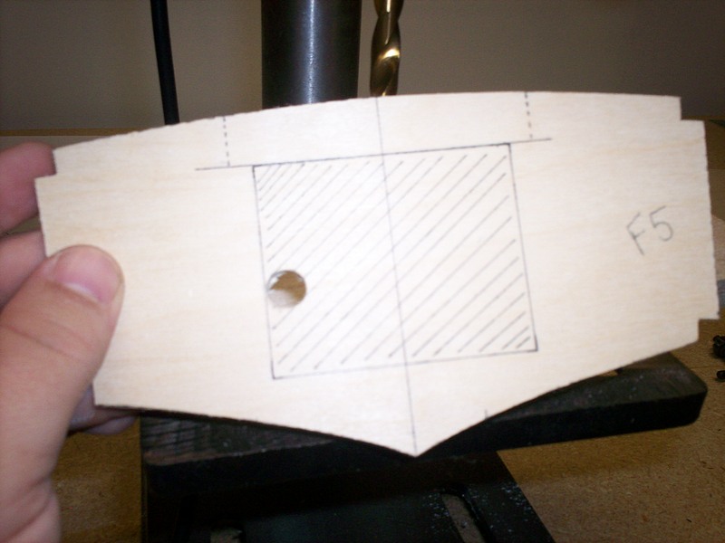

Update:
1) Marking the openings on the bulkheads - Showing progress with #5 bulkhead here
(Shadded the area to show what will be removed)
2) Drilled the starting point for the scroll saw...
3) Didnt cut out the cross hatch since will be using Jig to assemble the hull, marked the cross hatch with dashed line for me to hand cut out the hatch after the hull is sheeted and safe to remove from the jig. (Note: extended the cut outside the opening up to the dash line - circled area as shown in the last picture)

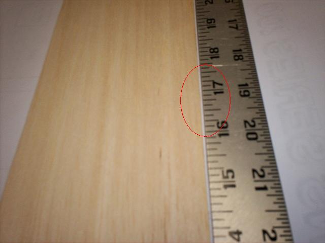

Starting on the Keel....
Looking at the plans, build articles and other's build ~ Noticed that the keel extends past the hull and the bottom planks are butt against the keel, sanding the keel profile after the planking to match the profile. This method is different from what I'm used to and will try this method with this build instead of planking over the keel as usual.
1) Plans showing the keel's around 5/8 inches wide plus/minus 1/16 - 1/8 inches in different spots as shown on the plan. So decided to cut the keel 3/4" wide to work with. (1/4" thick)
2) Got 1/4" thick balsa sheet to cut the keel out of. Note, balsa sheets almost never have a true straight edge in my experience. See in the picture below how much its bowing when butt against a straight edge.
3) Cutting off about 1/8" using straight edge. Other way is to sand the edge but only need to do one sheet so this way is much quicker...
4) Now checking the edge and its true to the straight edge...

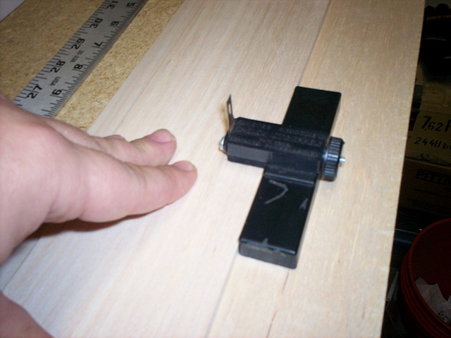

Master Airscrew Balsa Stripper is one of the best tool I've been using....
1) What I do is to set the depth about 1/32" - 1/16" below the surface and also the width to 3/4"
2) Since my workbench surface is particle wood (Too much drag on the Balsa Stripper) - I put down two pieces of balsa wood under the stock. (leaving space between the cutting line for ease in cutting)
DONT FORGET TO USE THE EDGE THAT YOU JUST MADE TRUE!!!!!

Finally found some spare time and here's how I use them...
Finished with the Keel - Didnt cut notch for the stuffing box because wasnt sure if I'll modify the angle of the shaft. Looking at other's builds of this plan, see people saying the angle is a bit steep plus going to start with direct drive but if motor's running too hot or the run time is way too short then would be swapping for geared drive. If I lower the shaft angle then I'll have more room to install geared drive. (Just covering my bases)

After Marking Datum Line on the plan, next is to figure where to put the JIG....
Since the Jig Board is 3 1/2" wide - selected 5" from the keel to give me ample spaces to cut the slots for the bulkheads. (Pic 1)
Using the Jig Board itself and line it up with the Jig line that I just made to mark the top of the Jig on the plan. (Pic 2)
Plan showing three lines to use as reference point on building Jig, Bottom line is Keel line (Datum), Middle line is top of the Jig, Top line is bottom of the Jig. (Pic 3)
