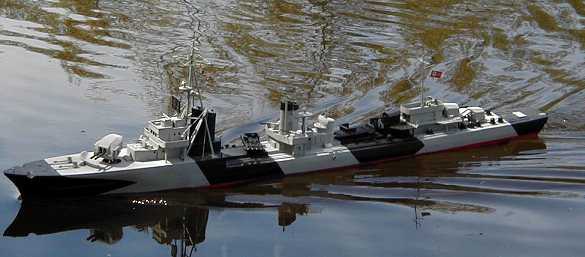

Some combat Z boats in 1/72nd scale

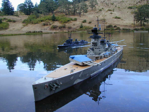

1/72nd scale Graf Spee and Z boat

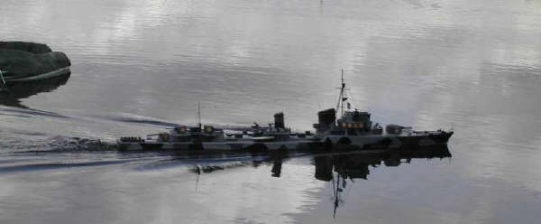

Kagero class Japanese DD and a Z boat(camoflauge)
