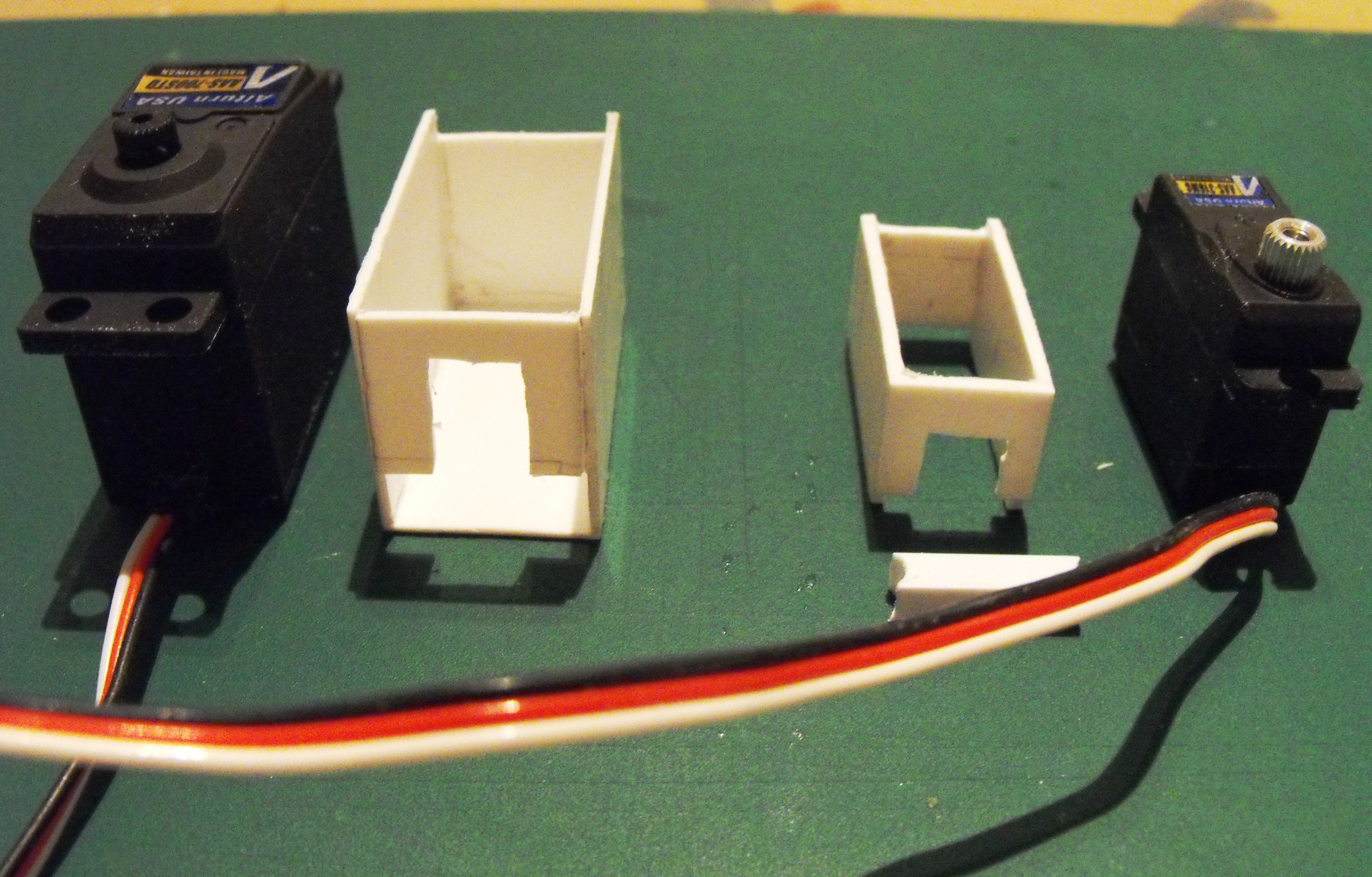

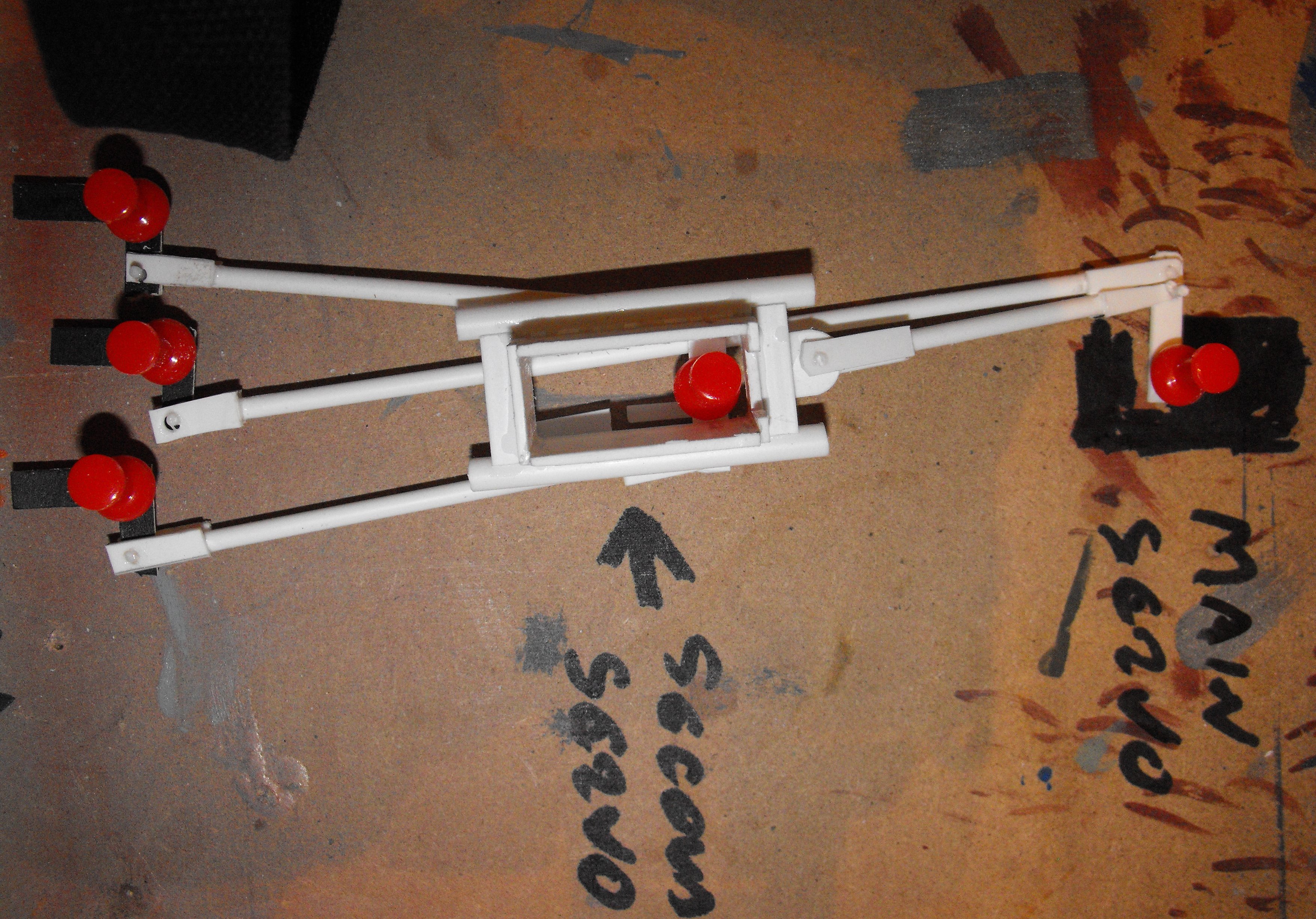

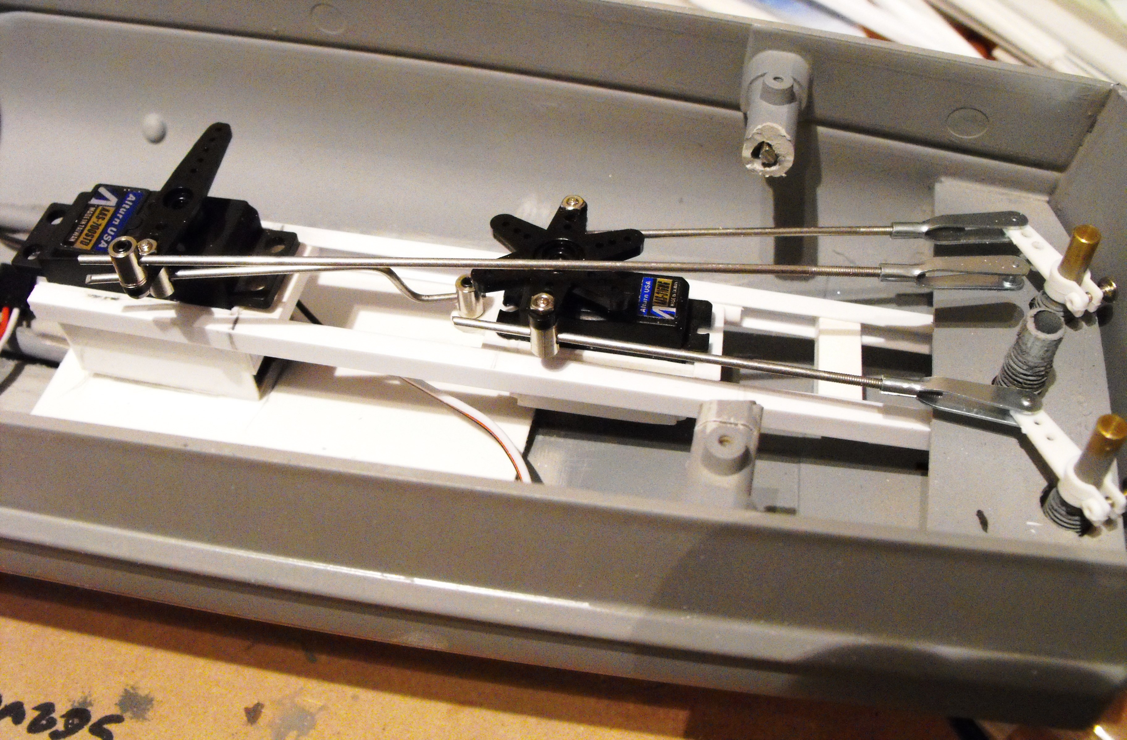

I have been allowed to access my modelling cupboard by HWMBO now that the nights are drawing in again, as I have just about completed all she wanted me to do around the house.

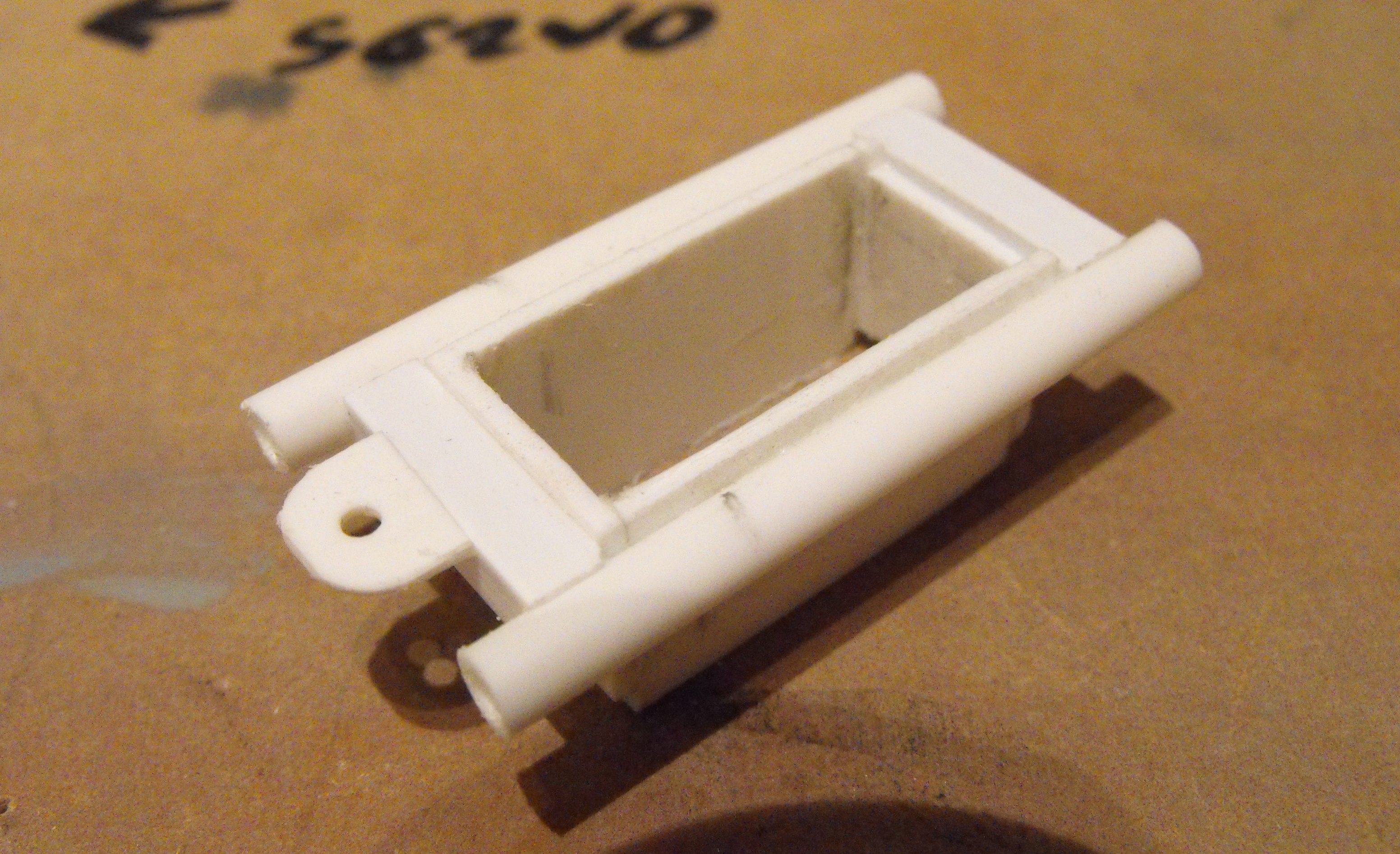

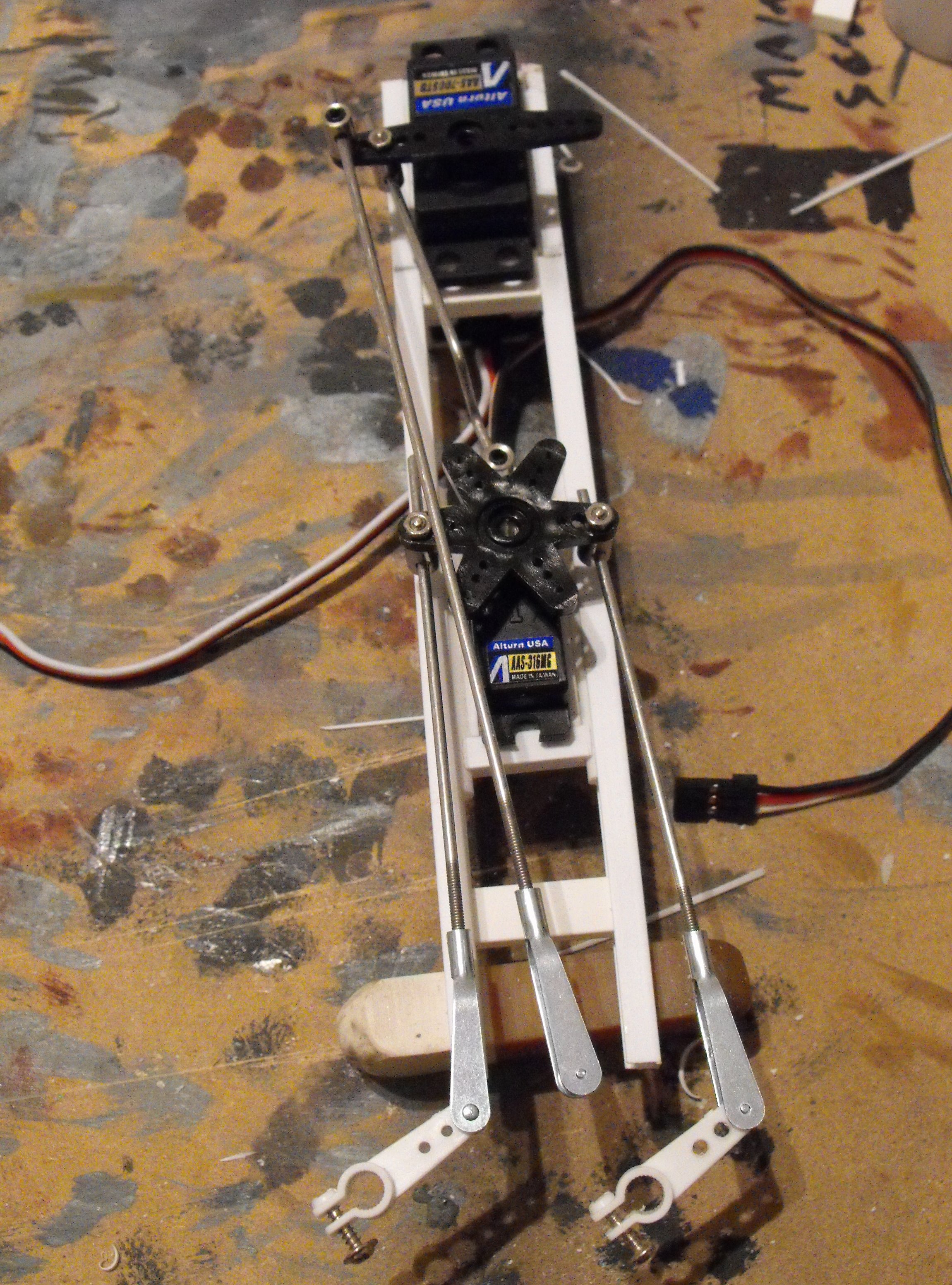

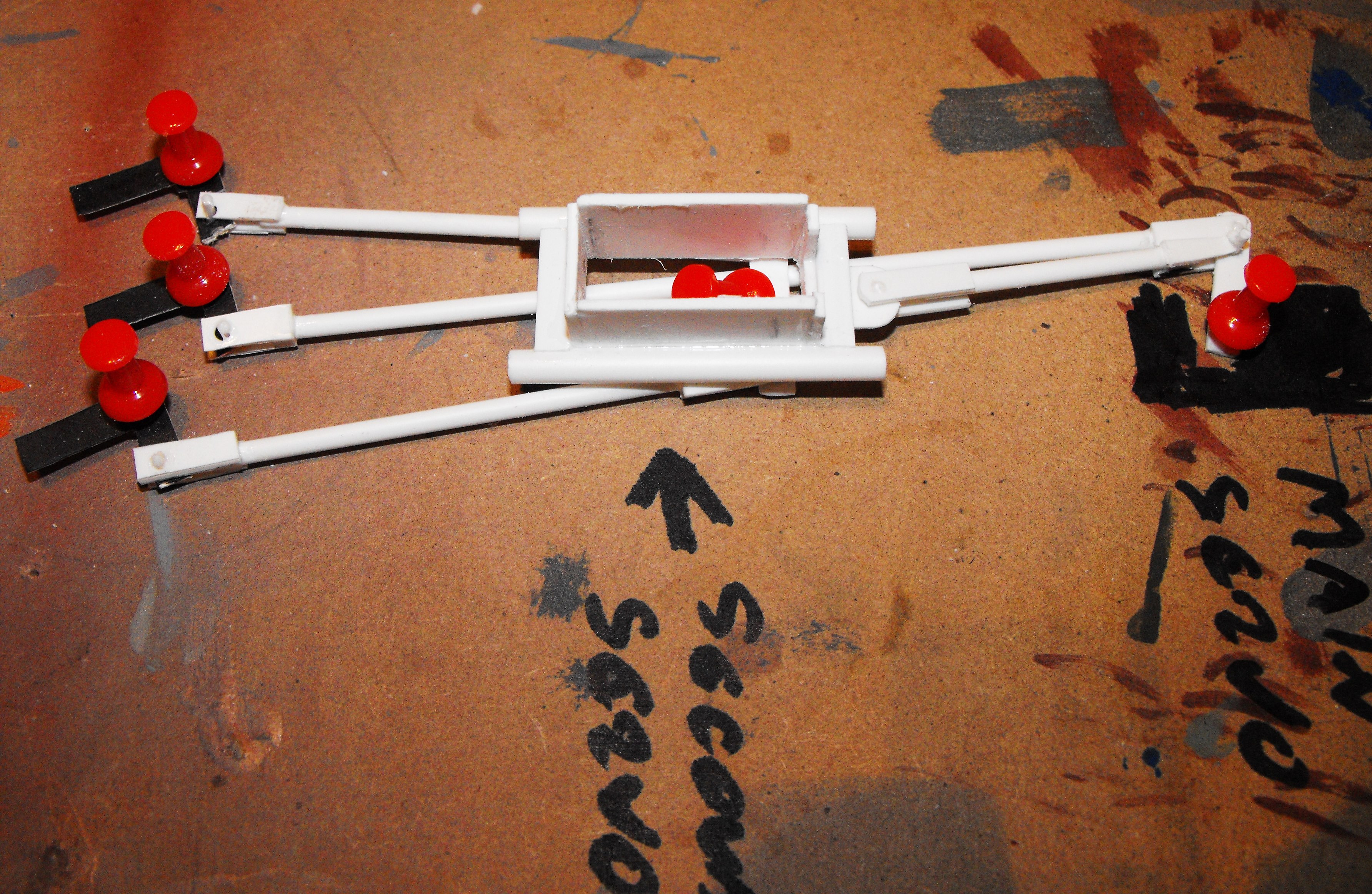

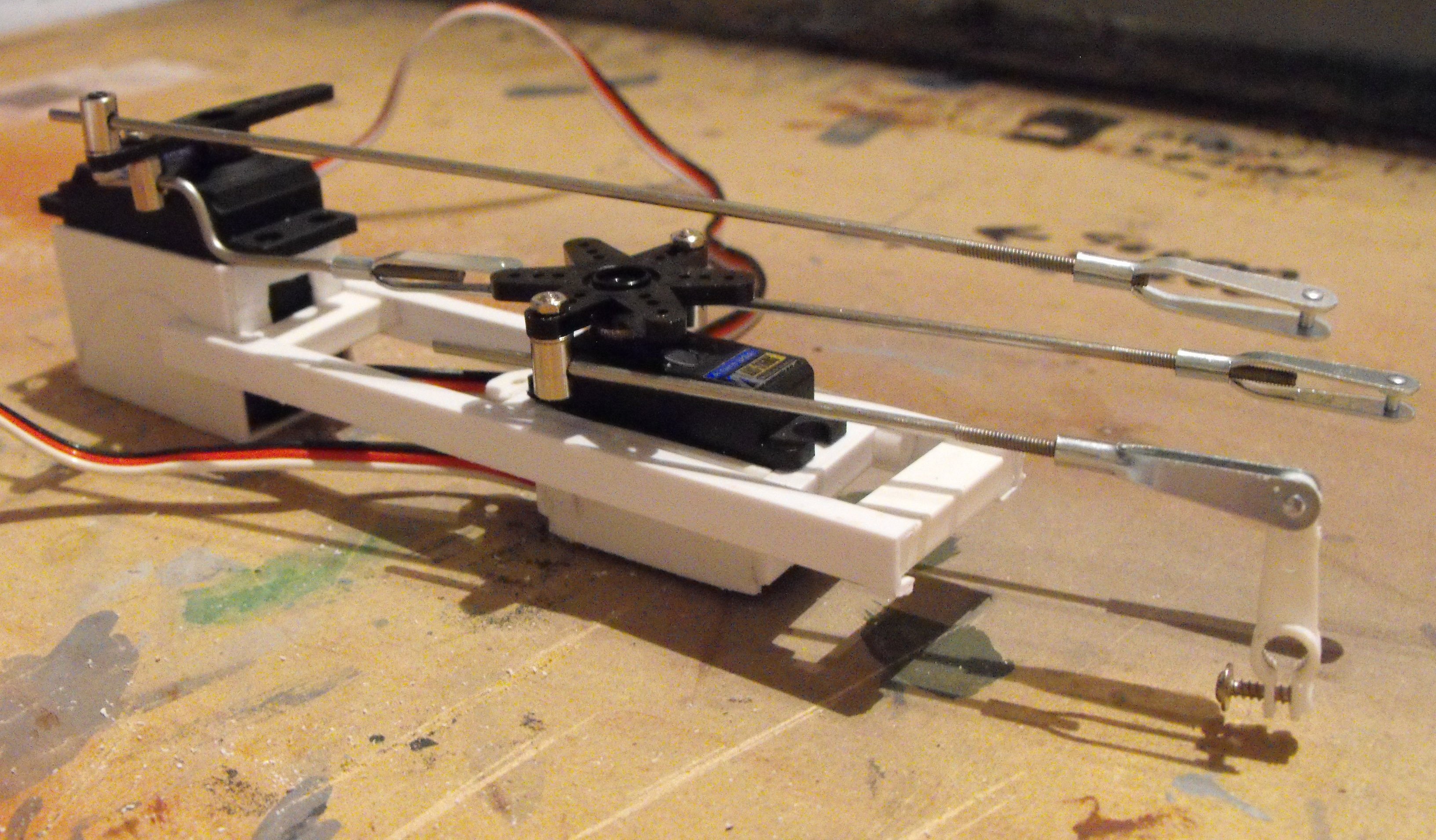

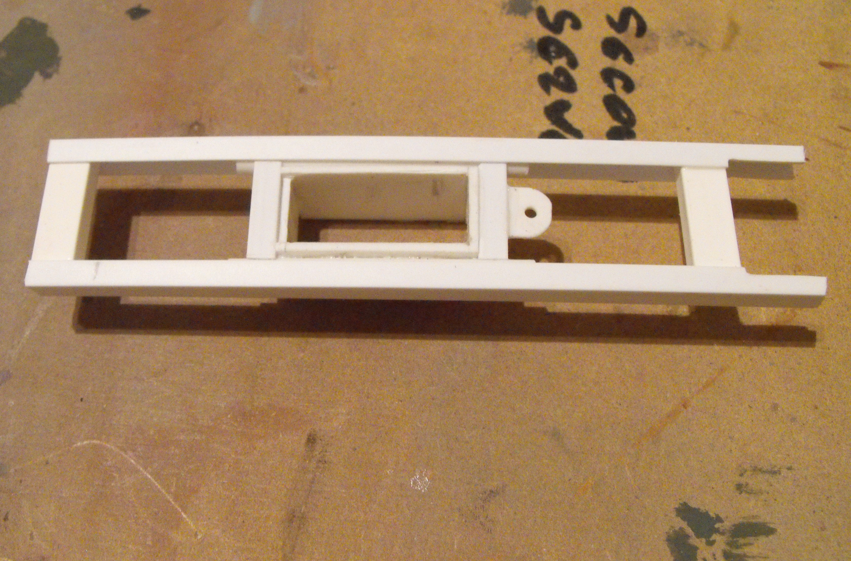

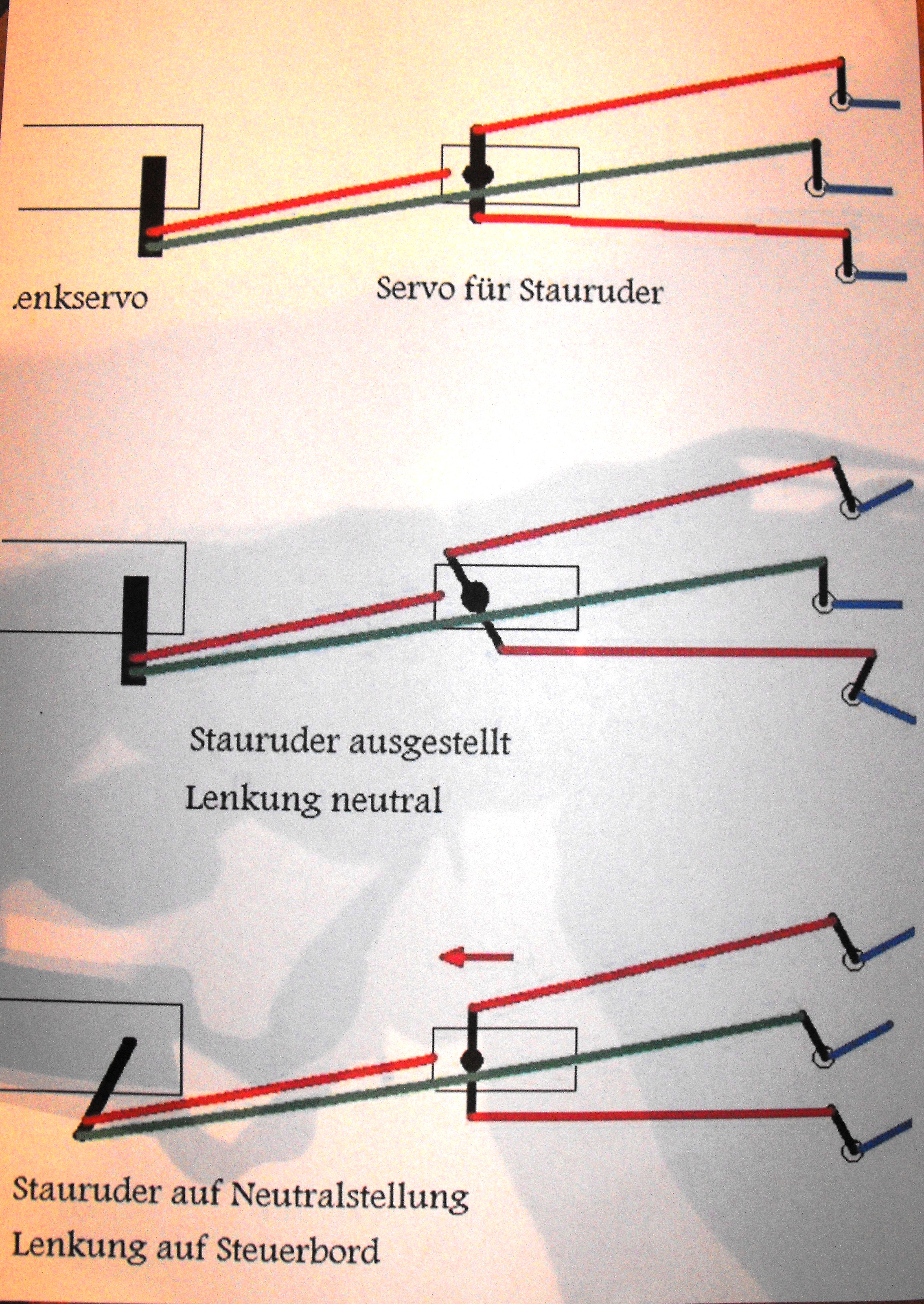

This is my latest contribution to the build, sorting out the rudder linkages so I could incorporate the 'Lurssen Efekt' . This was quite challenging, but after making a plasticard mock up I think I have succeeded.
I needed to know the angles and lengths of the linkages prior to cutting/gluing etc., as I wanted to construct a removable module as with the motors.
