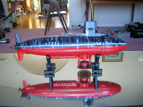

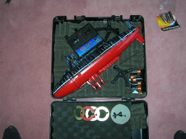

Old 03-27-2008 | 01:30 AM
  #88
Joined: Mar 2005
Posts: 23
From: St. Francois Xavier, MB, CANADA
Default RE: nikko seawolf
Just thought you might like to see my Seawolf with a few mods.
The neatest thing about this sub is the carrying case I adapted so it could travel on airlines and be safe. This has done a lot of miles and survived without a scratch on my quickly done paint job.
My main complaint with the Nikko subs has always been poor radio range right out of the box. After talking with a nice tech at Nikko, he says what I get is about all they are capable of ... about 50 to 60 ft on the surface and much less in a pool. I'm not able to get more than a few feet away in the heavily clorinated public pool where I went on vacation. I'll be selling this one and finishing my static diver.
The only other thing that was a problem last year was a broken main drive shaft magnetic coupling cup. I made the mistake of letting somebody else run it and he enjoyed doing panic stops a little too much and cracked the cup. Nikko were very good about supplying spare parts and I've now also got a spare prop on the shelf just in case.
Although this "pool toy" has been fun and taught me a lot, I've decided to go with a conventional radio system and a different sub for next sub season.
Lee
