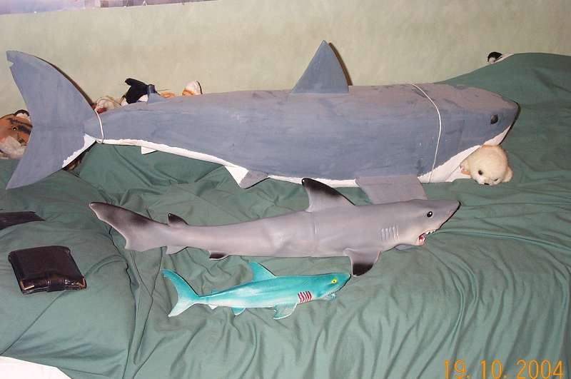

I was looking at the big static model shark that I built a few years ago, and I was wondering whether it would be possibly to build a similar-sized model from balsa/ply, BUT instead of plank-on-frame, I was thinking planks of balsa butt-joined together (with another piece of wood glued into the corners for strength), then sanded to shape, liberally covered in perhaps varnish or fibreglass resin, and finally painted.
What do you guys think?
(Remember, it's just an idea! )

I'm aiming for a model about 45" long (same size as the big shark in the pic), that will be about 7" deep/6" across.
In what way will the building of it be complicated?

Daz',
I don't see why building the Shark out of wood wouldn't be possible. It might be more trouble, water proofing the insides as well as the outside, but certainly 'do-able'. If it's going to be a 'dry' hull you'll have to give some thought to the internal bracing (more required than for a 'wet' hull) and so it would be more complicated.
