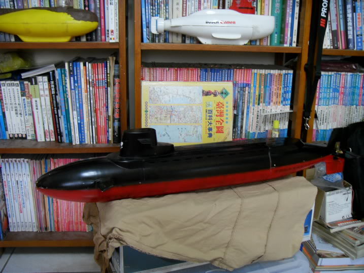

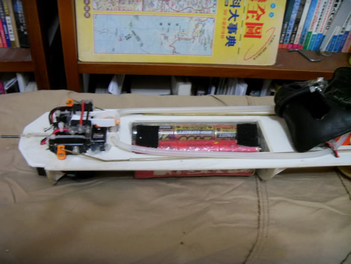

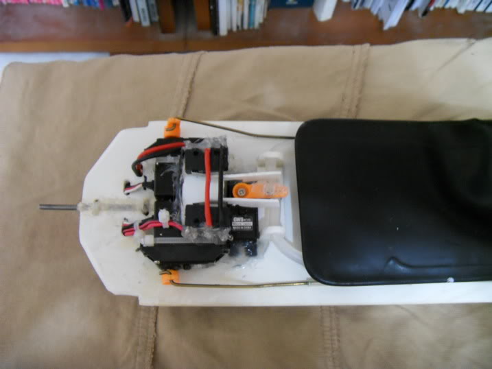

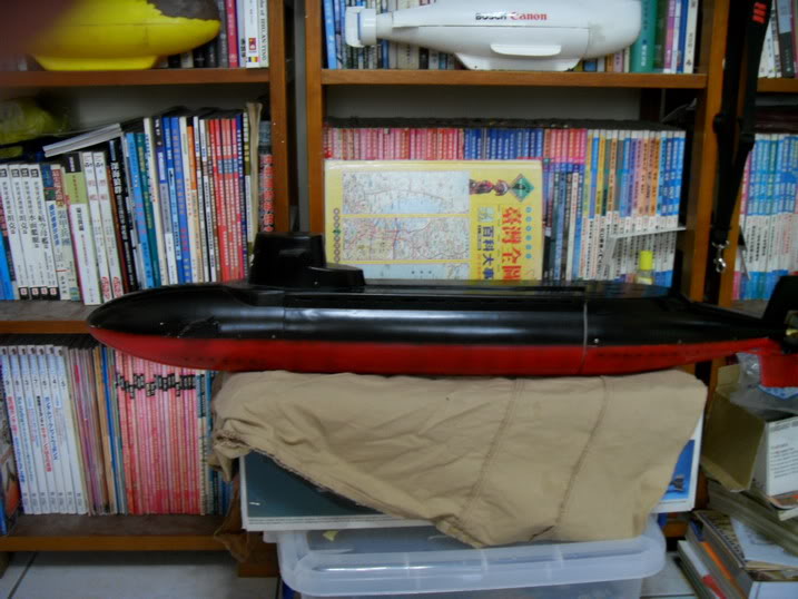

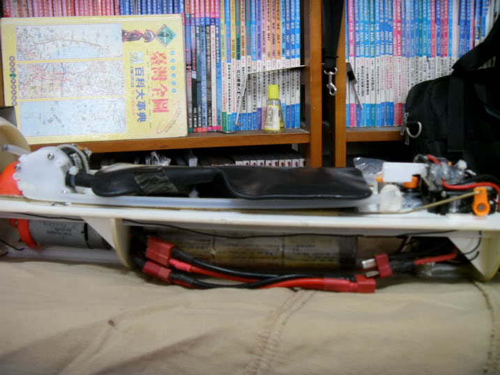

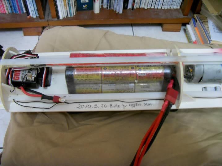

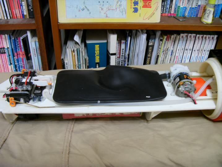

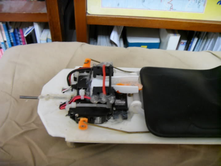

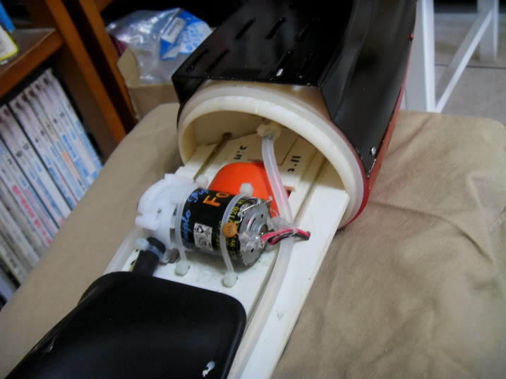

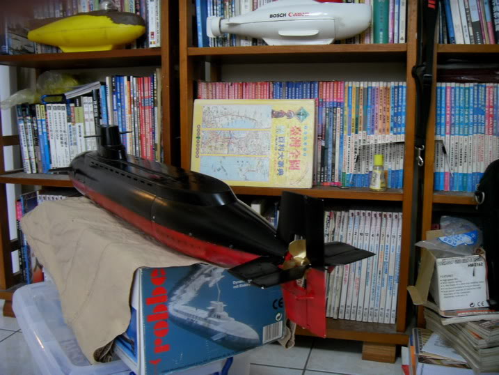

ROBBE seawolf built for my friend and he asked for more...
alright... why not make she a static diver
just useing a gear pump and a rubber water bag ??
yes .......that's the way we go...........

Fantastic.
I like your pump switch
Where did you get the bag ?
Old 08-02-2010 | 07:24 AM
Joined: May 2010
Posts: 7
From: , TAIWAN
Default RE: ROBBE seawolf V2 with static dive
ORIGINAL: SJN
Fantastic.
thank you for your nice words
that's where I got my bag
http://goods.ruten.com.tw/item/show?21005114387631
and the Mick's Subworks also provide the bag
http://www.mikessubworks.com/page1.html

What size bag did you use for the sub?
100ml (8oz)
250ml (20oz)
500ml (40oz)
Old 08-12-2010 | 02:17 AM
Joined: May 2010
Posts: 7
From: , TAIWAN
<font color="#ff0000"><font color="Black">bag size
18cm*8.5cm</font></font>
Where did you get the smaller subs on the shelfs?Neat looking.
Dave

ORIGINAL: AQUASUB
Dave
that's my scartch build mini sub
Xin

Hello, recent I also brought the seawolf and would like to use your method to make it static dive. But, I have a queston, when keep pumping the water inside, how did you know the water bag is fill full of water?? Because you don't know the bag is full as the hull is sealed you can't see it. If keep pumping the water inside, the bag may explose if full. So, is it necessary to add an auto-cutoff switch which to stop the water pump motor when the bag is full of water or anyother method to avoid this problem???
Regards, Andrew
ORIGINAL: epg800
Old 04-03-2012 | 07:09 AM
Joined: May 2010
Posts: 7
From: , TAIWAN
yes ....the limit switch is necessary for safety
since you can't see the bag inside the WTC but yu can see the submarine from water line
when she is diving I just take her to the periscope depth never goes too deep
best regards
