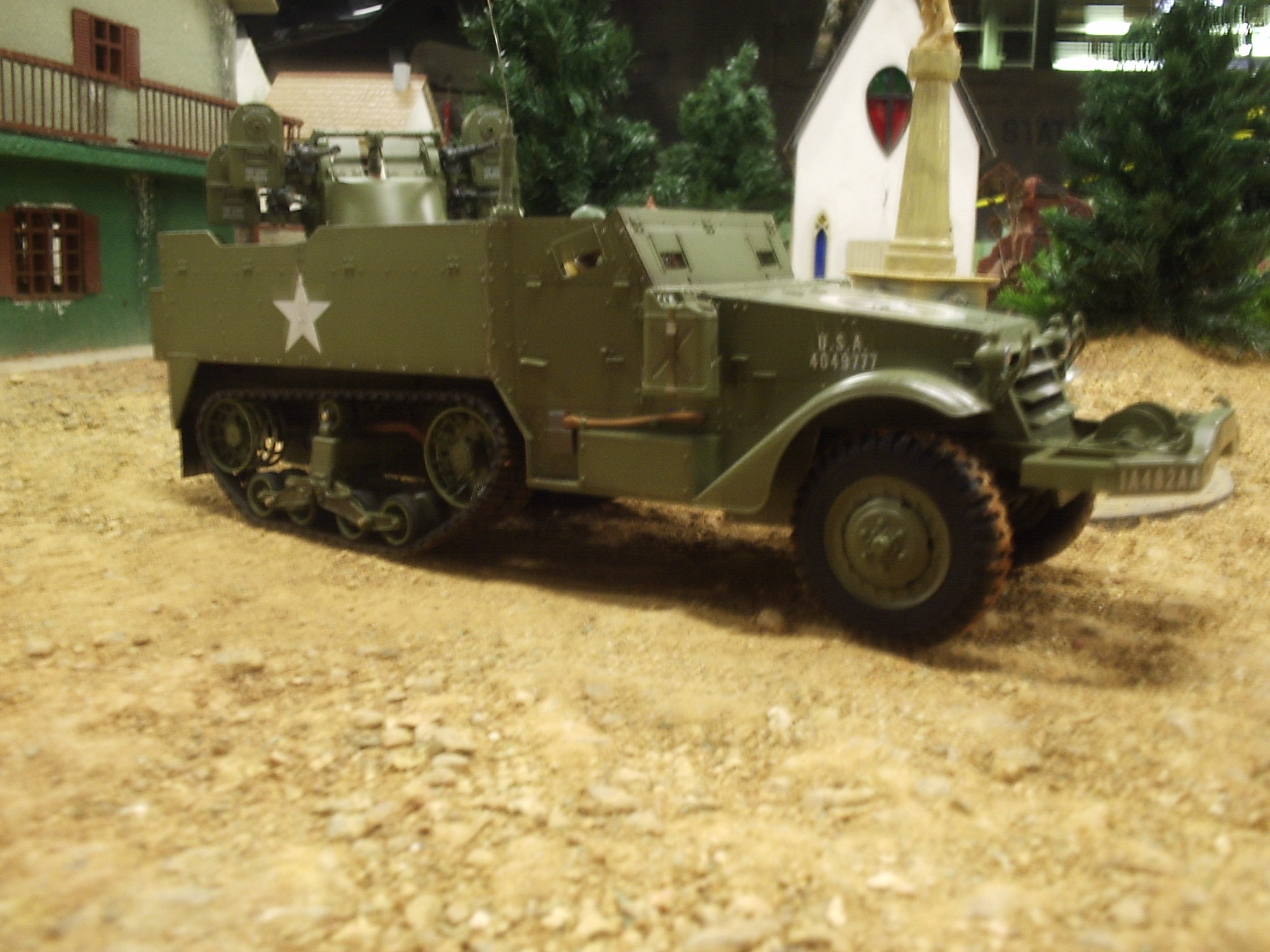

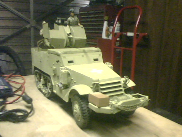

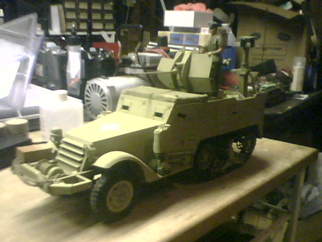

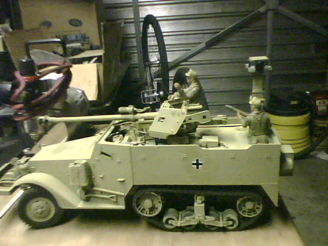

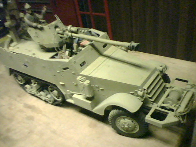

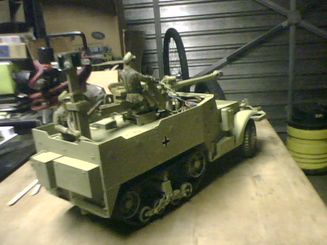

Hello all,
Well just for fun and annoyance I decided to play around with adding El-Mod electronics to the WSN M16 Quad Gun-motor carrage(read that halftrack)
1st tests done with the El-mod x22 electronics unit(the one for armored cars) were so cool.
I started kicking around the idea about maybe going ahead and using a full El-Mod Tank setup.
Well I did and it works in fact better than I had hoped.
So here is the run down...
Full functionally including combat ready, full EL-Mod sound.
Headlights, Brake lights.
the choice of weapon was an issue for a while though, so was decided that would go with a TD format first, that said I borrowed the 75mm
PAK40 from my german halftrack project and used it for the 1st unit. (planning a servo recoil for the 75)
And we have success, I'm sure there will be some issues with game play, but seeing it running on the field mite make up for any issues.
Because of limitations in the electronics I have set the Halftrack as a medium as this keeps the rate of fire to a reasonable level
I'm working on version2 which I hope will "clean-up" some of the grey areas.
Still working out the use of the quad 50s....or maybe a flak38
I plan to post some pictures soon as I can get some taken.

Well I have not seen a 16th scale French 75' or a russian 76 for that matter an I havent the skills to make my own, so I did the next best thing ...
Here's some pictures.
Enjoy

Cool, captured is the key. Works and looks great. We also gave a bunch to Russia on lend-lease...M-2s with 57mms.

That is a fine looking captured M16. Really looking forward to a "how to" photo report on the next one you build.
I did this realitively stock M16 for a nephew's 9th birthday gift this past summer. The vehicle's name is authentic to the era and seems to fit too. He really liked the rare "Dragon" soldiers I included and the best part for me was that I got a war toy past his mom. LOL.
Have you tried the HLPz3 plastic track modification yet for outdoor running, and if so did it work?

What happend to the OD and Howitzer
Looks cool, cant wait to see it run.

well if anyone can locate a suitible Howitzer in 16th scale I'm all ears..lol
I figure the pak40 sans muzzle break and some other accessories can pass for the Russian at guns, though I'd bet that a pak40 or 2 was used in a pinch,
nobody will really know for certin.[8D]

Nice looking model, but after 100 rounds out each gun, you will no longer see the target.[&:] Those rags around the barrels will catch fire, obscure vision and mark your location. Rags on the barrels have no purpose other than to start a fire. [:@]

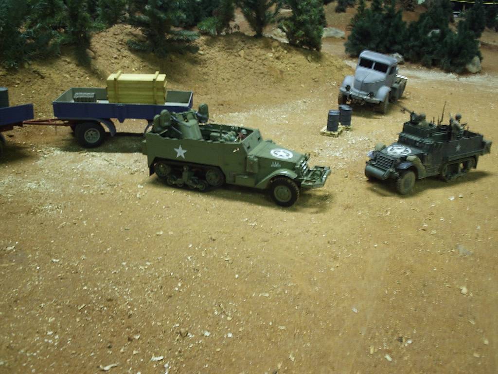

ORIGINAL: Detroit Diesel Man
How do the halftracks drive....pretty good? I actually debated about getting one before I vought the bulldog i have....still would like to have one...I'm a US Armor guy all the way.....Thanks..Great Pics!
DDM
They are a very good deal for the money. I have a few and they are worthwhile. Even though they are ALL on the same damn frquency. The radio range is very limited to about 30 feet indoors and 50 outside. The model is fairly accurate and drives well. I removed the rear mud flaps 2 min after running it, since they were hard plastic and were like anchors in the snow. The winch is cut off of mine now and will be replaced with a roller for the hilly terrain of Danville. The M16 drives very well but the joysticks are toylike and the configuration for driving and the controlling the gun mounts is awkward. I mounted my video camera in the gun mount so I could pan and tilt it freely to capture some action on the battlefield. The mounts move quickly and since the M16 is very light it is bouncy fpr the camera. The front axle is not powered but that short-coming doesn't mean that it gets stuck easily. The two figures are very, very nicely detailed (one is holding a cigarettte) and worth at least $20 each in and of themselves. I am also converting one to IR battle and hope to have it ready for our next winter NEAD battle-day here in NJ.
I did make some video during my last trip to Danville and I just posted it on youtube.
I have NO time for editing so take it in stride. Here is a link: http://www.youtube.com/user/thecommandernj?feature=mhum
