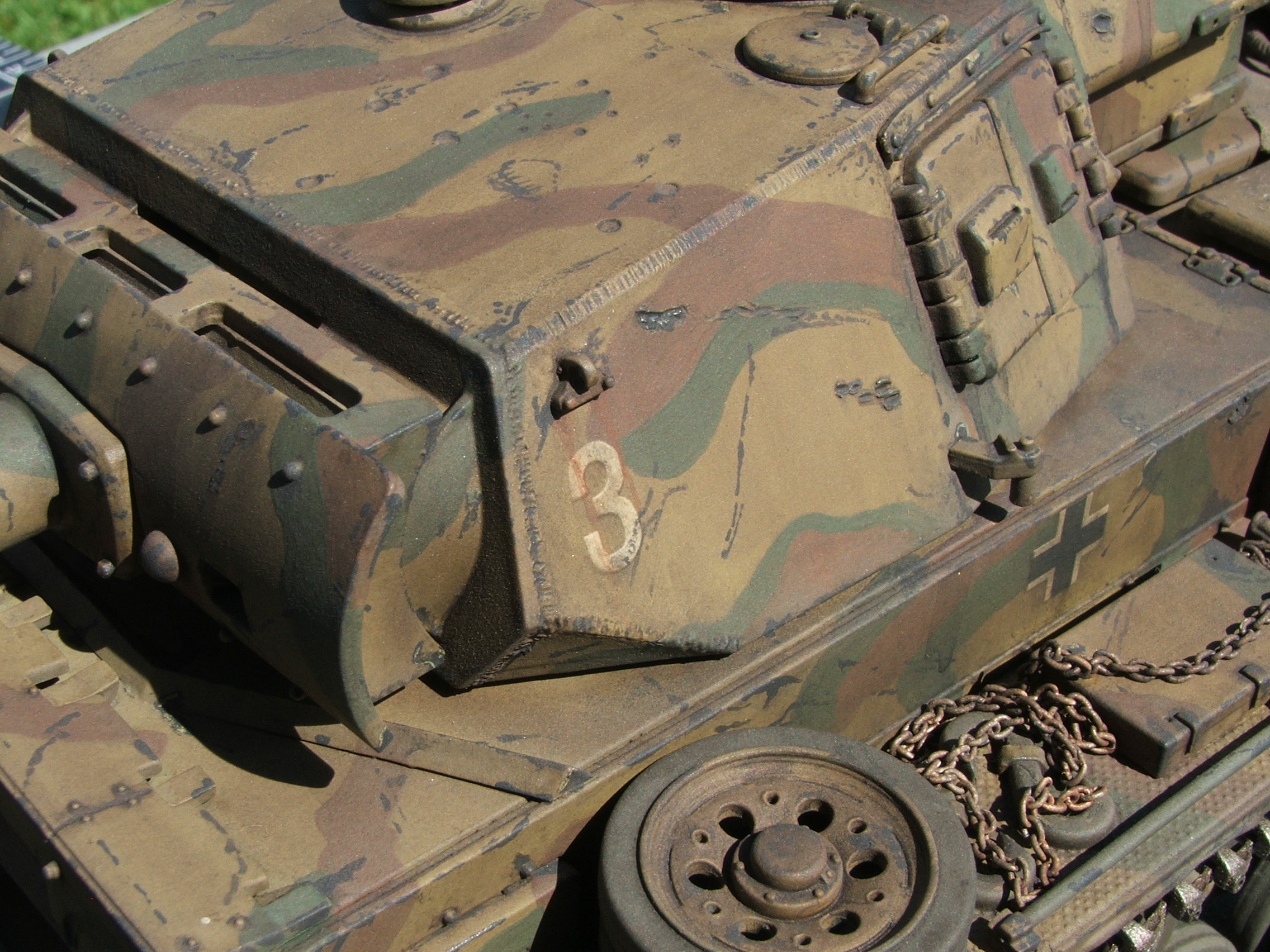

Time to add weld lines to the Panther G, I have a new tube of modelers putty, but need someone to inform me on how to apply it properly...
Thanks in advance!
John</p>

Well, I have found the thing that works best for me is the apply miliput and use a pin or modeling pick to scrbe the weld lines into it. Search the forums and you will find a number of how to articles on welds.

Do your self a favor and buy a small book on the different types of weld "Beads", There are several different types used in welding a tank together. The most common mistake modelers make is trying too make what would be a huge weld in real scale look like one pass of weld. this is not correct. Very large welds which is what you will be modeling usually require multiple passes called "Beads" a series on narrow welds built on top of each other. This prevents the base metal from over heating and possibly having the weld crack.  Lay the putty i the seem and take a pin and drag a series of lines in the putty. Then smooth them slight;ly with a wet finger. It should look like a bunch of stripes, NOT one BIG Weaved weld.

I use a screwdriver heated into a candle a very effective system look real and is not messy at all

you can use mutiple welds, you just have to use a bigger screwdriver , you can made the screwdriver lips fit your welds, most of the screwdrivers are so cheap and are used for adding my welds on my tanks, very tiny exemples.

a few fotos of welds added with heathed screwdriver
