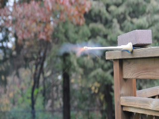

OK. The Tamiya KT build, from basic to advanced, parts, upgrades, suppliers, etc etc have been well covered already, so I won't duplicate posting that kind of info. as I first thought would be useful. I'll post my build progress with pics even tho it will likely be very repetitious. The "big box" is being delivered tomorrow by Fedex. Only two days from ordering at Rare Plastic Hobby - pretty quick. I'll be tearing into that right away.
Here's a vid clip of a Tiger I gun blast produced with a simple nichrome firing mechanism and a very small black powder charge. This is the same approach I use on the 18 firing guns on my 1/24 scale R/C ship model Syren.
The barrel is brass tubing, the muzzle brake is the stock HL plastic part. The barrel is wedged in the tiger's metal tracks for this demo setup. The blast produces little heat - the plastic muzzle brake is safe. No projectile is, or can be, used with this setup.
A very small BP charge wrapped into flash paper cartridge is used. The cartridges are pre-made and easily slipped into the tip of the barrel - into a chamber only about 1" deep. There is only slight kick/recoil.
A nichrome heater wire at the back of the chamber ignites the charge. Instead of flashing the blast LED, the wires will be used to ignite the charge and the recoil mechanism timing should be about right with the ignition. This will likely be the system I install in the KT barrel.

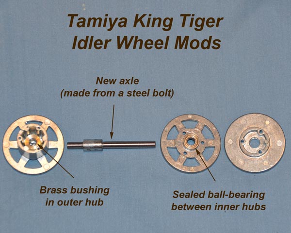

To your question of the modified axes - yes that is necessary - but if you do not get to much weight on your Tiger (mine has 5 kg) Axels solution is good enough - if you want to have near to 10 kg you should use the wecohe system - but it is to expensive for that what you get - and - not original like Axels (shumo) system.

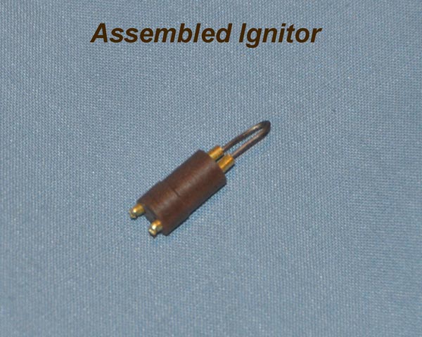

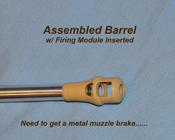

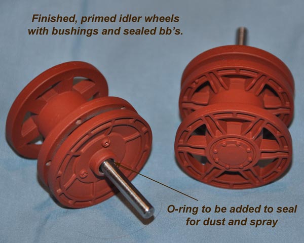

Started construction on this beautiful kit and ordered the first round of mechanical upgrades. Focusing on improving the bearings in the idlers and on an idler tensioning system. I have a small lathe, etc, so I'm making the suspension mod's myself - more on those later.
Attached is the info on progress so far on the firing gun system. Plenty of smoke and a good bang. Drawback is that it's a single shot system, but it is very easy to reload. The clip shows a test setup. To fire the gun is simple - work yet to do on how to integrate the recoil effect, etc.
DO NOT try this. This design is very dangerous until you know the precautions and exact material and loading details. Only a VERY small amt of BP is used. DO NOT use a firecracker - it WILL blow the barrel apart.

The road wheels have some nice bushings, but the idlers that take a lot of load don't have bushings or bearings, just the steel axle riding on the cast metal surfaces. So I added brass bushings and sealed ball bearings. Also made up a new axle profiled for the added bearings.
Interesting and new stuff you are showing here. Like the black powder effect.
