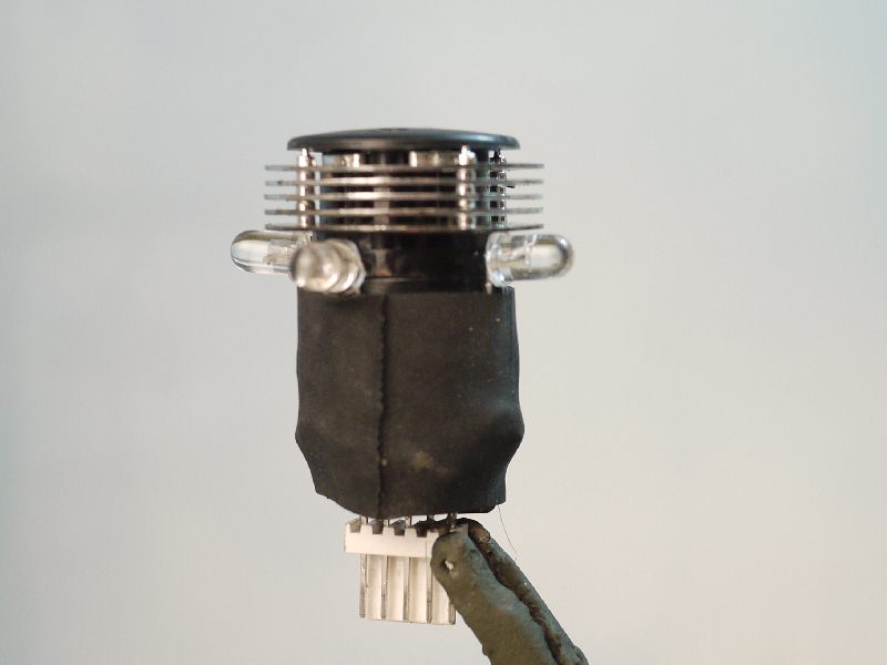

I am finally happy with my kitbashed TBU's.
I take a Heng Long DBU, and replace the IR sensor with a 38K one to make it Tamiya compatible. I then added an LED circuit to it as well, with 4 bright red LEDs, one resister and a capacitor, a little soldering and a rubber sleeve made from a bike inner tube.
I now have a low cost IR sensor with a factory look about it. Here is what it looks like. I never took progess photos as I wasn't sure it would work out or not. Now that it has, next time I do this mod I will take progress photos.
All in there is the cost of the HL sensor + about $4.00 worth of other stuff.

Perry
The IR sensor in a Heng Long is focused at detecting a different Frequency then the DBC or Tamiya. IF you buy one of Davids DBU kits you have four IR sensors that can be used in this conversion. The HBU(Heng Long battle unit) has a mirror assembly like Tamiya and only needs one IR sensor per unit. You take out the Heng Long Sensor and install one of David's in it's place. The pin out is different though so you have to make sure you get the pins on the sensor where they need to go. Using Davids DBU instructions you can figure out which pin is which.

This will work well with Tamiya and David's DBC. However it will not work with the Stock Heng Long system because of the different IR frequencies involved.
I have never tired changing the IR sensor in a Stock Heng Long system to see if that would make it compatible with Tamiya. I think David tried it but the info packet sent in the IR beams must be different because I believe he had no luck with the Heng Long picking up the Tamiya signals.

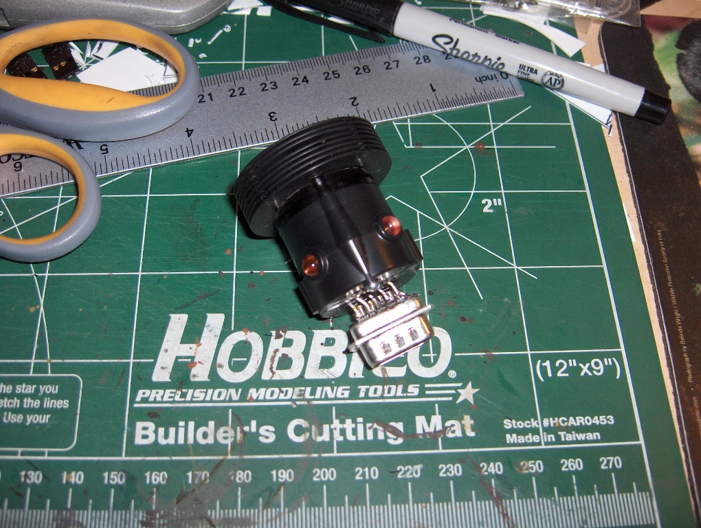

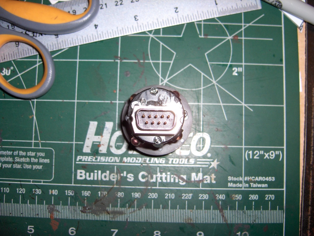

When the Detroit club did some testing (in a borrowed school gym - nice and level, and no sunlight) last winter, we found that the style of baffling that Phil @ rctankwars was putting on his newer DBU's tended to limit the effective range that the DBU could be hit from. Our club standard was agreed as being able to take a hit at the same range as your tank could shoot (~70ft for the IR LED's Phil supplies). Phil's current design was not able to do that on all sides with the 2 examples we tested - where the dozen or so examples of his original style (which Phil kept making specially for me ) with wider baffles and bigger windows for the sensors were able to be hit reliably by a Tamiya tank at 80ft and a DBCRC2 at 60ft on all sides. On the down side I do tend to get shot up rather easily at close range with these... [&o]
So I believe both YHR and Panther G are correct: the DBU can certainly be more sensitive than the TBU, but by trying to make the DBU behave like a TBU at a certain range and/or angle it is very difficult to do so without making it less sensitive in other situations.
I also tried the HBU with a DBU sensor inside, the problem I found was that it very sensitive to the positioning of the sensor under the prism. Get it a little off center and we found it will bias the sensitivity to one side at the expense of the others. We also found when you did find the side that was most sensitive, it was good for 40ft but wouldn't take a hit at 60ft. I suspect as somebody pointed out, this may well be due to the HBU prism being as 'rough as a Badgers bottom'...
The solution I am currently testing is a TBU mounted on a 9pin sub D connector and plugged direct into Phil's DBU socket - you can wire the TBU socket direct to the DBC board, but as I have a lot of DBC/RC2 equipped tank's already this seemed like a better idea [8D].
The pin out is the same order as the socket Phil supplies, just make sure you get it the right way around [X(] The 5V feed for the IR sensor is on the left in the pic, the +ve connection for the LED on the right. Also be sure to leave enough of the pins on there so that you can push the socket over to a more central location, otherwise you'll struggle to plug it into a Panzer III/IV cupola [:@].
So far it seems to work, but I have had both of the DBCRC2 tanks I tested with it glitch on me after a while. In my experience the DBCRC2 tends to be sensitive to dry joints and bad connections, and I heard from Tankhobby that the TBU is also somewhat noisy electrically - so this could be the problem. I also have only one TBU converted, so there might be some thing out of spec here, altho it did work without problems in a DBC equipped tank? Does anyone else here have any experience of this?
I'll do some more testing in a couple of weeks hopefully and update if I find anything new [8D]
HTH,
Mart

I use a 5 pin socket as shown in the picture. The Tamiya sensor uses the same pinout configuration. A TBU plugs directly into this with no issues, and as I mentioned earlier settles all club disputes. If someone doesn't like your kit bashed sensor, then just plug in a Tamiya sensor and stop all arguments.
On the flip side, these HBU hybrids don't cost much to make, 4 for the price of one Tamiya apple. So if you build these like I do, with a 5 inline pin arrangement, they are totally compatible with the Tamiya systems in use. The USB and the 9 pin arrangement work fine but it prevents easy swapability with the Tamiya product. I went with easy swapability and in my opinion that is important in the systems you build. If someone complains about one of my sensors I can take it off my tank and let them use it while I use a Tamiya, End of debate
