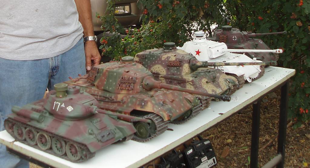

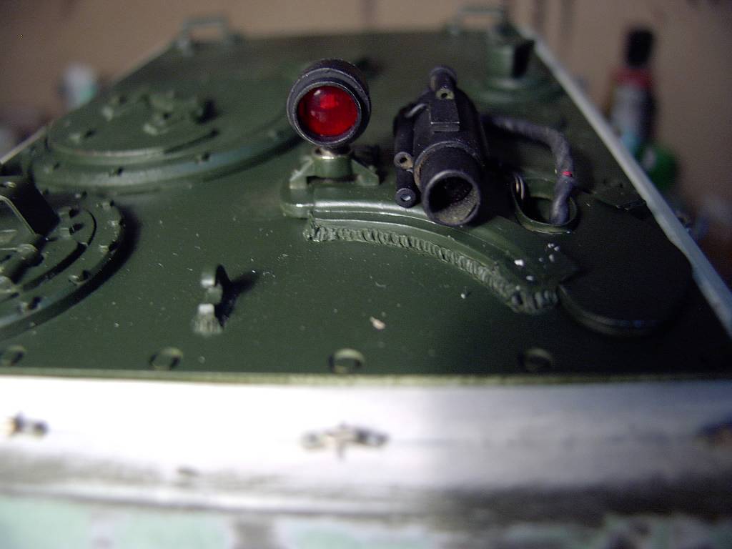

On a KT, I put mine in the right side of the mantlet where the MG normally goes. Here's a photo of T 34, 2 KT's, a Panther, and a Sherman, showing 4 different ways to do the emitter.
Or you can do what I did on the JT, build a fake night vision system and put the emitter in the system.
For the actual tube to mount the emitter in, you can use the DP19 or DP20 emitter tubes on the etoarmour sight.

Thanks Sevoblast That looks much better on the mantlet. can that be added after the completion of the barrel assembly "I HOPE"

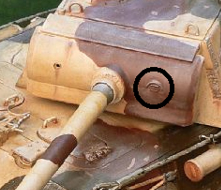

What I started doing on all my builds is including an IR socket in the mantlet. When not battling you remove it. This method also allows easy IR emitter replacement.
Here is a picture zoomed in to show the socket.

As you can see from my photos, I use a perminant (no one ever said I could spell) installation on mine. The tube is installed in to the mantlet as needed for position, and the emitter is then installed from inside. I use automotive 'rope sealer', a never hardening modeling clay like material, to hold the emitter in place. It will give if needs be, and if you need to remove the emitter, you can easily take it out. I use the same material to hold in the hull MG. If I hit something, the MG will give way without breaking anything. NAPA has it by the meter.
