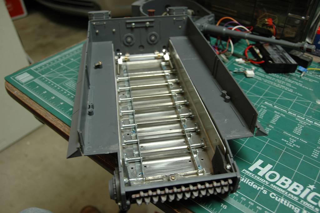

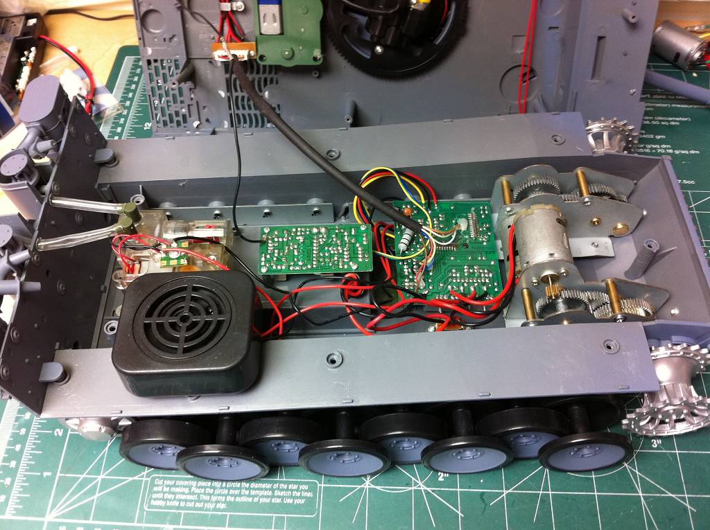

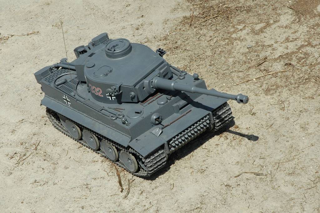

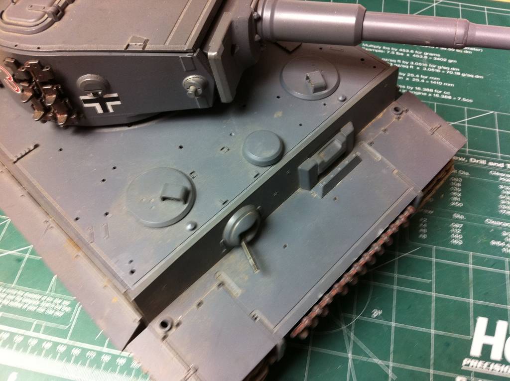

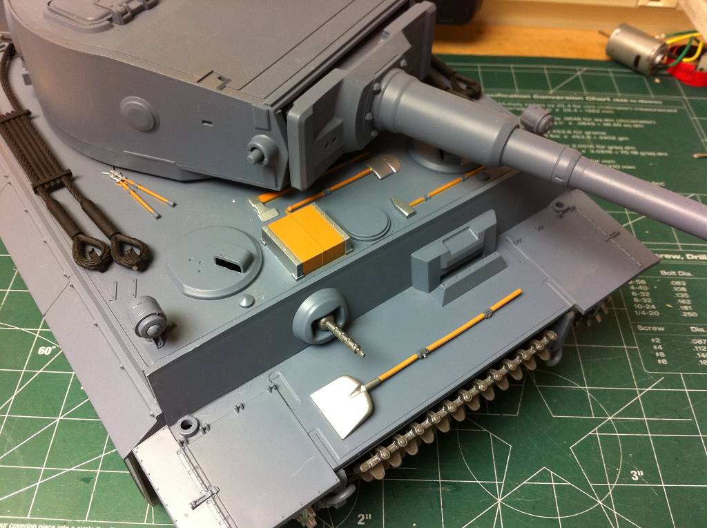

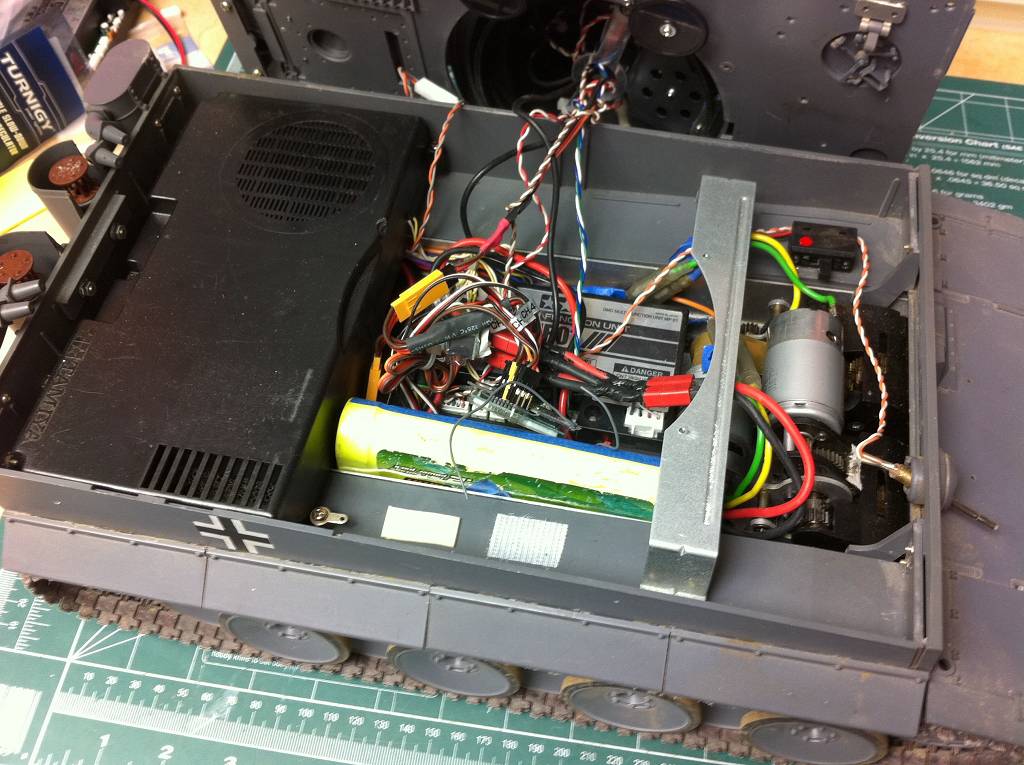

Attached are some picts - First is a stock HL Tiger I (S&S) Second is my 5 year old Tamiya Tiger I that is ready for a re-build all the deck items have been removed)
