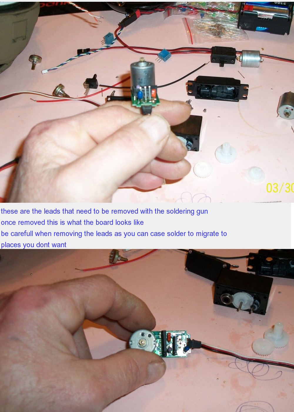

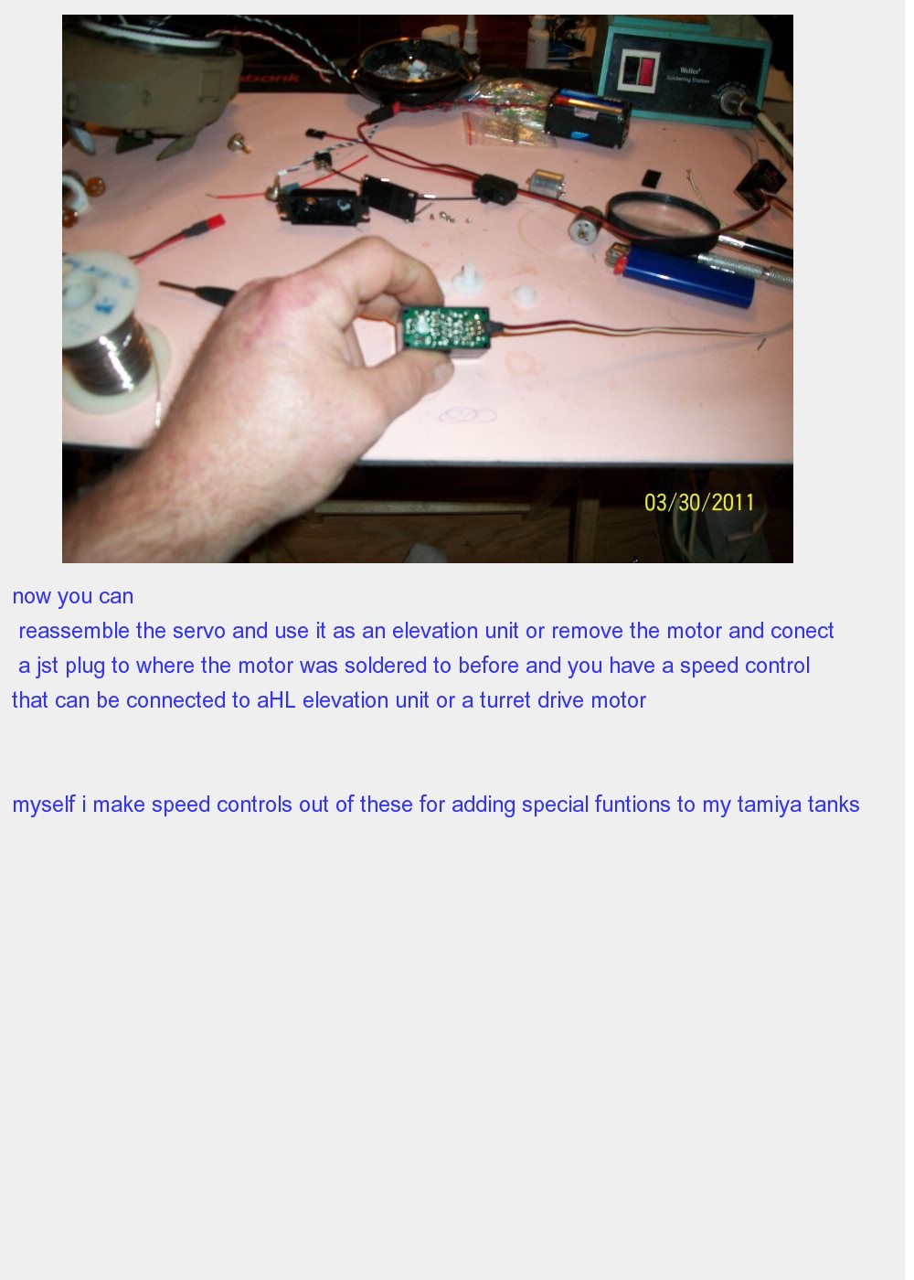

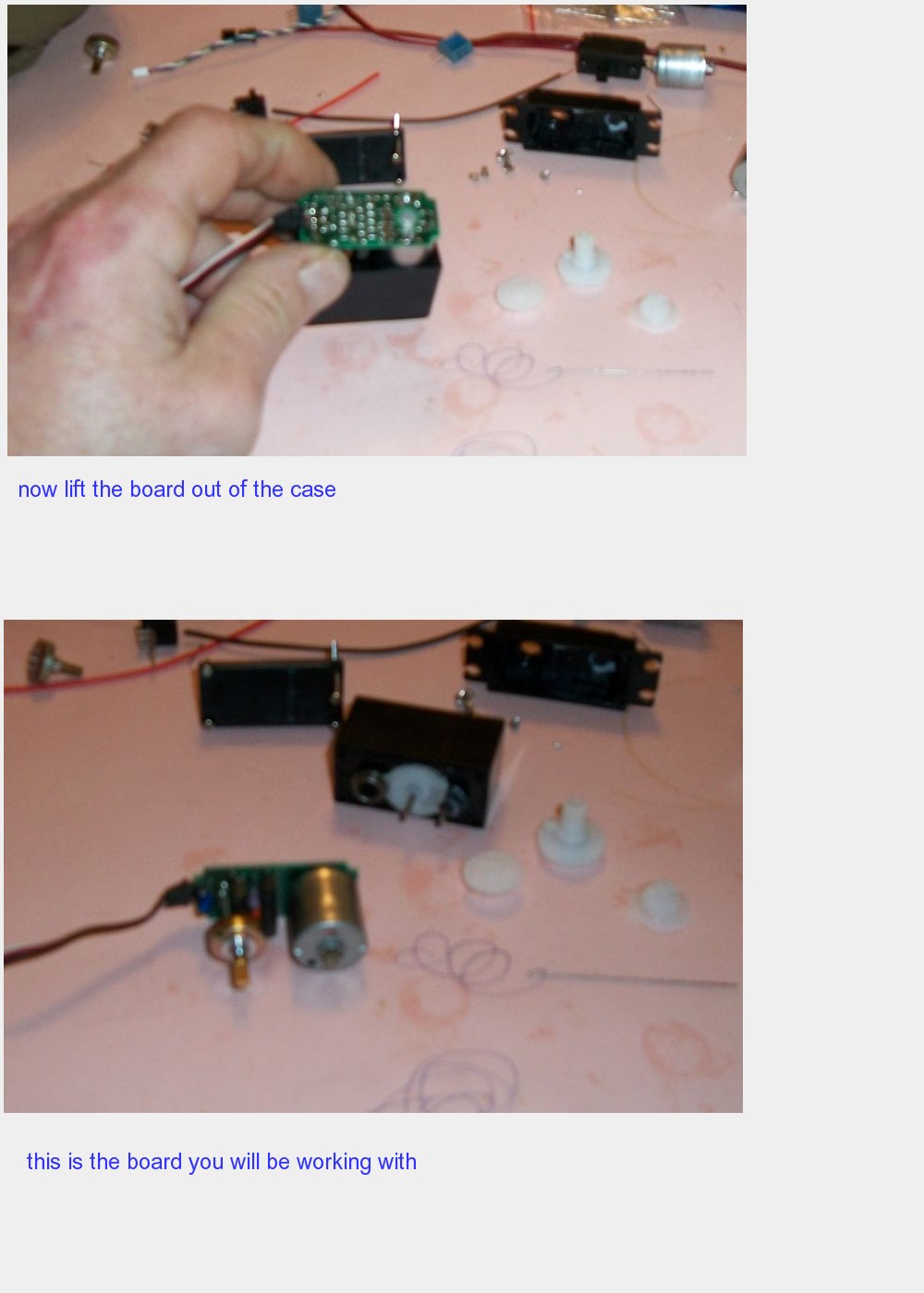

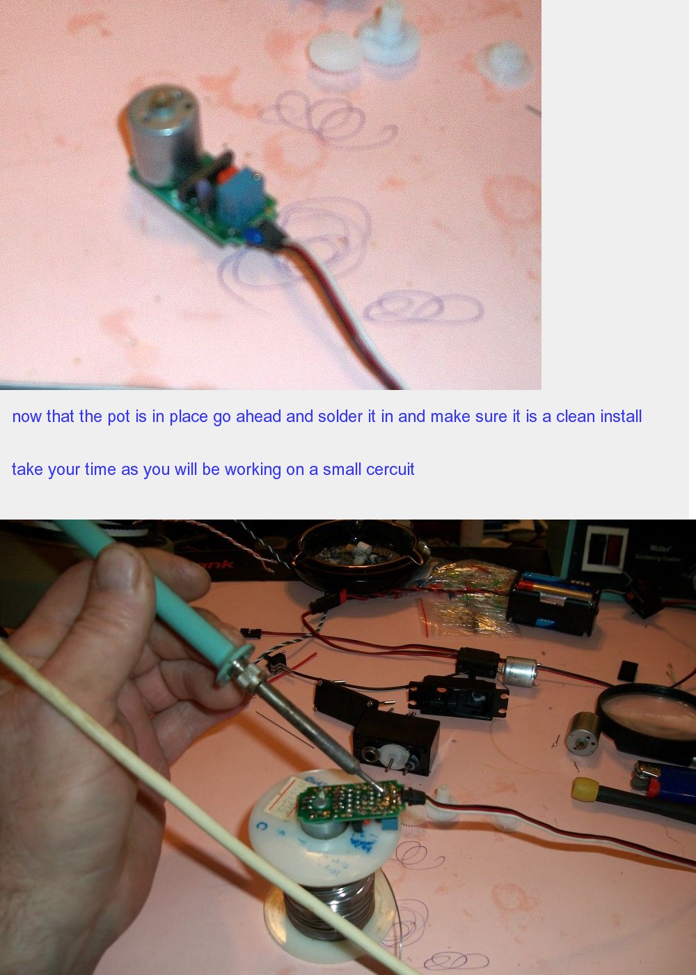

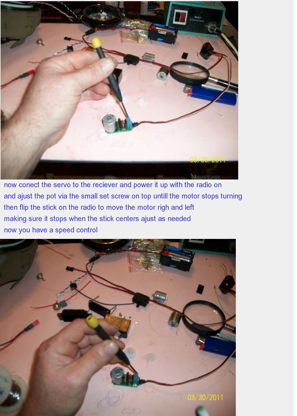

Here you go how to convert a servo to a speed control for tank add ons video to follow

this mod of a servo board has tons of uses . I have made radar towers gun placements that rotate on command radio controled buldozer all using modified servo speed controls

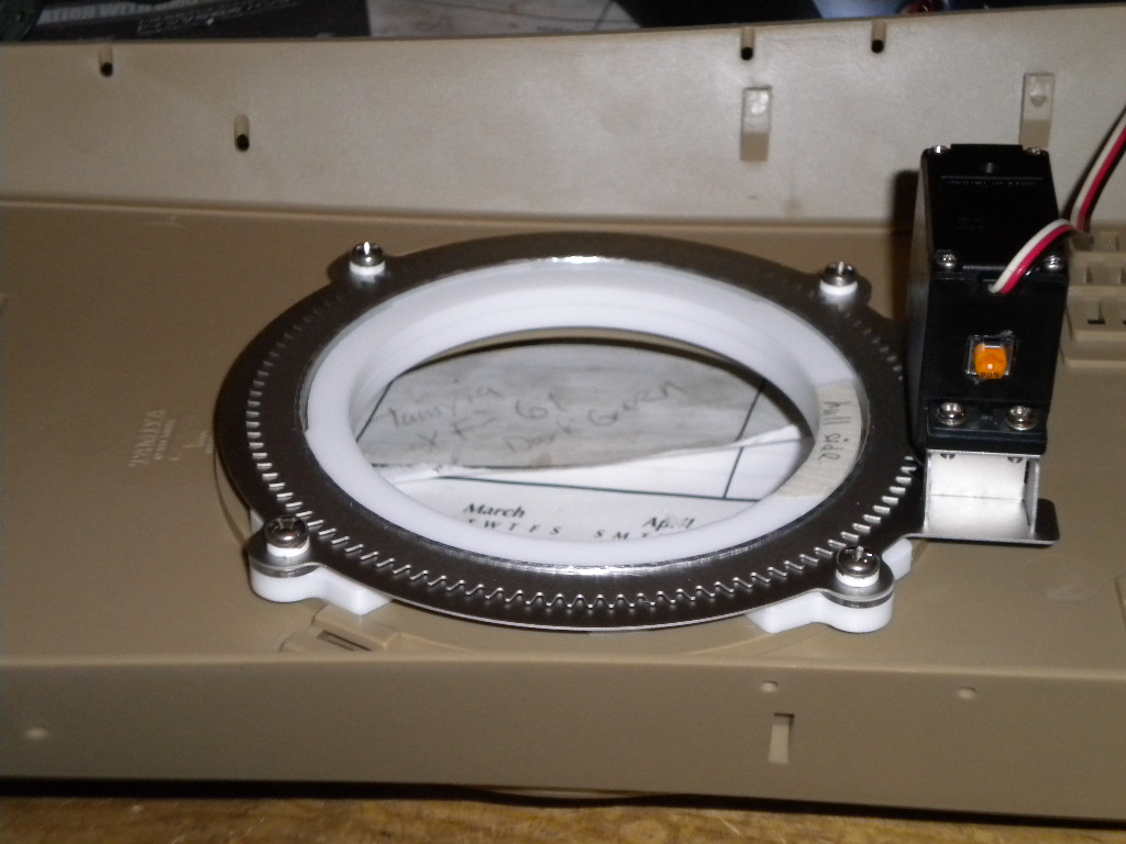

I removed the pc board from one and run a all metal turret system with it .
Jimmy

Where do you buy that pot and what brand it is?
Thanks!
Old 03-30-2011 | 05:24 PM
bubbajoexx's Avatar
Joined: Jul 2008
Posts: 803
From: toronto, ON, CANADA
Default RE: SERVO CONVERSION FOR TANK ADD ONS
It is a 20 turn 5K pot that you can get from any electronics supply house or on evil bay there are made in tiawan and china so they are cheep 1.25 each
Old 03-30-2011 | 05:51 PM
Joined: Nov 2010
Posts: 112
From: Carrollton, TX
ORIGINAL: bubbajoexx
I'm dumb. I can't find it on ebay. Gonna check radio shack tomorrow.
