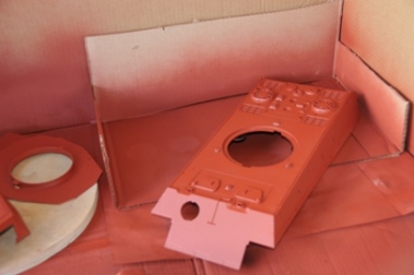

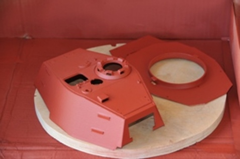

Hi, Ipurchased a can of"Red Oxide Primer" from my local hardware store in Brisbane, Australia. I sprayed the bottom hull of my Tamiya King Tiger first . It was out of a spray can. I then tested it on the plastic spare barrel, let it dry and checked for any problems but there was no reaction to the plastic at all. I have not had any problems with applying the top coats with my airbrush. see some sample photos of my KT build. If You want to see more photos go to the "hobby havoc " forum site, click onto Tamiya King Tigers.

When you (meaning anyone...) try some new technique, idea or an unknown paint, do a test spray on a piece from the parts tree. Or a part of the model that would be easily seen like the inside, bottom or battery door. Just my 2 cents. Good luck.

Thanks for that, but I have been building models for over 43 years now. I used the plastic barrel of the main gun as it was a spare and of no use due to the King Tiger coming with a metal barrel.
