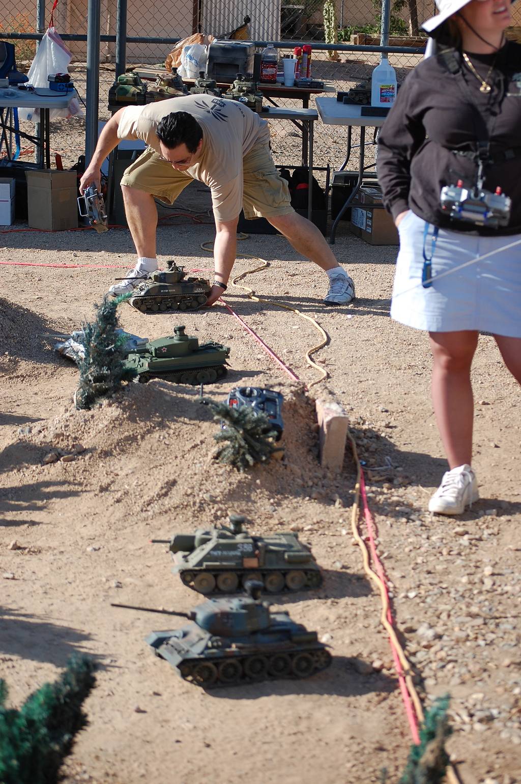

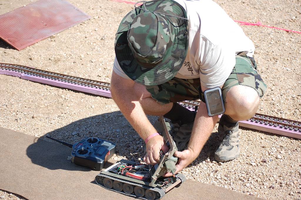

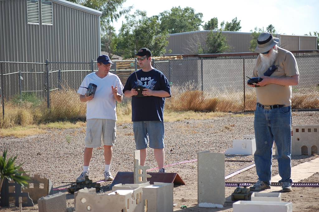

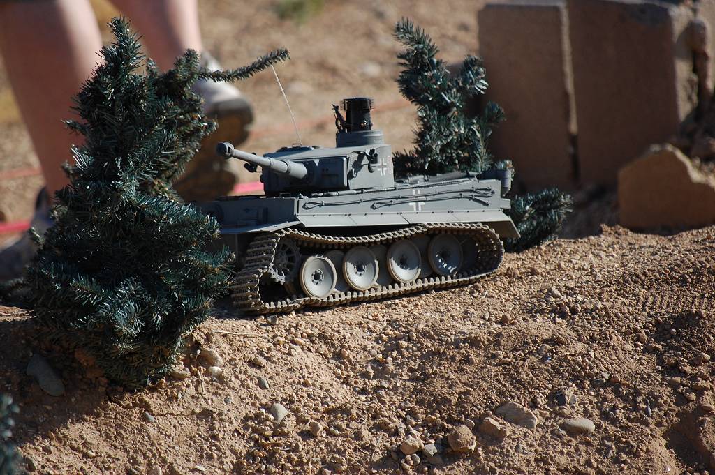

Pics coming along......
http://desertarmor.com/DAK_Events/DAK_EVENT_GALLERY/Pages/DAK_5-21-2011.html<br type="_moz" />

Default RE: DAK BEYOND DARKNESS
DANG!! You guys know how to feed the troops! Nice assortment of meat on the grill!!!
- Jeff
Panzer F, that's the real reason we all show up! If your tanks crap out on you, the Kitchen Battalion will always come through! =)

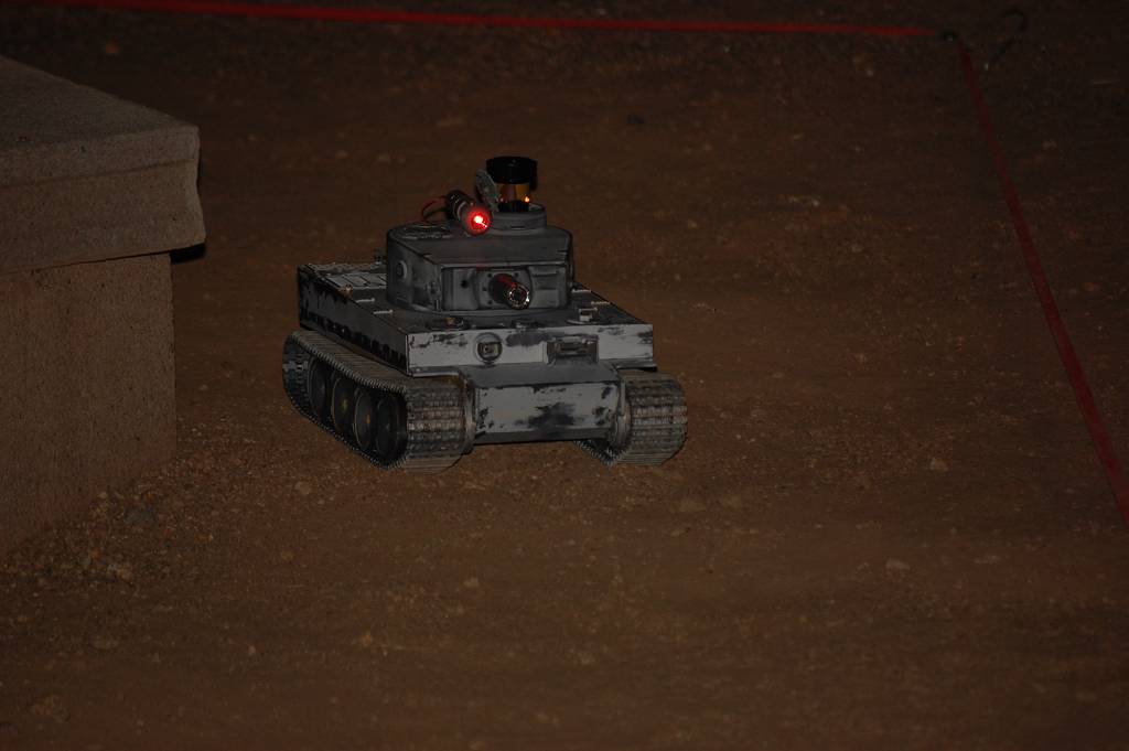

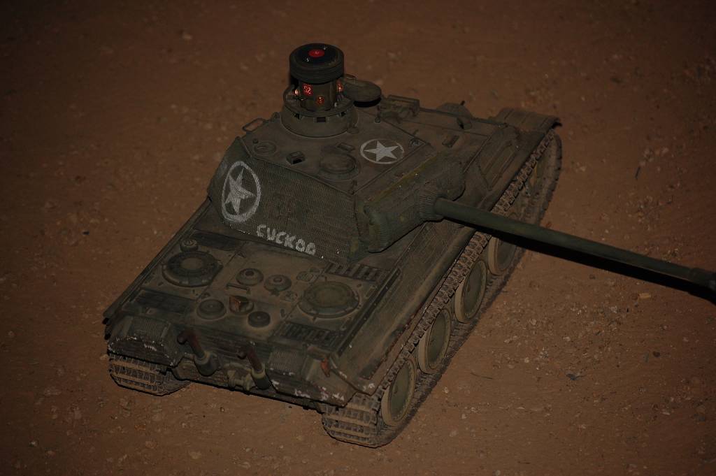

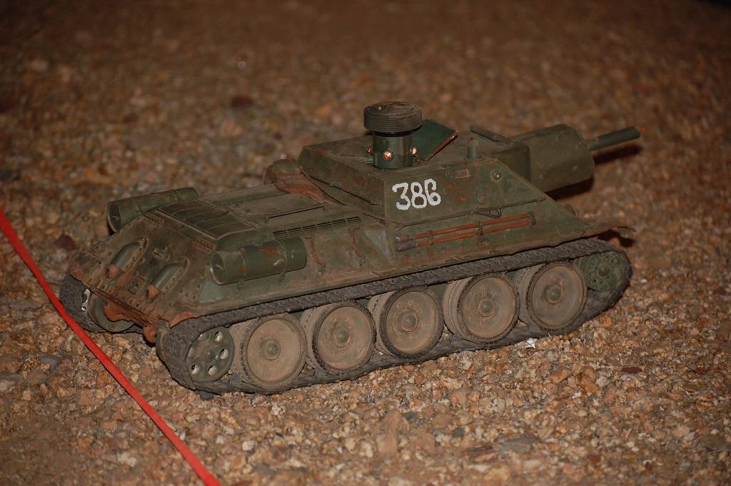

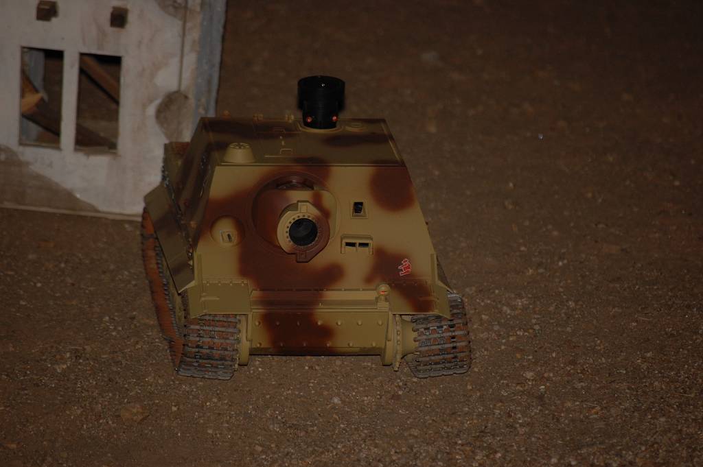

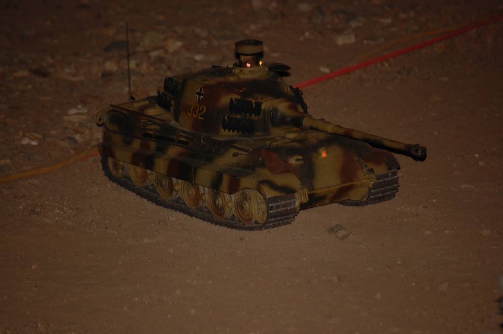

The nightside shots.....
