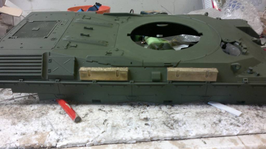

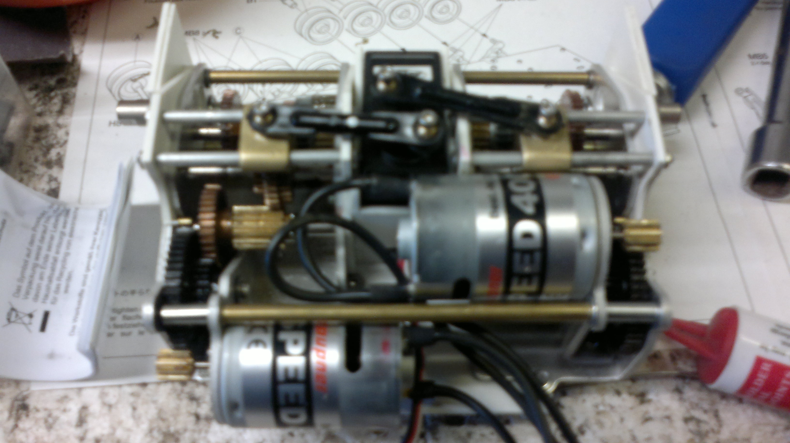

Now i have started a build of a danish Leopard 1 A3..It will be fitted with 2 speed transmissions from AFV, Graupner Speed 400 motors and elektronics from Elmod.

How does the 2 speed transmission work, servo shift? And you can go from overdrive to lower higher torque? I cannot wait to see & hear this in action.

First Blitz: it shifts by the servo between the two TUs...it got low, neutral and high...in low the speed is half of a standart Tamiya TU and in high it is the same...but I think it was to slow so I fitted it with Graupner 400 which are a bit faster than the standart motors...the neutral gear is for towing the tank in case of a "breakdown" ore pulling it up on my lowbed trailer I got for my truck...
It is possible to shift between the gears in motion but it is a bit hard on the TUs, so I see it as the low gear is for rough terrain and the high gear is for light terrain and road use...
As for the build it have suffed a long stand still, because of work. So there have not happend so much...it have been fitted with toolboxes on the side...like the real thing.

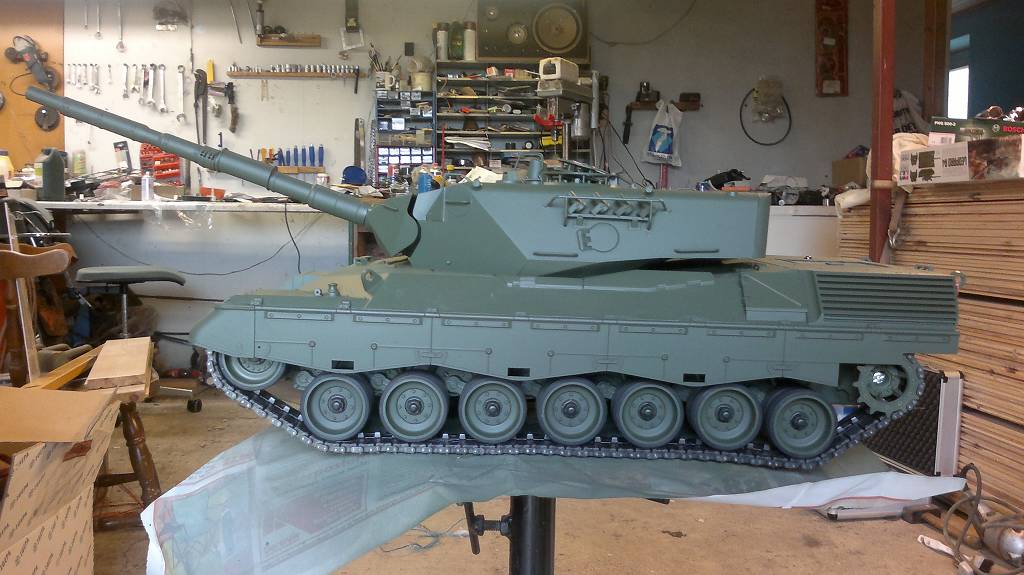

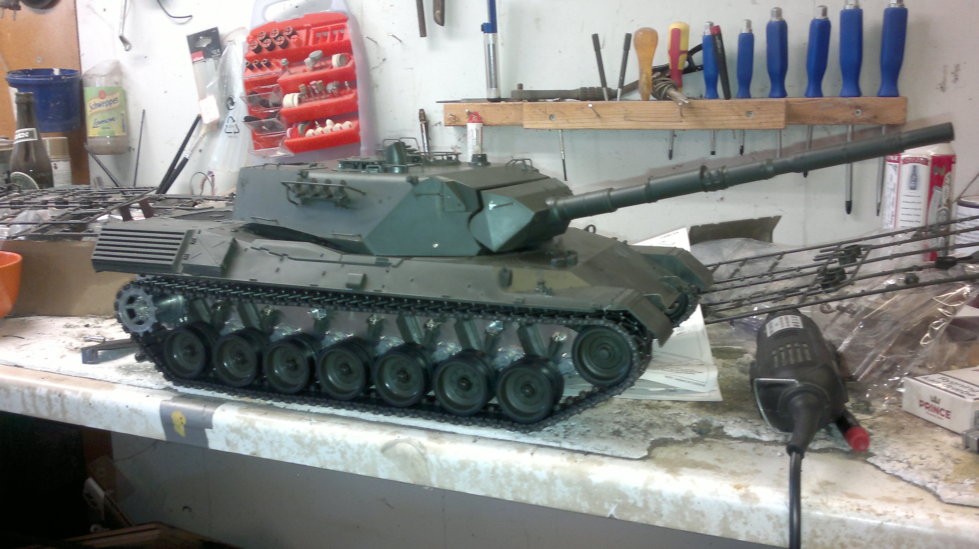

It got its base collour on...it look a bit greyish on the pic but it is NATO green...must be the light... ;-)
I also have cut off the rear part of the sideskirt, I don't really knows why that has been done on the danish Leos...maybe it is to make it easier to maintain the drive spocktets....
Now up for next is the cammo...but thats gonna be a while..because of my job going to take all of my time...

The tranny works fine, it is a bit noisy until it have been run a couple of times...I don't think it is wise to shift between gears in motion, it is possible but it dos'nt sound to good...as for the speed it is the same as a Sherman tranny when it is in second gear and first gear is the half of a Shermans speed...so the two-speed dos not make it faster but it gives alot of torque in first gear...what I have done is changed the motors to 6 volts Graupner speed 400 they make it run faster...I hav'nt messured out the road speed yet but I would say it about 5-6 mph...in second gear and 2½-3 mph in first gear...
I have thought of fitting it with Jamara 480HS Pro motors, they are longer but I think they can fit and they run at 22500 rpm instead of the speed 400s 17500 rpm, that would give the extra speed on road in second gear and still maintain great power for off-road use in first gear...

It was tight but the Jamaras fitted in the TUs, I have just tried them out on the floor of my workshop and it looks like they gave the Leo the last kick now it runs with a good road-speed in second gear and still have alot of power for off-road use in first gear... :-)
