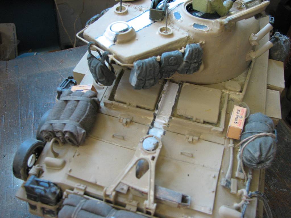

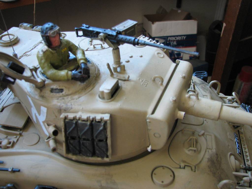

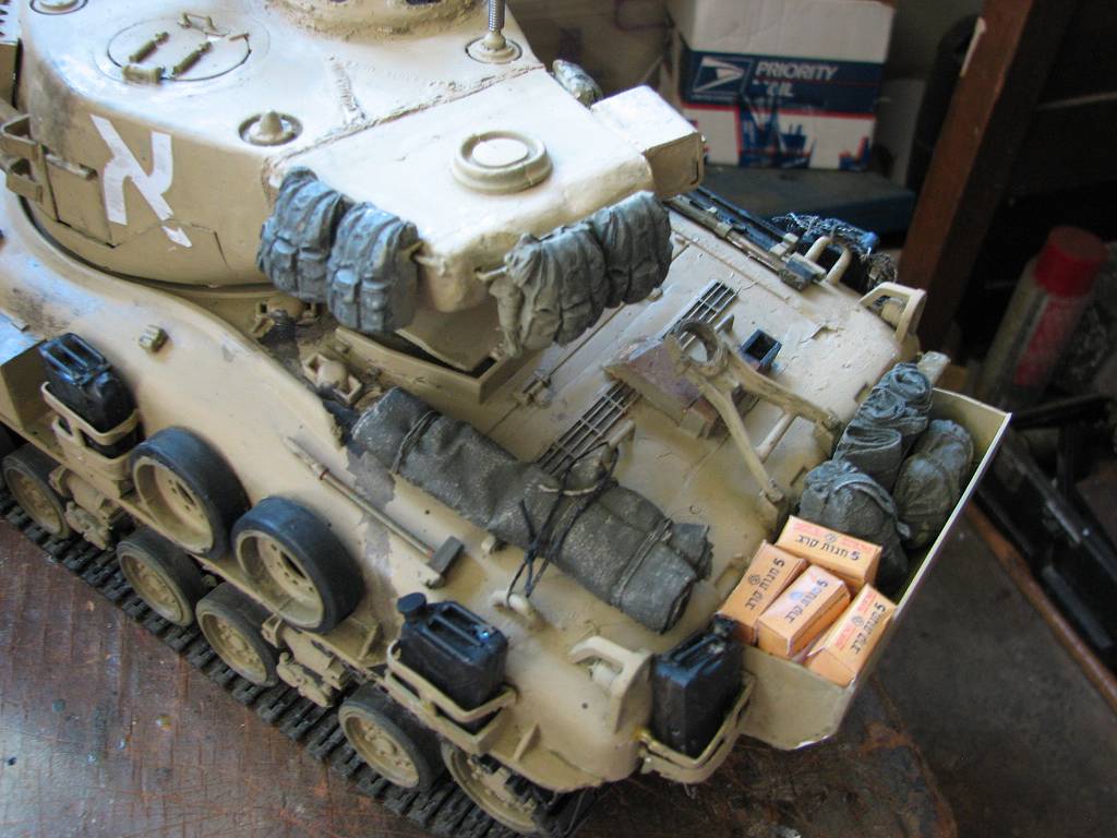

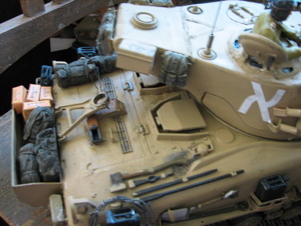

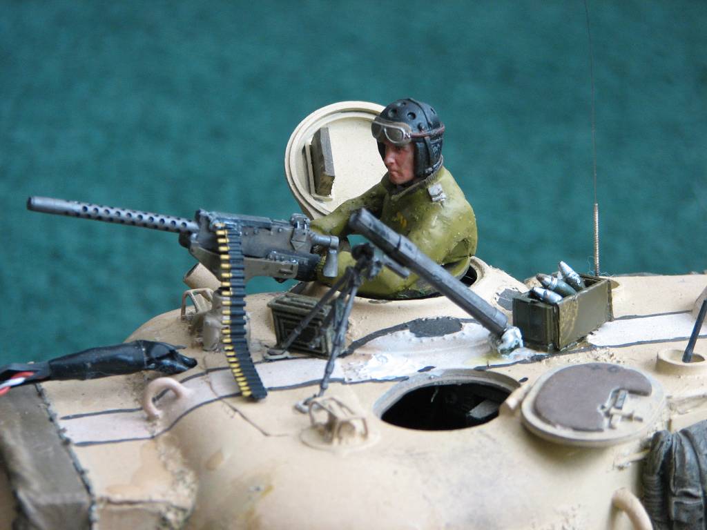

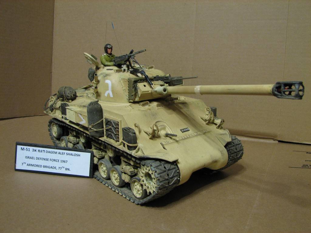

Here's both of my M-51s to show diff. That rear projection is a lot of work, regardless of using a block of resin or sheet styrene but the MB isn't really that bad. The M-51 with Gimmel (ג) is a model of one of the last turned in by Gen Kahalani and had the cal 50 on the main gun with a cal 30 and a 60mm mortar on the turret. The weld, wire to IR and MB have been improved since these photos were made. Hardly any two M-50 or M-51s were exactly the same. they were modified with available parts as they came in, using materials fro many different tanks. Early ones had spare tracks on the sponsons near the driver, but later had them on the turret...not both places and there were variations on many of the sponson stowage boxes with a few having the bin on the rear.. Hope this helps, good luck.

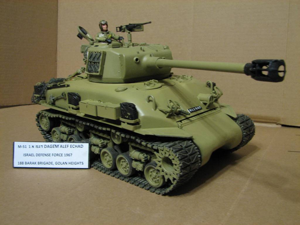

Andrew, considering the work envolved, you may want to order the Tammy M-51 turret. It looks good, it's just many things on the chassis that Tamiya screwed up. Here are some views from two M-51 models, one A1 and one A3 chassis.
The one in darker French OD (א= Alef) is an older Tammy bottom with MATO upper. The two chassis match up easy. Both are great looking tanks to model. Good luck. Bill
