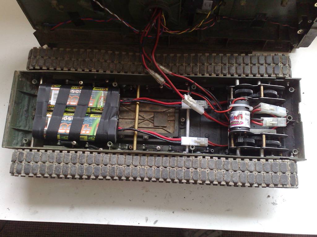

I'm now using a combination of steel and plastic gears on mine (right drive train). The 480 motors tore the 2nd gear and final drive on separate occasions even with 8 mm bearings on both shafts. This occured twice on my right drivetrain assembly, and I reckoned, replacing with steel gbox would still be problematic. It seems the steel gears are prone to shimming, even with DBC momentum enabled. My set up now includes 1st, 3rd and final gears plastic, and steel 2nd gear. Sorry am in my office, will post pics soon.

Default RE: Gearbox advice needed
Thanks Smokin',
The composite gbox seems to hold 10kg+ running tank well in concrete, sand or grass...see pic below. The plastic and metal are alternately placed while the shaft holders are mostly plastic.
Been having problems attaching pics here though...
