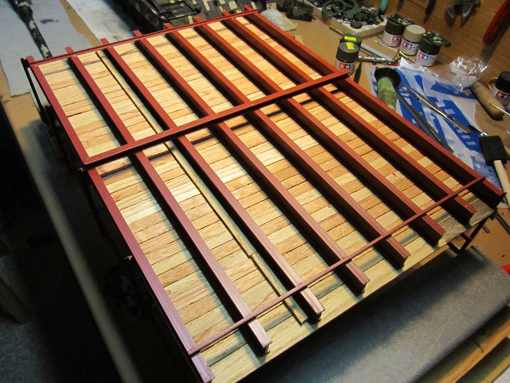

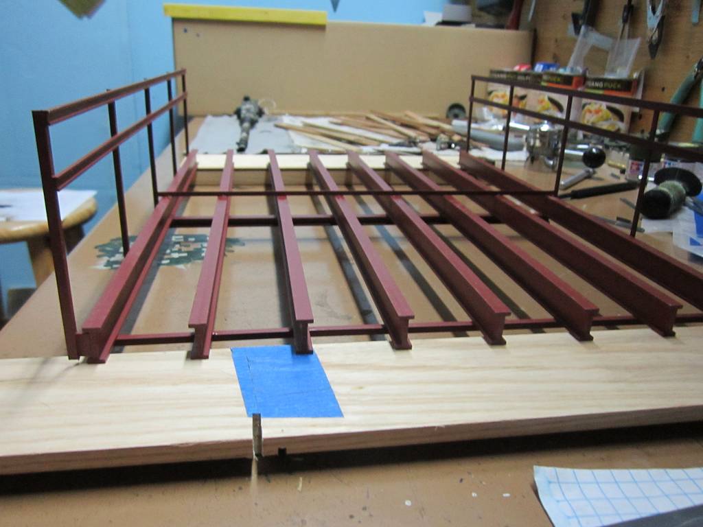

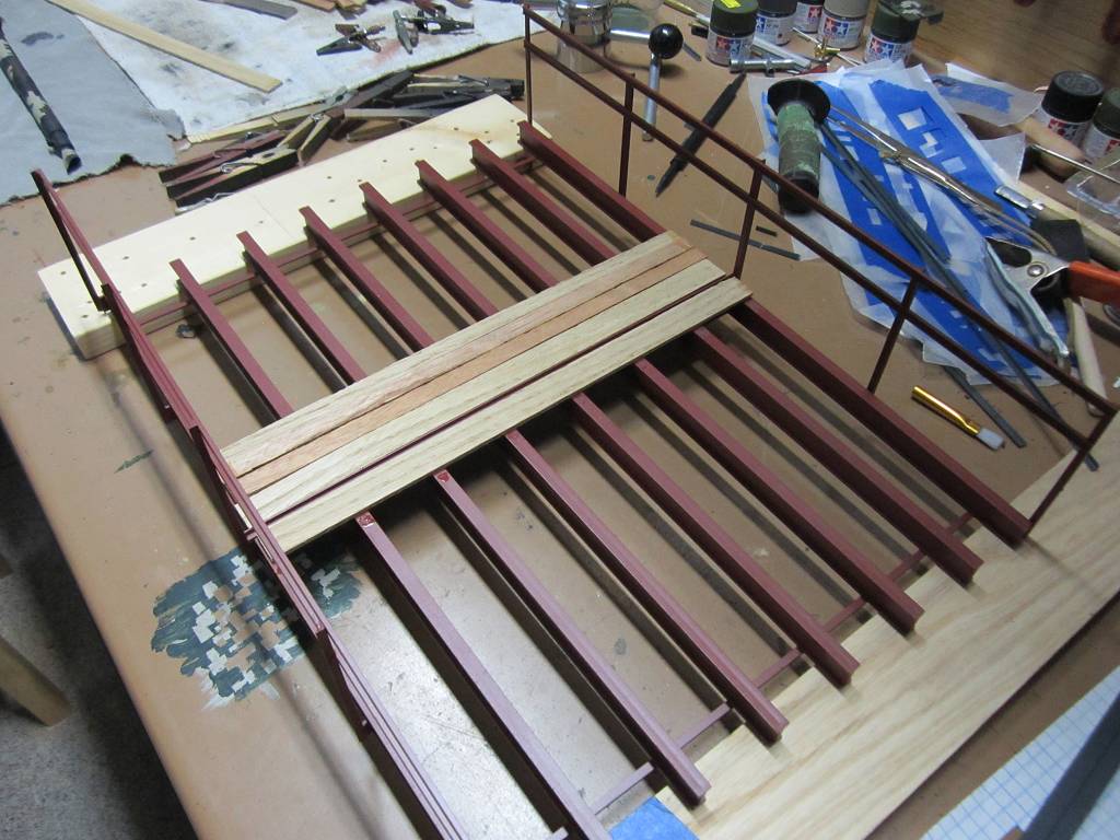

<div><div><div>I used ABS plumbers glue to assemble the structural frame from ABS I beams.</div></div></div><div>
<div><div>The I beams are 2 scale feet on center. The plans show a wood deck so I used Oak and Mahogany planks I ripped down from scrap wood. Mixing the wood types was necessary to have enough material to complete the deck. It gives it a &ldquo;repaired&rdquo; look.</div><div>I used a gel type CA glue to attach the wood to the ABS I beam joists.</div></div></div><div></div><div></div>

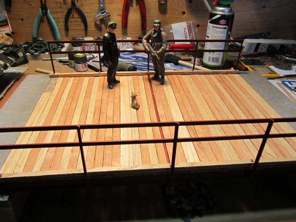

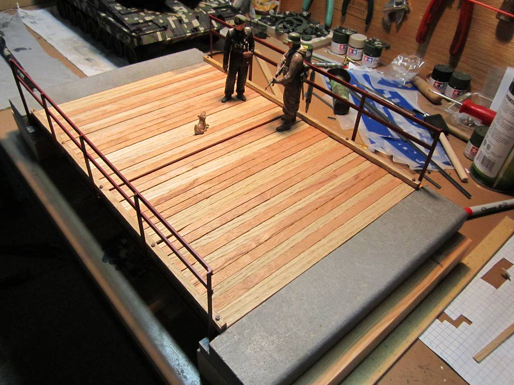

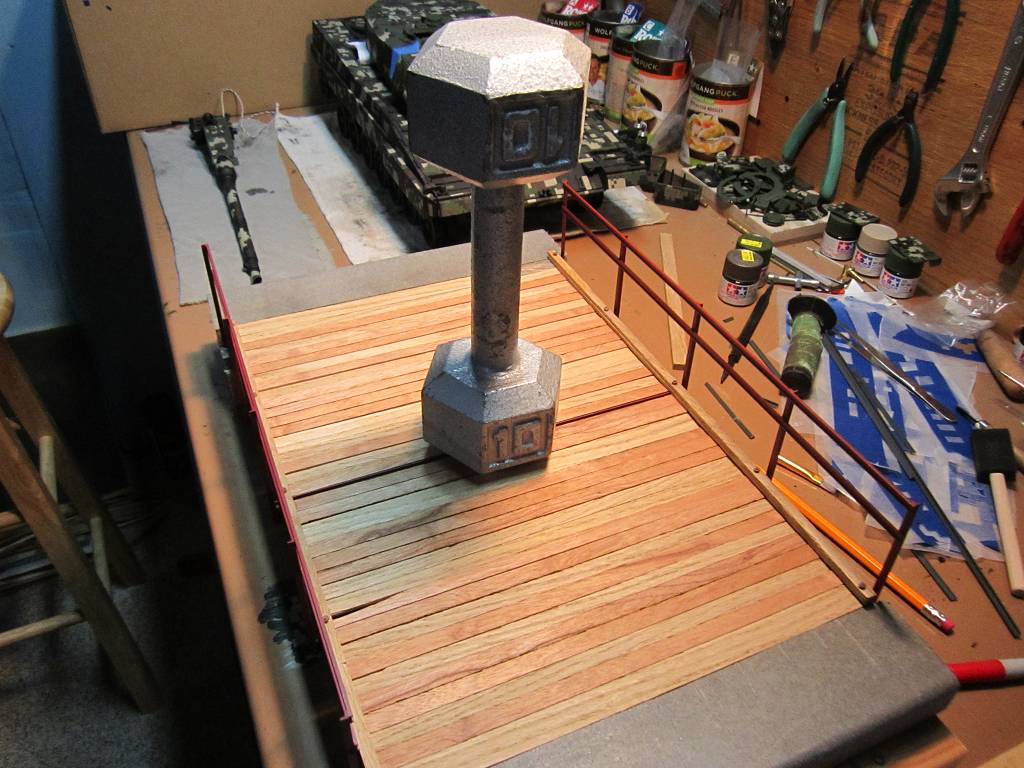

Old 09-10-2011 | 02:53 PM
Pah co chu puk's Avatar
Joined: Apr 2010
Posts: 3,259
Received 152 Likes on 98 Posts
From: Ridgway, CO
Default RE: simple tank bridge

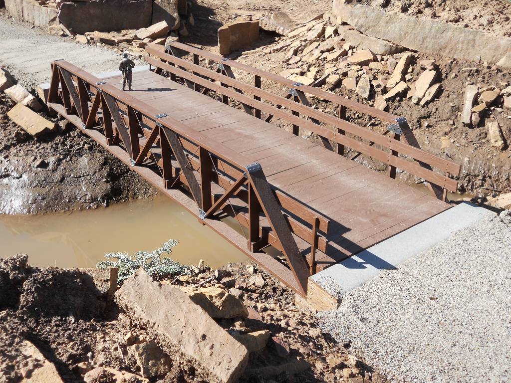

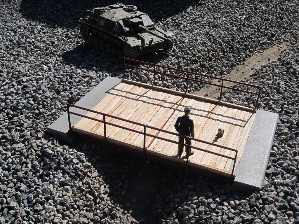

The finished bridge&hellip;<div></div><div>I cut bridge foundations from some left over &ldquo;Trex&rdquo; plastic decking. It looks kinda like concrete.</div><div></div>

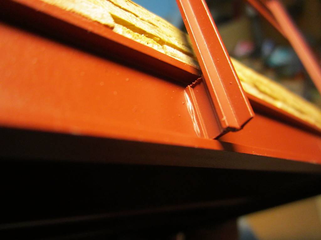

Old 09-10-2011 | 02:58 PM
Joined: Apr 2010
Posts: 3,259
From: Ridgway, CO

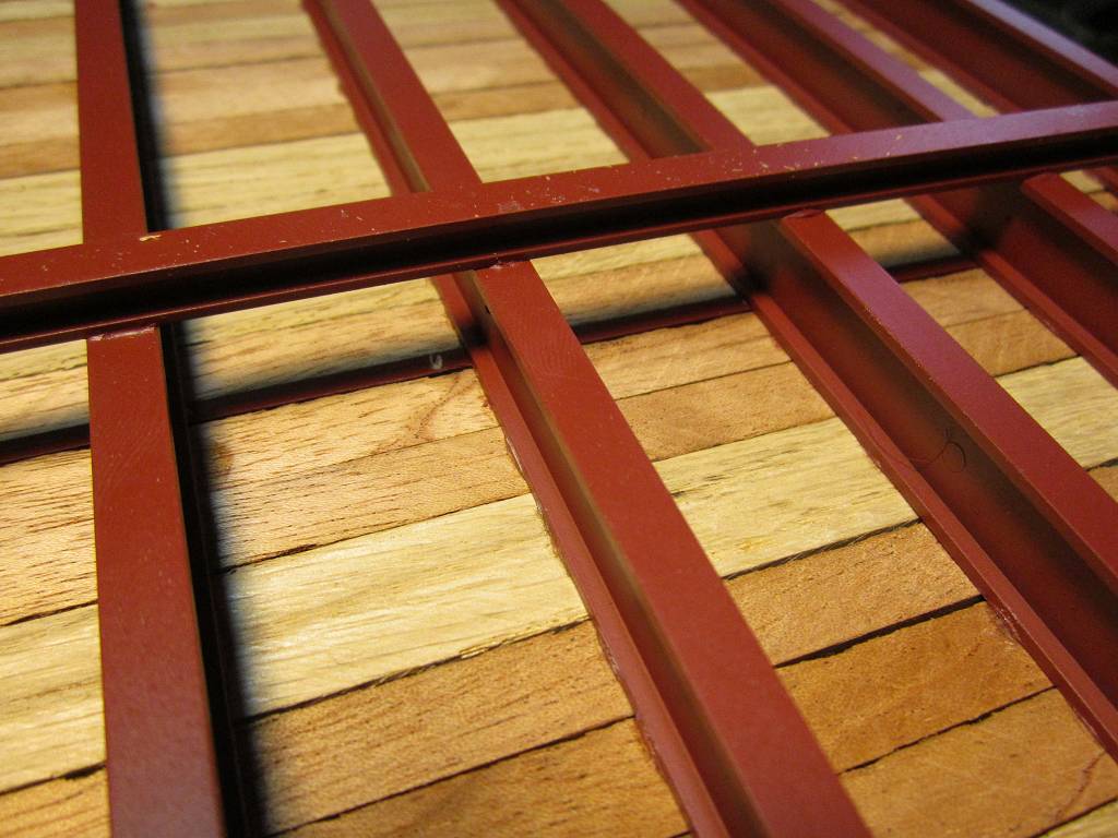

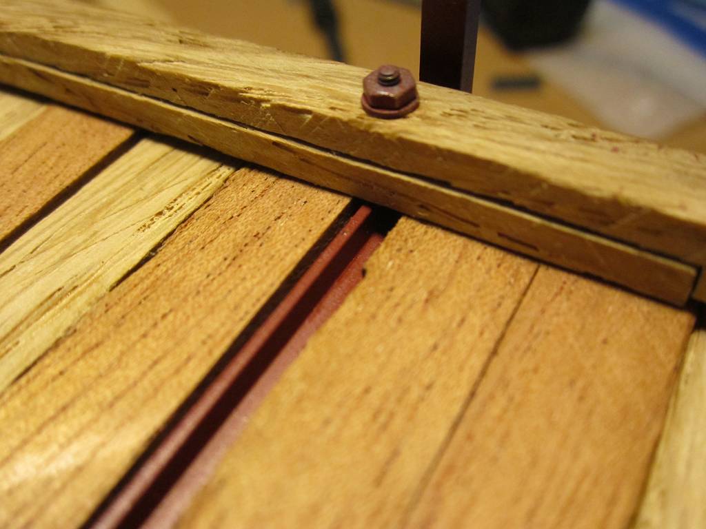

Some detail shots&hellip;<div></div><div></div><div>The ABS comes in grey, I painted it with a red primer to give it the red iron look.</div><div></div><div></div><div>The underside&hellip;</div><div></div>

Load testing&hellip;
Data:Live loads-
Uniform = .2 lbs / sq. inch
Concentrated = 3 lbs / sq. inch
Measured deflection at max. load 1/16 inch at center of span.

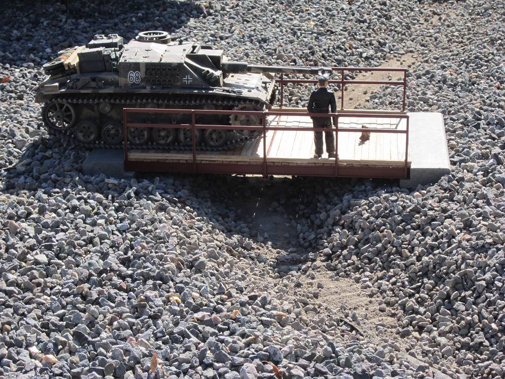

Setup outside for pictures&hellip;<div></div><div></div><div>I plan to do one more like this but with a solid ABS deck with side pans so the road base, dirt, sand, etc&hellip; can be graded across the bridge. This will eliminate the wood making the bridge weather resistant. I can also do a concrete roadway if I want to.</div><div></div>

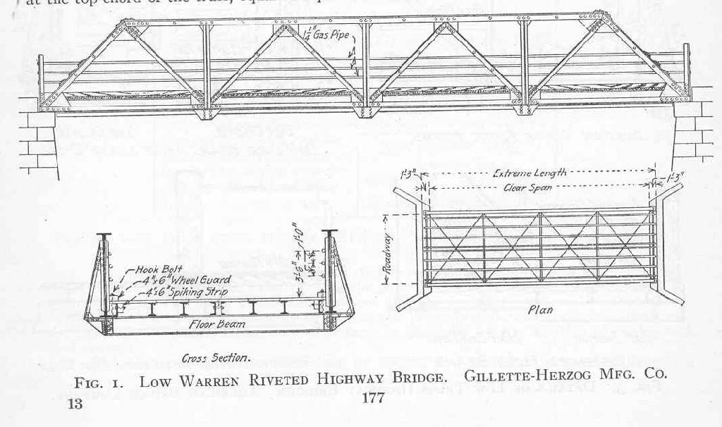

Old 09-10-2011 | 03:08 PM
Joined: Apr 2010
Posts: 3,259
From: Ridgway, CO
<div>After that I plan to tackle this one in ABS in 1 /16 scale&hellip;</div><div></div><div>It will have a concrete roadway.</div><div></div><div>All this just to play with my tanks.
I found these plans here...</div><div></div>
http://www.arkansashighways.com/hist...dge_plans.aspx<br type="_moz" />

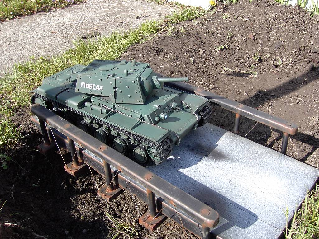

my bridge is not as nice as yours it can hold a lot of weight the base is is a 2''x12''...lol
it's 27'' long and 11.25'' wide had to make it wide enough to get a Pershing acrossed it, just made from wood that i had around the garage and picture hanging wire for the cables
