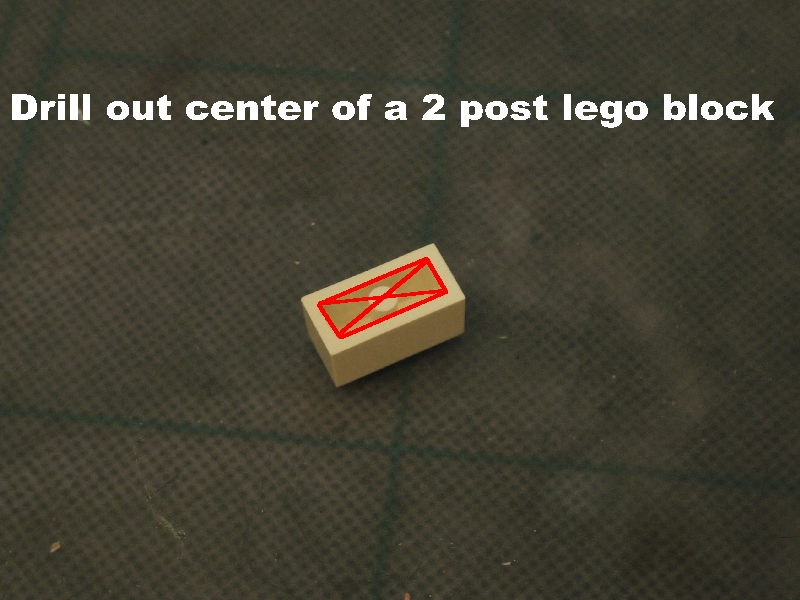

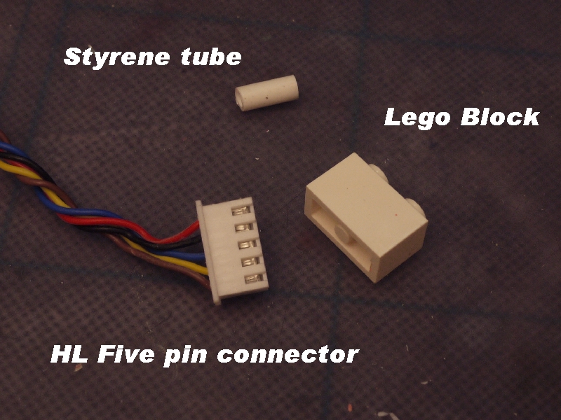

Being that I have multiple tanks that do not have a Tamiya battle system, I devised away to make a socket that would allow a Tamiya TBU to plug into my DBC's.
Good old lego to the rescue again. Gather up these components
Drill out the center of a 2 post lego block and file away the material to make a nice clean rectangle.
Remove the plastic edge around an HL five pin socket.
Insert the socket into the lego
Cut a styrene tube in half lengthwise
Mark the positive and glue the tube as shown to align the TBU correctly.
The TBU will plug into this nicely.
Simple and very inexpensive solution for making TBU mounts.
