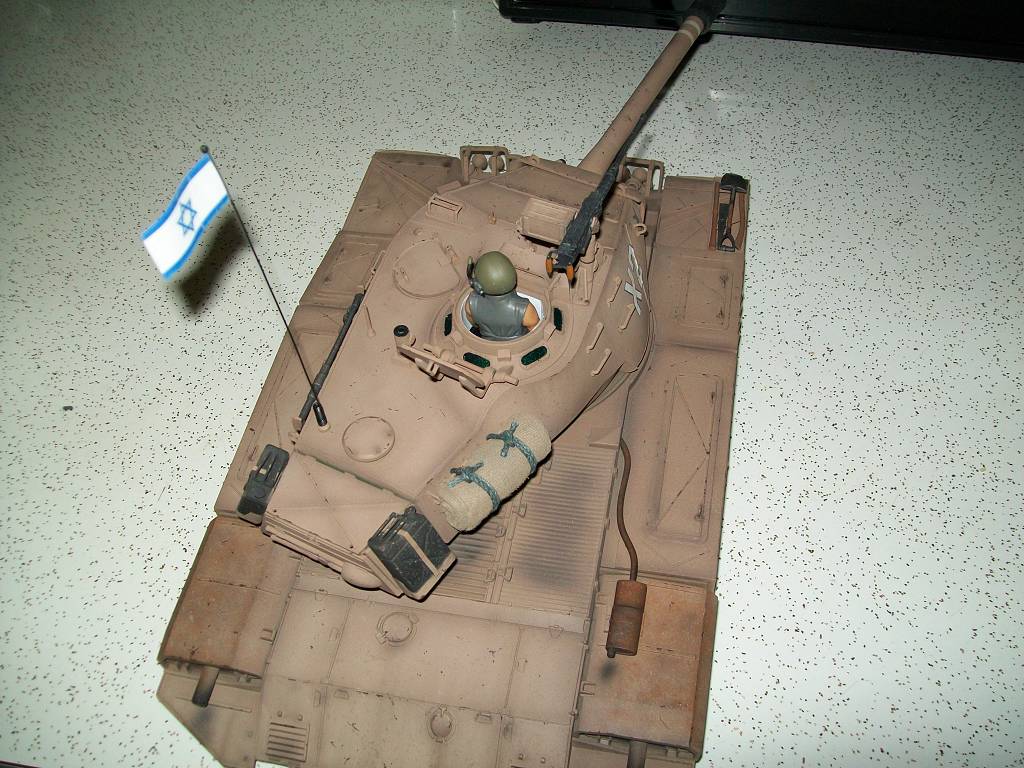

Default RE: HL antenna
I cut mine in half, maybe a tad more and although it did shorten my range a bit I can still get a good 40-50ft away with no problems what so ever...Only thing you'll need to do is put some heat shrink at the bottom inch or so to help keep it from going "boooooiiiing" when the tank is moving around. Ijust did it and it works the treat!

Also forgot to mention that you need to put a drop of thick CA on the end so you don't poke your eye out!....
