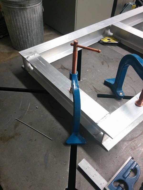

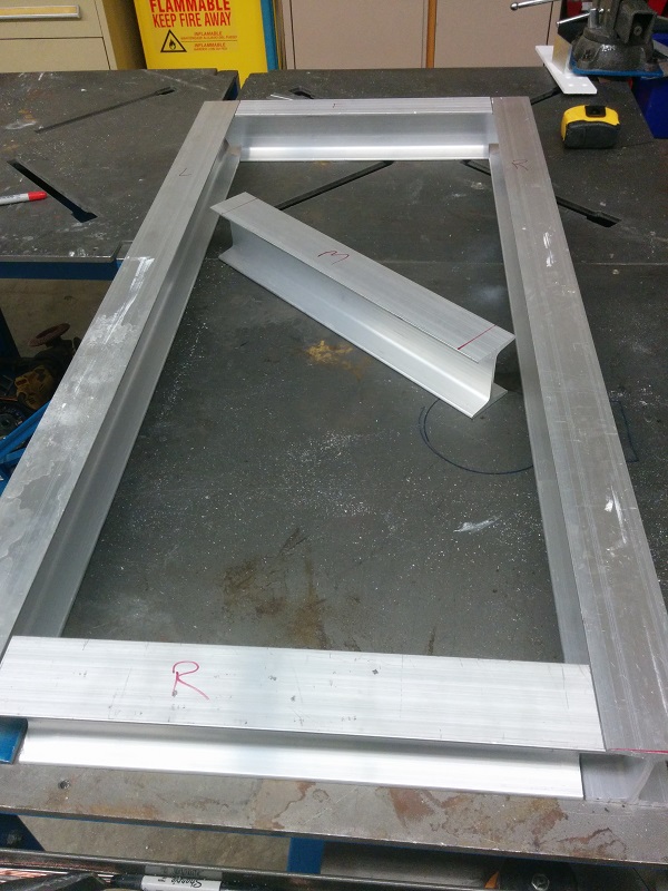

Well I have been gone for a bit. Had a deployment to Afghanistan to deal with so I was not able to work on the tank at all for a year. I had to scale the tank to 1/12th scale as the 1/6 was way too big for me to house and move around. I began welding the internal structure together today. The overall size of the tank will be 42' x 26" in size. I will post a picture of the first parts when I get home.

Ahhhhhh too bad you didn't go 1/10! I would have loved to begged borrowed or stolen a set of drawings in 1/10 scale...

My cad drawings should scale fine.
