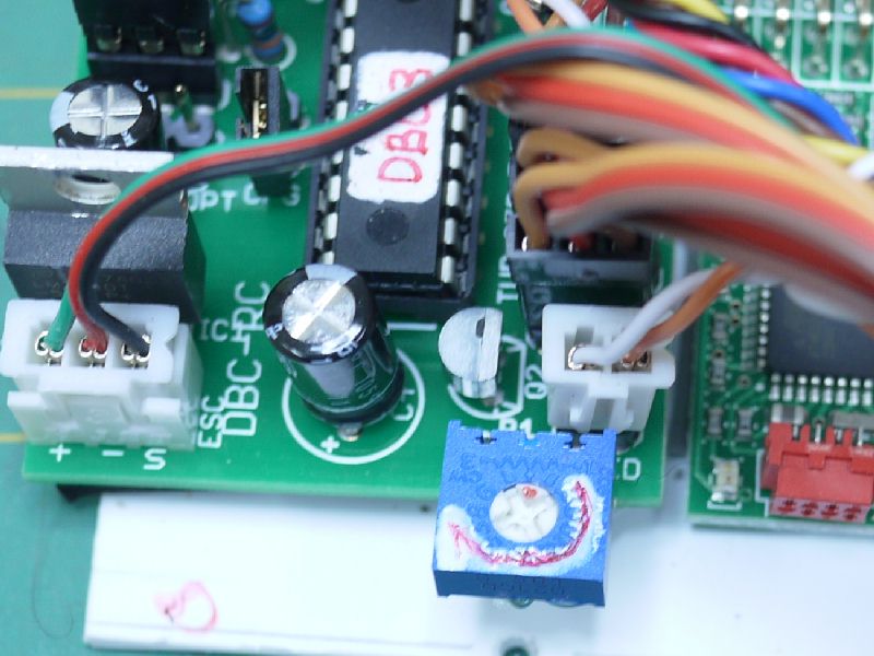

As many of you know I have been playing around with different resistors to adjust the range on an IR cannon. This weekend I added a 500 ohm trim pot to a DBC and did some testing in the back yard.
With this set up I was able to dial in a range of anywhere between 28 meters and 0 meters. The DBC has a place to use a resistor or a bridge wire. All I did was install the trim pot at that point on the board. However any IR system could have this trim pot soldered in line between the IR LED and the board connection. So this is quite possible to add to a Tamiya system as well. Not sure how many people are interested but you could set up effective ranges on your IR shot.
i.e. if 30 meters is the maximum distance available with this IR technology, then this range would be reserved for 88's. If an actual Sherman 75mm had a kill range of 30% of an 88 then for our IR battles you could calculate this distance 30 metres X 30 % = 9 metres. you can then use this trimpot and dial in the range to 9 metres. A sherman tank would then have to close to with in 9 meters of a German heavy to inflict any damage. If you upgunned to a 76 mm Firefly which had an an effective kill range of 75% of an 88, you could then set you range to be 75% of the 88, which would calculate to 22.5 meters for our IR battles.
I would suggest this is another way to play the game. Have all tanks set for 5 hits, and have the gun range decide the class.
This would also work with the HL battle system. On this system there is no way to differentiate between weight classes, but if you added this trim pot inline with the HL IR LED you could adjust it's range as well, and use this to differentiate the weight classes.

This sounds like a great idea, and fairly sImple to integrate. I had thought of something similar involving altering the sensitivity of the individual sensors to simulate different armour thicknesses. Unfortunately would probably need a new apple design, and policing could be difficult.
I agree. As long as the Tamiya apple is the standard, it would be hard to implement. If a 4 sensor system like the DBU or El Mod, then the skies the limit on.

There is a trade off though. In our thirst for realsim we have to realize that the more complex the system, the harder it is to police and set up at a meet. I believe the simplicity of the Tamiya system is why people don't want much more. If each tanker has to spend 1 hour to have his tank "verified" the time on the field is diminshed, and for some it is just not worth the effort. This little mod though is easy to do and a range test wouldn't be much more then what is required now. A marked range on the floor is all that would be required.

A chrome dome in place of the pyramid could fix that in a hurry. THe ones I built in my shop were not of good enough quality to keep the range that the Tamiya work under. It did prove that the dome would work though, and get rid of that 45 degree "defense"
If Tamiya started stamping out domes as well as pyramids we could have more options

To your point Dan, on the dome findings, I did a few tests using studs or spikes for collars or armbands and such with similar results as you had.
I concluded the surface area of reflection is too low for good detection in a conical design as oppossed to Tamiya's flat plane design that has more surface area to reflect.
I'm begining to believe Tamiya really did think this through for the simplest design of the TBS.

As for limiting IR range, has anyone ideas on a simple material insert in the IR tube that would simulate range?
By that I mean, a heavy for instance could have no insert, a medium have some translucent insert in the IR tube and a light have another type of translucent insert.
The insert could be labeled 'light' or 'medium' and be in the toolbox easily installed or extracted without any electronic modification.

IR is better as it gets filtered. The more you cut out visible light, the more effective the IR is. Tamiyas filter is completely opaque. I've tested different scrim sheets, eliminating visible light in the spectrum and it only increases the range.
The wildest thing I came across is it works through PVC pipe. I mean eighth of an inch thick solid white plumbing PVC. I thought I was shielding the sensors with it when testing but I kept getting hits. Finally, I sealed one completely in a one inch pipe and it took hits from 15 feet away.

</div><div>So we now have two ways to change the IR range of our tanks.</div><div>
</div><div>1   YHR's idea, put an inline device that changes the IR LED output.  Make it with digital settings and you could have standard play at any club.</div><div>
</div><div>2   ausf has found that shielding the IR detector with various materials will change the range of detection.  A set of standardized caps for the apple  would allow standard play at any club. </div><div>
</div><div>By combining three settings of each method we would have, 27 settings to choose from.  I think my math is correct.</div><div>
</div><div>That's enough to assign every tank type we use it's own setting...</div><div>
</div><div>I think I could have caps made with plastic that has carbon in it.  By altering the carbon content we could shield the IR to any degree we want.</div><div>
</div><div>If I made three "models" for light , medium, heavy, would clubs accept it?</div><div>

Actually, what I've found was it only increases the sensors ability to detect (doesn't increase range beyond the maximum, just gets rid of interference). It's very hard to effectively decrease an existing sensor with filters. The only real way is with truly opaque material, metal, solid paint coats, etc. That's hard to get consistent.
If you've ever looked through a Tamiya IR filter, you can't. It's solid bluish plastic that eliminates visible light in the spectrum, but allows red above what I would guess around 900 nm or so. They also have a 'collecting' lens on the same material right before the sensor which I assume helps with range. HL's apple uses an amber filter more akin to sunglasses, you can see through it. Their sensor had no collecting lens before it and isn't as sensitive or the same nm (it's in the 800s) as Tamiya. Plus their pyramid isn't too shiny, but heck, it's only $11, what do we expect.
I would think the only way be either to electronically limit the sensor or program the unit to ignore certain hits when working from the reception end.

It would depend on the mix of the plastic. Looks to me like Plexiglas(TM) cuts the wavelength we use to about 15% transmittance...
