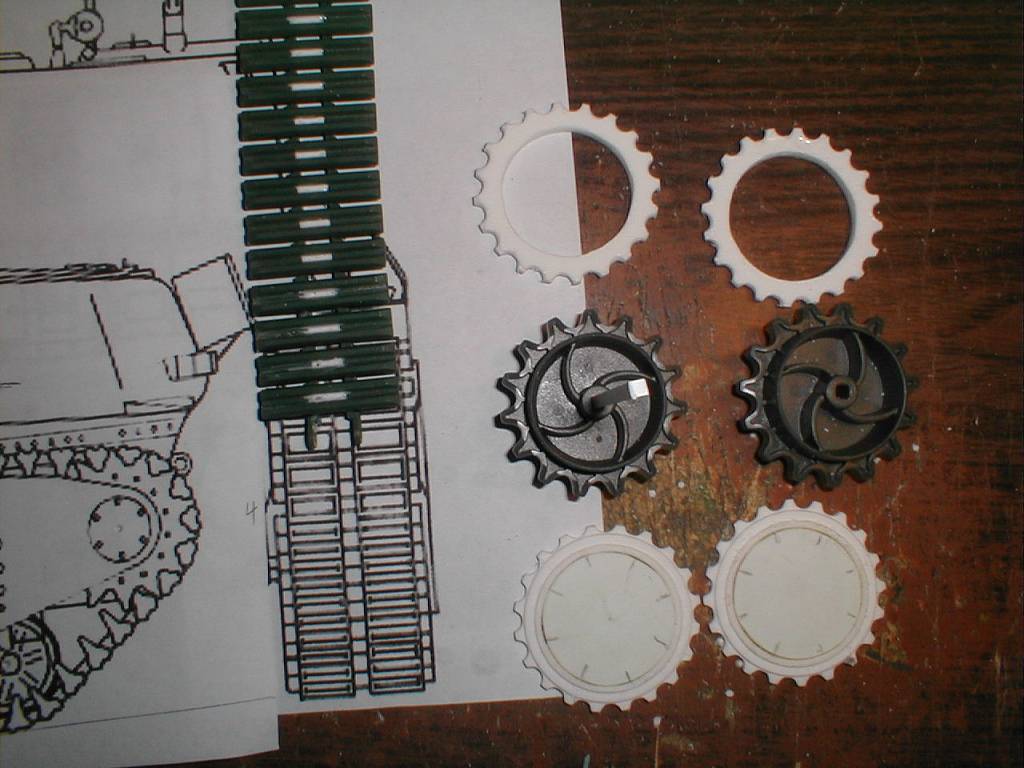

I was lucky to find some track that could be modified to resemble the track on the real 1:1 tank. It wasn't hard to do, it just took time (and patience).

You did a splendid job, correct in every detail I can spot. The tracks were a lucky find, they do indeed match the real ones quite well, and they show that it ismore than just a Sherman with a new upper.
Did you scratch build the sproket or is it a robot one dressed up?<br type="_moz" />

Hunnicutts "Firepower " book had a lot of photos of the T1E2. I was originally going to do the M6, but that copula turret on the main turret of the T1E2 changed my mind. I already had a latex mold for it....it's the same turret that was on the M3 Lee turret. Also, I couldn't resist the AA mg on the rear of the turret. The tracks look better painted. The sprockets are dress ups. The reason each has two dummy sprockets on one side is because I screwed up the spacing putting them on and gluing them with CA.

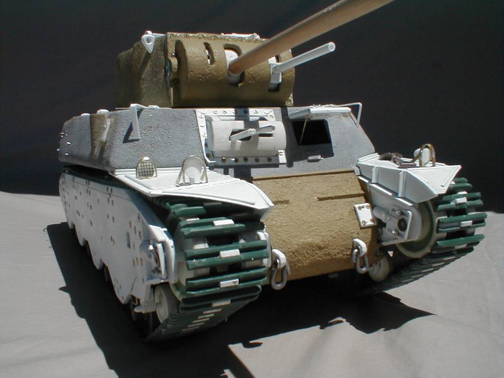

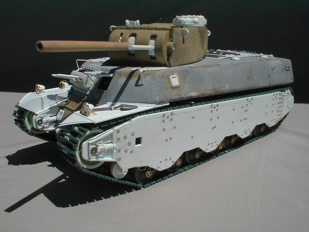

Hey ...... I need some info about the hull and turret texture. Zoom in on those photos and tell me....does it look like a casting finish or not? I tried a new way to try and do a cast hull. I sprayed the hull and turret with rattle can primer and poured sugar all over it. After it dried, I brushed off the loose excess, rubbed it down lightly and sprayed it again to seal it, that It was easier than doing that finish using salt like I did on my T-28.
I think it turned out sweet.......What do you think?
Be honest, don't sugar coat your comments.

Yes, the turret and hull look like they are cast in the picture.
Your method is sweet, it adds some nice eye candy.

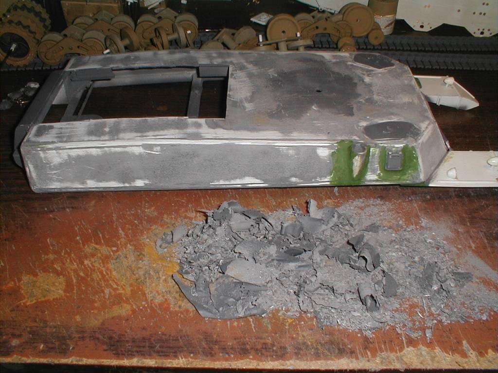

I have never been a perfectionist. "Close enough is good enough" has always been my motto .......... until now.
The finish on the hull that was supposed to replicate a cast texture just wasn't right. As I checked all of the details to make sure this model was ready for painting, I became very unhappy with the way it looked under close inspection. The photos I posted were misleading. I could only come to one conclusion about getting it to look right. Strip it all off and start over. Bad words were said.
The pile you see in front of the hull is the sugar enriched primer paint that peeled off in layers using a razor blade.
My brilliant idea about spray painting it and pouring sugar all over it to get a cast hull finish ..........was a dumb idea. I'm convinced I must have suffered brain damage aa a child. I'm going to do this over 'til I get it right..................

That's a shame you had to go through all this extra work. None-the-less, this project is awesome Rex, can't wait to see it finished!
I have done zero painting, weathering, or texturizing on anyything as far as models, but from what I have read around here &amp; other various forums, many people use something called Mr. Surfacer 500 or Mr Surfacer 1000 to get a desired cast metal look. Is there a reason you didn't try using Mr Surfacer instead of your sugar method?

I agree. Mr. Surfacer is great. I also use liquid cement, like Testors, and a tooth brush to get the same affect. Here is site someone posted that shows both methods to get the cast look. Like I said I have used both to get the look I want.

I wasn't aware of Mr Surfacer, but I definitely am going to try it, and texture paint as well. There's a lot of stuff I don't know about. I suffer from old guy tunnel vision.....Heck, the way I did things was good enough 50 years ago....why should I try any new fangled gizmos? The sugar thing was an experiment and it did work pretty good with petroleum based primer paint. But there were some spots that need touching up and I used acylic paint (and sugar) for fixing up some areas. Primer worked for a base and for sealing the sugar, but water based paint just disolved the sugar and left a tacky/sticky surface that didn't dry. Duh. I tried to wash it off, but realized I was making a bad situation worse. Ya live and ya learn.
Thanks to all for your willingness to share information about a "better way". It's a fact that I have learned a lot from the people on this forum.
