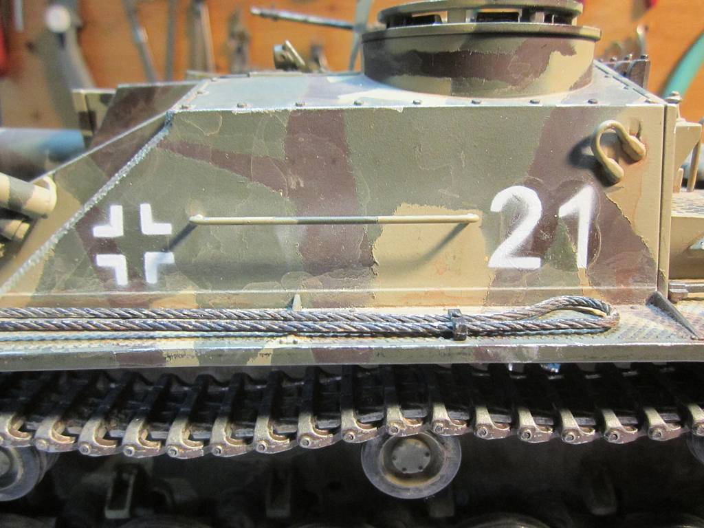

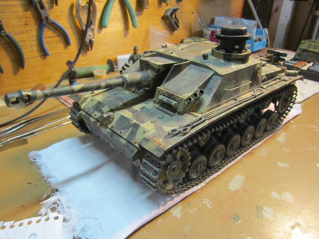

I am re building my Stug into a Tamiya compatible fighter. It has donated it&rsquo;s RX-18 board to the Panther so it was a simple matter to remove all the rest of the HL stuff. Now all that remains is the HL speaker and the 3:1 gear set. I will also reuse the HL speaker volume dial and the smoker on/off switch. I don&rsquo;t like smokers so the switch will be used instead to control the headlight. I plan to install a new RX-18 board and a DBC/DBU2 to control everything and a new cast metal headlight. I am installing the IR LED in the gun tube right behind the flash LED sort of like the rounds in a tube feed .22 magazine. I have not yet ordered the electronics, still saving up the money, but I have started prepping the space. <div></div><div>After battling with the Panther over at the FRAG field I decided to make my next battle tank a small one. The village there is very tight for big tanks,(read get stuck easy) so a smaller, more maneuverable tank is just the ticket. I have driven the Stug over all kinds of terrain in all kinds of weather so I think it will be a good battler. I have also developed some camo nets to help it hide better. I plan to use it in it&rsquo;s traditional role as a tank killer from ambush positions. </div><div></div><div>If I rig some camo nets and put out some figures next to the stug ambush position it will be lost in all the FRAG props and just look like the scenery. I sneak into position, then WHAM! you take a shot and don&rsquo;t know where it came from&hellip; </div><div></div><div>That&rsquo;s the plan anyway.</div><div></div>

Today I painted the numbers and the crosses on the Stug. It had HL decals and they looked bad so I removed them. It was the last tank I put decals on, all the newer tanks have painted numbers and insignia, so it was nice to have it done. I also painted the Commander&rsquo;s periscopes gloss black to look like glass. They were just camo before. I still have the headlight to install but it is painted now too. I put a tiny piece of clear plastic inside the headlight to defuse the LED somewhat and reflect outside light like a real headlight. The dark cavity with a LED showing bothered me. This rebuild is more than just about battle capability, it is a general upgrade in looks and performance too.<div></div><div>This brings me to a question&hellip; Where should I mount the HL machine gun LED?</div><div></div><div>I doubt the driver fired from his periscope, I think that is a HL invention and not historically accurate. I plan to leave it for now but my mind is looking into where to remount it later. </div><div></div><div>I have another tank with a DBC/DBU2 so I used it&rsquo;s apple to plan the mount for the Stug. I have removed the upper part of the commanders&rsquo; hatch because it interfered with the apple and it looks like it will mount nicely this way. I can still replace the hatch assembly anytime so no looks are compromised. It ends up with the IR receiver only 6 inches from the ground, almost 2 inches less than the Panther, so this will be a low down sneaky AFV.</div><div></div>
