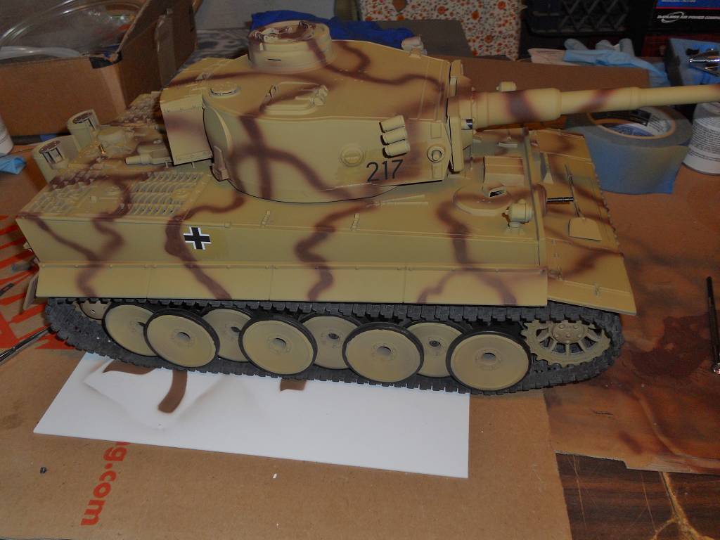

Hi All, What would cause my Tiger to suddenly start pulling to the right? I just finished painting (my first attempt at painting and decals) Got it all back together and it pulls to the right while moving. I have it trimmed properly as far as I can tell, I counted the treads and both sides has the same amount. Any ideas?

Scott, I fully intend to be there Sunday. Can't wait. I set the trim under the toggle, it still seems to pull to the right, I'm constantly correctly to the left.
Looking forward to meeting you all Sunday, has the location been determined yet?
This is my first attempt at painting and all, I haven't touched a model in over 40 years.

Looks great...another option is you have more links in the tracks on one side than the other...I would pull the tracks and count them, then roll all the wheels and see if any are binding....
