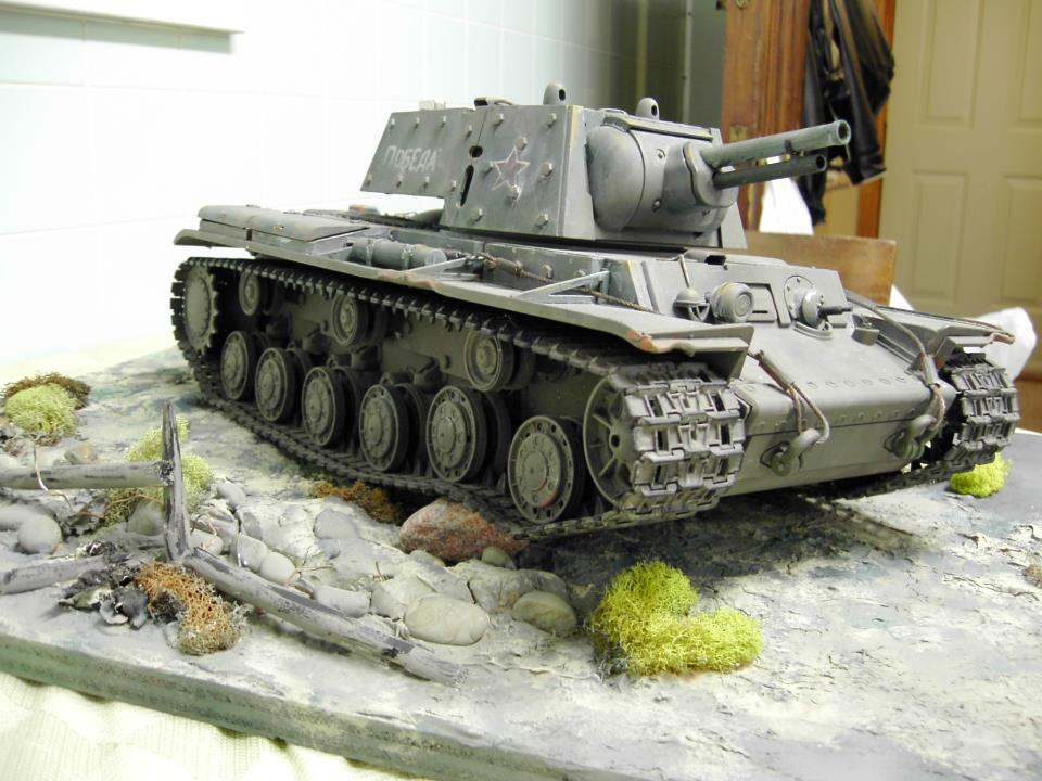

i actually took one of those tiny flathead screwdrivers heated it up and melted a new hole i didn't have a small enough drill bit at the time ...lol
it was the only thing i had to do to my KV-1 from Matomart
