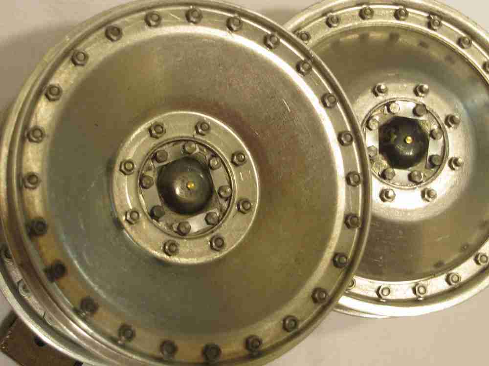

Anyway I wanted to show some of the work I've done, albeit at a lame snail's pace to a set of 1/10 scale Panther ( actually for a JagdPanther)
wheels. The basic wheel is a Maier aluminum wheel set to which I've added at custom end cap and safety clips.
I made the die to press the caps from steel, as well as a second die to punch the holes in the safety clips which are made from
.005" steel shim stock. Each wheel hub was tapped with 8 0-80 threads -quite tedious yet I didn't break a tap once..
The clips are functional.

Great wheels, love the detail.

Beautiful work. The Maier Panthers are becoming a quickly forgotten part of this hobby and it would be great if someone who know's alot more about them than me to do a little thread on their history.
