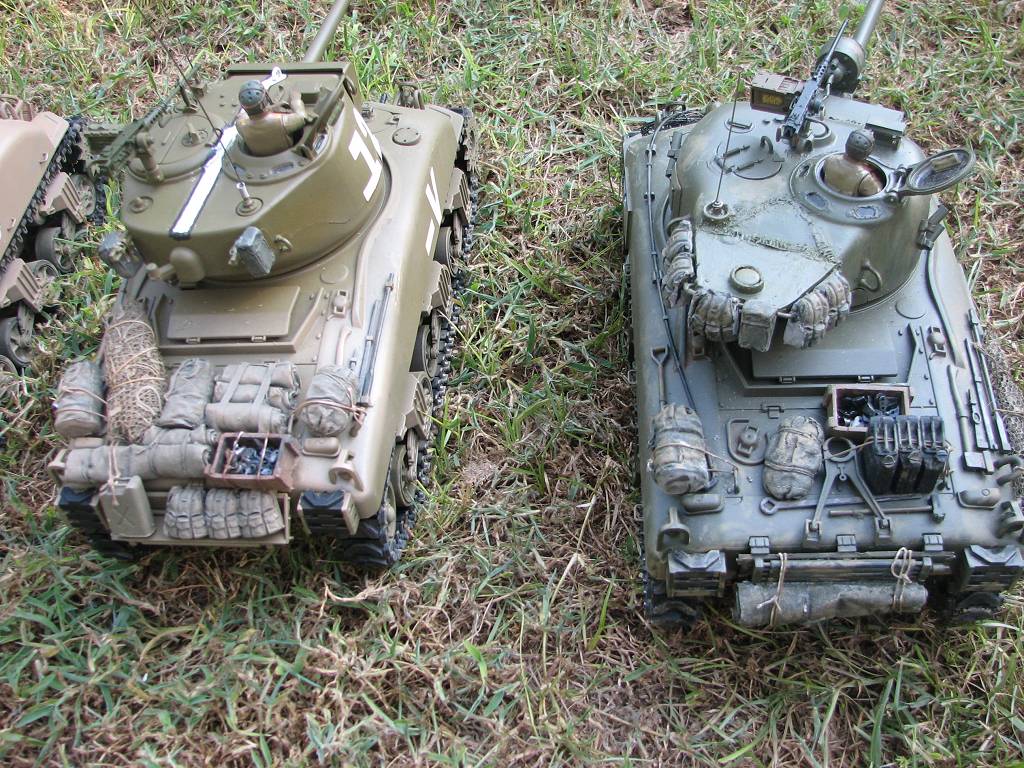

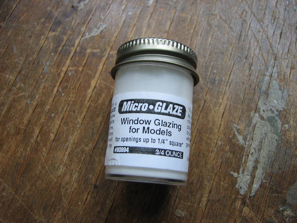

Hi Bill ... most of my work is conversions so use a lot of Evergreen Styrene....sheets, tubes, bars and I beams.. Seems you have a tab on a lot of the normal stuff, like green putty etc. Nick Aguilar ([email protected]) makes resin molds and there are a number of sites in England and Germany who have upper chassis upper and turrets for conversion mods. Build-A-Rama.com has some really nice items for stowage...it's 1;18 but for stowage materials, other than not mixing with 1;16 Jerry Cans, no big deal.(photo 2&4) Micro-Mark.com has great tools designed for modellers and also carries Rust-All for weathering and a neat product called Micro-Glaze to fill replicate glass in commanders episcopes.(photo 1 &3)) You will probably be getting a lot of responses with links to various suppliers. Some some suppliers are geared to specific areas ; ie German Armor etc, so you have to be specific in what you want. If you need figures to augment the tank, Smalljoes.com has many 1;18 scale highly detailed figures in many nationalities which many of us use for tank crews. Lots of guys use metal lower chassis, but I have always stayed with plastic. My models are mainly for display or museum activities and not used for banging around and hard abuse of IR "battling", so plastic does me OK. I have posted a segment on making periscopes on War Room, using plexiglass mirror scraps.
