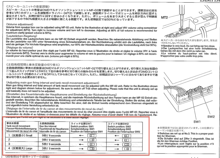

very interesting. WHy there are so many DMD units ? I see some tanks come with dmd3 some with dmd6. I thought that would dictate heavy vs medium.
Is there a chart for how the witches should be for each tank ?

Here are the switch setting for the Sherman DMD-MFU-02
Off the top of my head I don't know if the other tanks use the same settings or not.
Checked the Tiger I, and they have the same diagram
