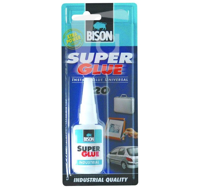

Which one to be used for gluing accessories ? I have been using e6000 but that stays a little think and rubbery

i use bison industrial supergleu
for all my rc tanks and boats too
