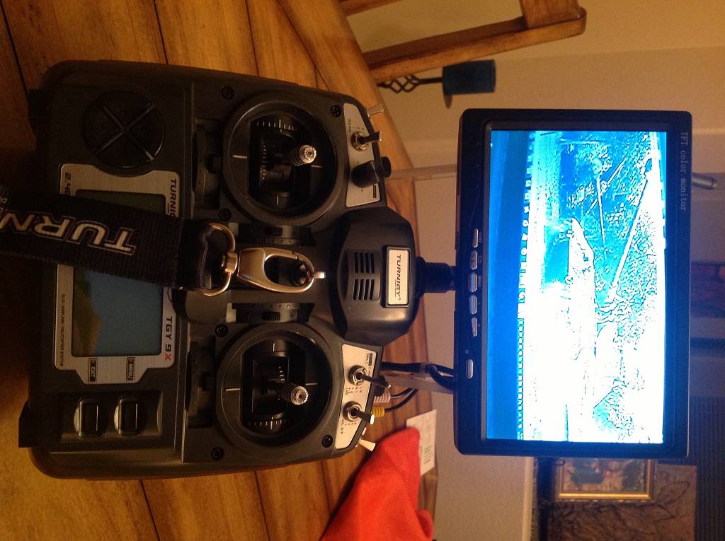

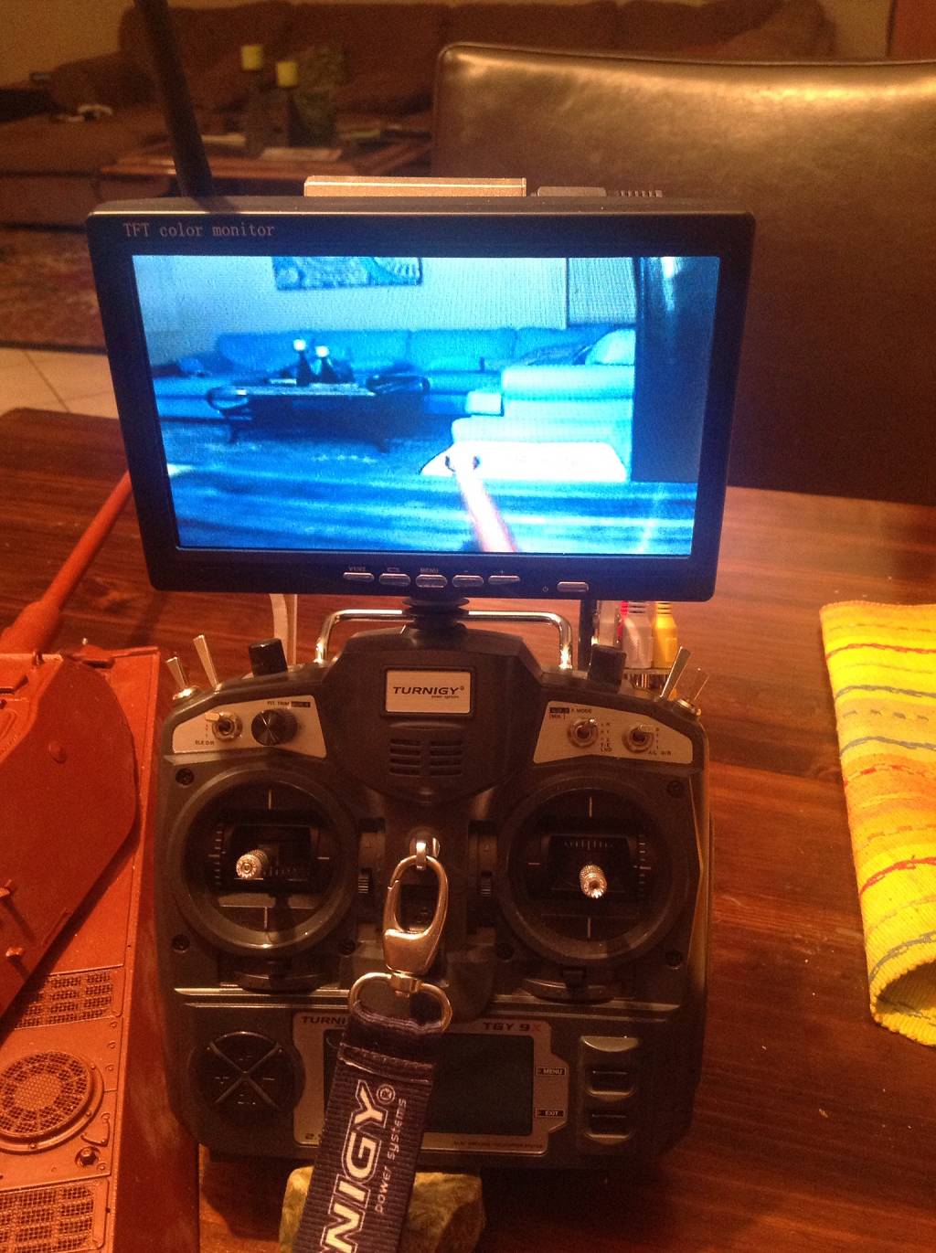

Well, I finally finished the first prototype for my "GunnerView" project (just the viewing system)
And, what the heck is that?
It's pretty simple. Our hobby is based on battling our tanks remotely. That's the "remote control" part (duh).
It's my intent to change that by builidng a simple to use and inexpensive FPV (First Person View) system for RC tanking.
Finally, we will be part of the battle as we will be able to directly view the engage enemy, site the cannon and fire! We will be the commander fighting for the life of our tank and crew.
The key elements are the viewing system (see attached photos), the camera and TX, the IR Apple and the heart of the system; the GunnerView OSD and it's sensors.
Let me break it down:
Viewing System: based on a TFT 8" screen mounted to a 9 channel TX with secondary 11.7 lipo battery system - the viewing system is designed for immediate view (look down and see what is happening) and for complete video immersion by using light blocking googles along with a sound system (now-you can really hear when you throw a tread). The 5.8Ghz RX outputs two video signals along with sound (non-stereo at this time).

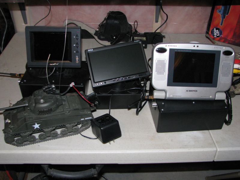

Nice setup. Ihave mounted my video monitors on small palstic boxes in lieu of the radio like you have done. I'll post a picture later today.
The OSD portion sound interesting, Ionly have the camera mounted. More information on this would be great. Also do you find the radio to be heavy after a while with all theat electronics mounted on it?

I'll keep this post active as the GunnerView/IR Apple is completed and tested.
To answer your question, YES - it's definitely requires a neck strap. Although I used 1/4" lexen for the frame, the added weight of the secondary battery and box balanced it, but added too much to the weight. The next prototype, I'll replace the 9X TX battery with a LiPoly (and alarmed regulator) and run the 9X/TX, FPV RX and Monitor with a master plugin and see how that works and how long a 5000 mah will operate.

Here you can see that the video monitors are on top of the black boxes that contain the receiver & wires. I use wallwarts for power, the monitors can be set on a table or flat surface, the black box can be postioned for best reception. Hard to see on the tank but there are two small flags on either side of the front fenders. That's so Ican ell when the turret if facing front.

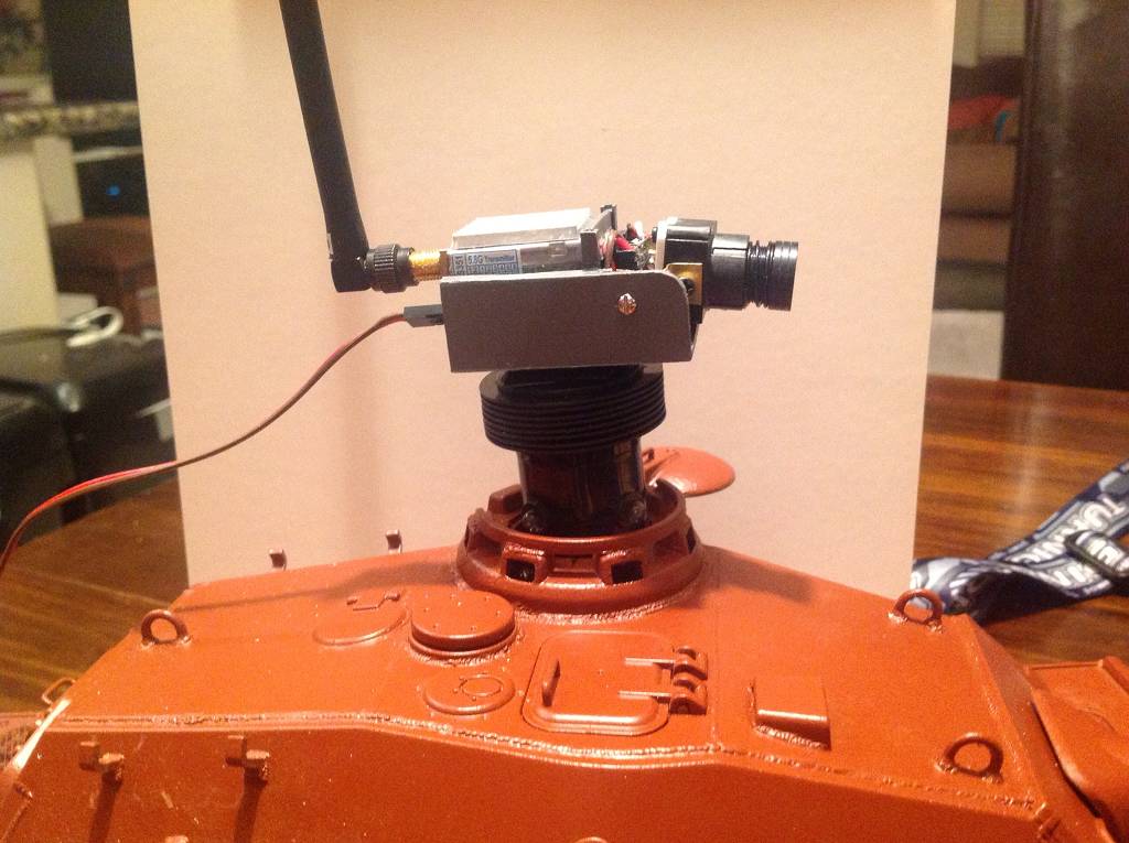

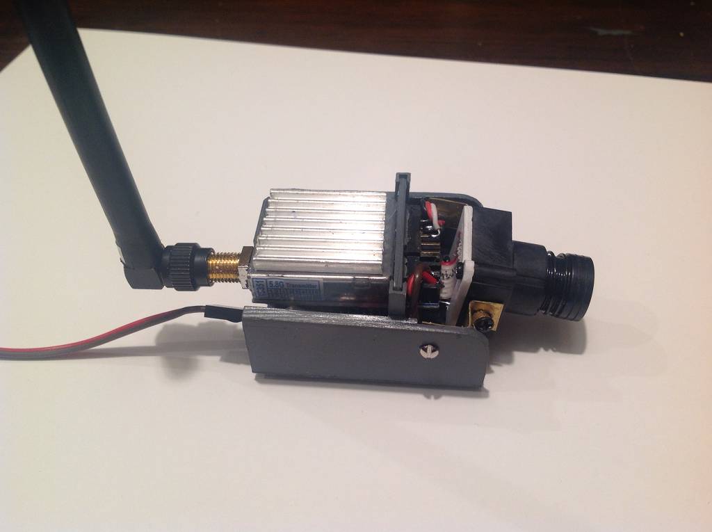

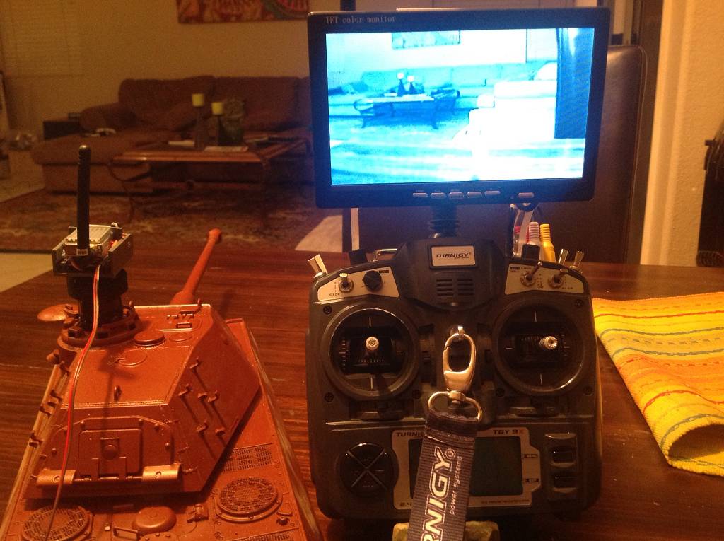

Well, I have finally finished prototyping the camera and video transmitter. It was little more complex than I first thought..
But, here's some pictures of the camera and VTX system.
PLEASE NOTE: the next iteration will be half as large as this system. I'm waiting on parts (slow boat from China).
With the new size, I will be able to mount it on the the IR Apple by using a collar system (not the existing picture! -that was just for testing purposes).
With our next battle at DAK at the end of the month, I should be operational for actually battling the tank using the GunnerView system. The gun reticle will take several more months to develop. It has to have some custom programming on an OSD and a gyro mounted on the Tank Cannon (interior turret) for it to work correctly.
Right now, I'll just place an overlay on the TFT screen for a representation. The actual gunner reticle will be able to move in percentage degrees as you elevate or depress the cannon along with the turret.
