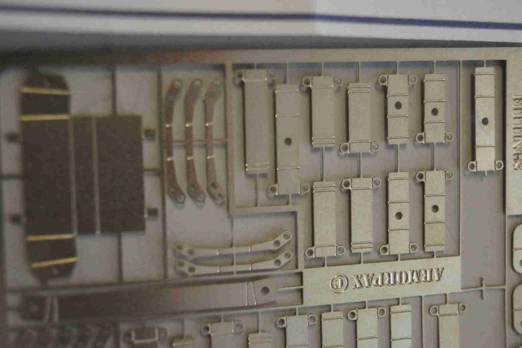

Well not so much prayers as real strong "hope_fers"; as I've been hoping fer someone to make these... Wecohe once did but expensive and very thin.
One of the things that I've allowed to get in the way of the completion for many of my models, in particular the German of which I have a number,
is the lack of certain detail parts. To the point - tool clamps - those ubiquitous darn things that really make a difference in detail.
I looked around for someone willing to make them in 1/10 scale or close to it. Over a year ago Dave over at Amorpax said they'd do it for me. Since I have so many models to apply these
to I could buy many sets they were willing to do it. I will undoubtedly have extra sets which I will use to socialize the availability of these by selling to other 1/10 scale builders
who might want them. Going forward I will more actively sell the sets however I know it isn't a large market. My sets are and will be made in a nickel - silver alloy for strength
and appearance.

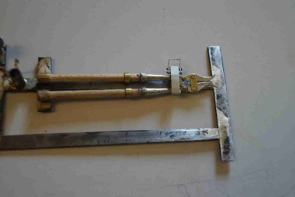

The other thing and again I've come to accept that it is more scale - independent and is "just me ", is my materials/ methods of choice just add extra effort. The tool rack/ frame
I show in the first foto is made from copper-silver-brazed steel, I wanted to be able to solder other components to it, steel is cheap but even still I could not find .050" steel
strips that I needed so I had to cut them using a Beverley B3 shear, anneal then flatten and cut to length. The end result I as I wanted but it takes so long.

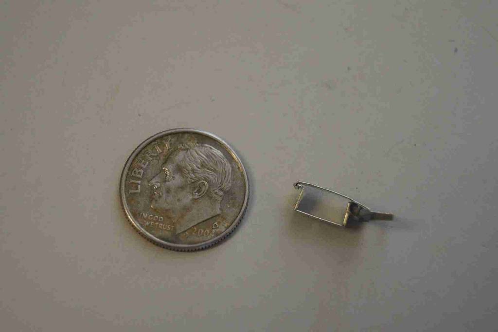

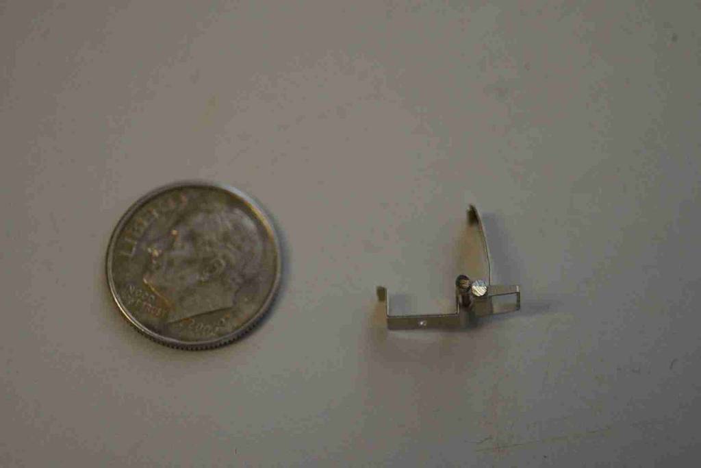

That all said the one clamp I showed was a trial bend; I think I need to make some specialty fixtures to bend these properly and consistently. Then also I need proper pins; I used
some modified steel sewing-like pins I've used for years for all manner of duties. More weeks....

Their focus is 1/6. I essentially 'commissioned' Armorpax to produce this set in 1/10 scale. It wasn't my initial reason but I'll sell sets going forward to other 1/10 modelers if
interest warrants it.
If you have parallel interest in 1/8 scale clamps you might consider a similar arrangement.
